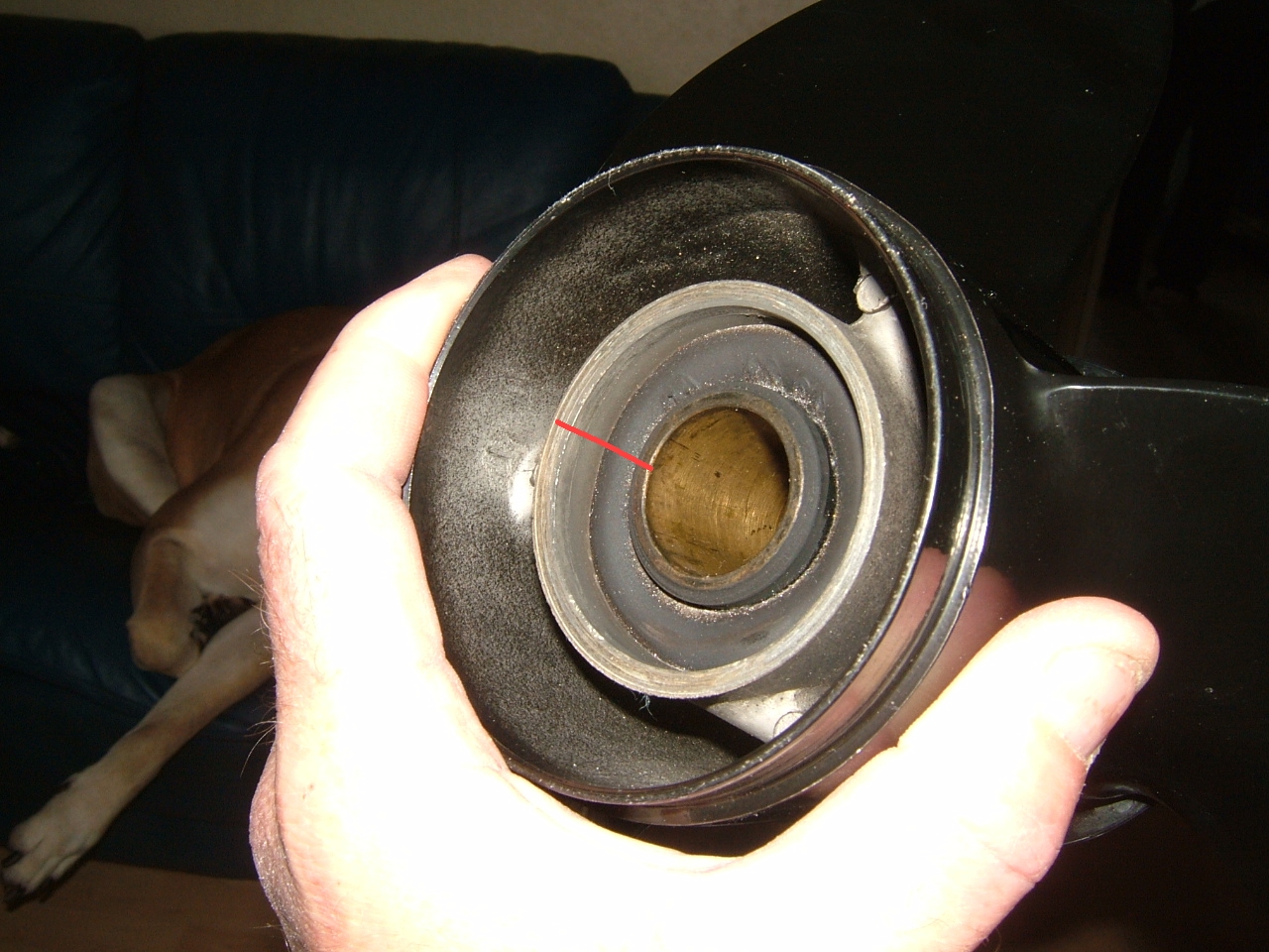

boat is way too big for a 40hp... anyway . just look at the motor when running and see if the cavitation plate is just slightly above the water when full throttle or if its way out of the water.... probably find your motor is too high........... also check your hub is not spinning.. mark the outer hub and the inner hub with a bit of paint of similar. go for a run and then take prop off and re-check...
