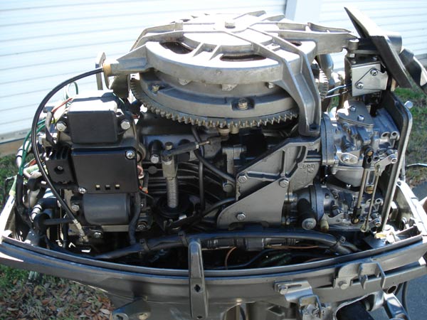

Wrong pic.Follow the white wire to where it is easier accessed.
