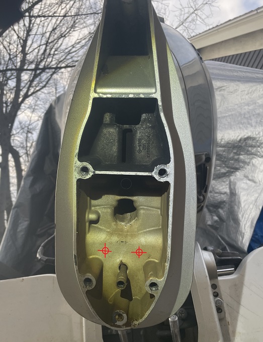

I'm dusting this thread off after all these years to try to consolidate this solution, and get in a question of my own. I have 2001 Honda BF90A that has a big problem with water intrusion into the flywheel cavity. I run in salt water. So my last starter motor lasted 2-3 months before loading up with corrosion and guck. First, the promising solution supplied by iang6766 in 2018:
"I have a permanent fix for this. First, make sure all the moisture is out of the flywheel housing, coat everything a best as possible with some form of corrosion guard. Then ensure your water pump is in good condition. With the lower unit off, drill two 10mm holes into the bottom of the extension housing, either side of the shift shaft directly above where the water pump sits when the lower is back on. This will allow any water leakage from the pump to drain out before it fills the whole extension housing forcing its way past the mount case seals. This method is also a good preventative measure which I have used with great success on all the older BF 75/ 90 motors."
So here are my questions:
1. The attached photo shows my engine with potential hole locations shown in red. Are these locations appropriate?

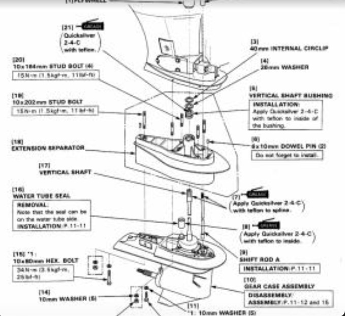

2. How is the water likely getting into the extension cavity (above the separator flange and below the flywheel cavity)? Are the seals in the cooling tube leaking? My tell tale flow seems fine, but I could be losing some flow from the pump and not really noticing it
Thank you in advance. Any other responses or experiences would also be greatly appreciated.
Did you ever do this and was that the right location?
How well did it work out?
Trust me it works, done it to a lot of motors. If your flywheel is badly rusted, then your crank will be too. In that case you will need to remove the powerhead to clean everything propely as well as replace the seals
