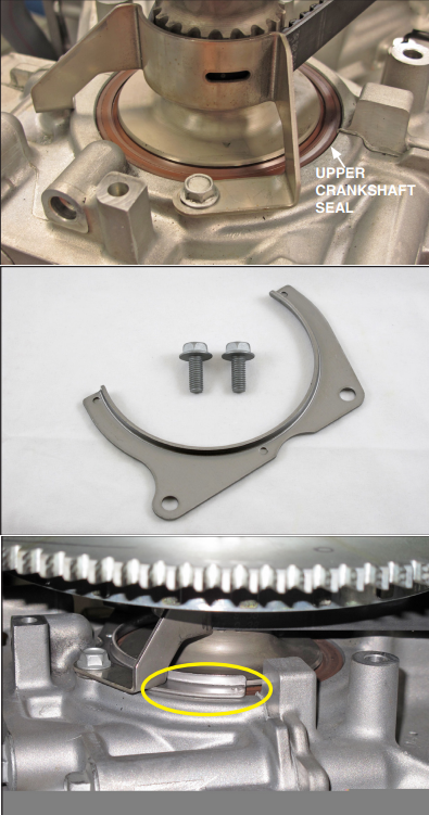

On some Yams they use a retainer to keep the upper oil seal in place.

Is the retainer you mentioned included with the original manufacture of engine or is it an aftermarket piece that can be added?

A retainer plate could be crafted to physically keep the main oil seal from migrating outward. But this would be a bandaid approach if there is an oil pressure or crank case pressure problem.

Once a seal has come loose (assumption being it is the upper crank shaft seal) they may be more prone to failing again. If you don't replace the seal you might want to think about fabricating your own seal retainer of some sort.
Did you make this part or did you buy from somebody? Can you send link

I jest but surely they’ve come up with a solution. Is installing the seal with loctite or a hold down plate an option? I’ve seen lots of complaints but no solutions. (And don’t call me Shirley…)
