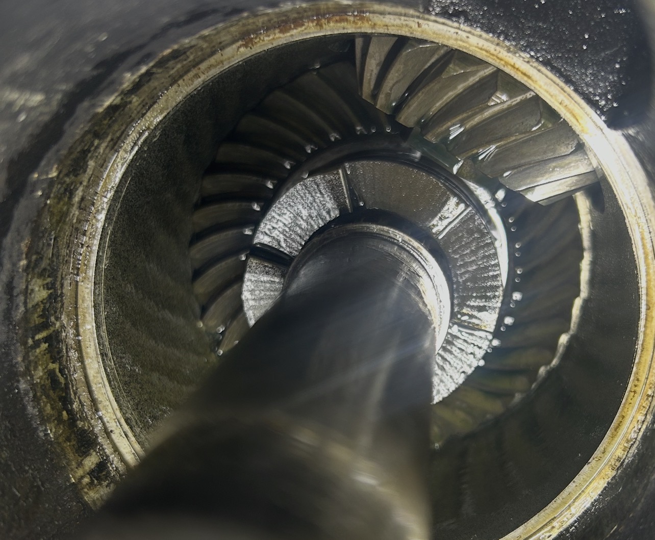

Well, the surface could definitely be cleaner. I’ll pull her back apart and take a better look. I just hit it with scotch brite the picture is what it looked like before cleaning. And good to know I can be a little more aggressive with the sealant if need be.
The weird thing is, how the hell did the drive hold pressure!?

The O-ring distorts and fits into the area as well as it can, but since the back edge isn't smooth, it may hold pressure for awhile, just not for long.
Use denatured Alcohol to remove the sealant, especially if it was Perfect Seal or something like the Permatex mentioned before. Be careful using abrasives in there.
Better to ensure a flat & smooth surface than assume the sealant will create the seal you need.
