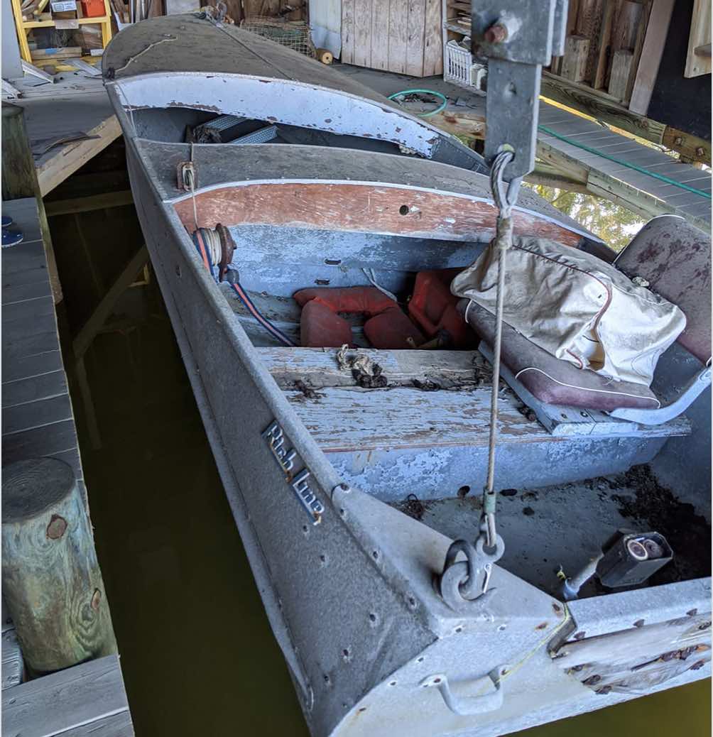

Thanks keep us posted.....so many of us enjoy these old motors.....we grew up with them...love em. How did you set the coils for proper clearance to flywheel?
Wow! Great!.....got a picture of the boat? I have a 57 Johnson Javelin 30 would go nice on there too.
So something just dawned on me. I don't think either of my coils had the boots on them. Are the rubber boots important? If so that could be the problem.
Pictures attached. One is how I found it in the boathouse and the other is after I started cleaning it up. Boat.jpgRich-Line.jpg

Rubber boots should be there, but if wire is in all the way onto pin and all clean, then it's a technicality. Likely not your problem. Pretty boat.
