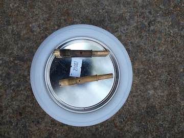

I finally got back on my 30 HP Lark and have a question on the high speed nozzle. I tore down my two carburetors and found the high speed nozzles appear to be slightly different. I'm wondering if this is what causes my fuel leaking out of the carburetor. 1 has a single hole (it was stuck and stripped) the other is the replacement but it has two holes at different locations. Can anyone tell me which one is correct? My guess is that it's the single hole one. Are they interchangeable?
Thanks,
Glen
