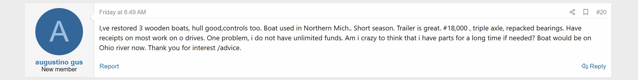

Im an idiot. Never done this, sorry, Wood 1970 Carver w Buick V6 225 engines. not beeen used in 6,7 years. Boat in pole barn whole time. Help. And thank you to others advice for forum. Amazing!!

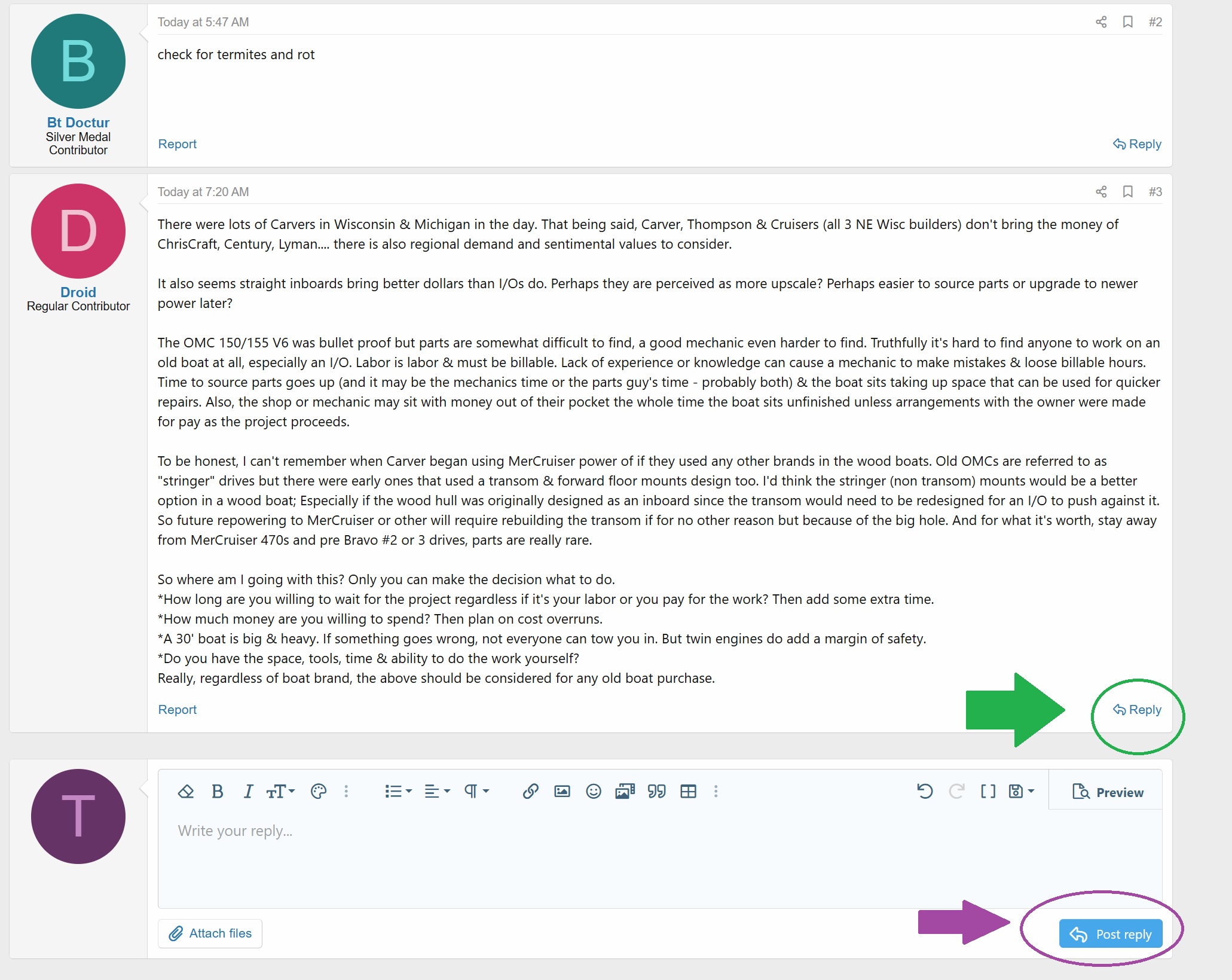

There were lots of Carvers in Wisconsin & Michigan in the day. That being said, Carver, Thompson & Cruisers (all 3 NE Wisc builders) don't bring the money of ChrisCraft, Century, Lyman.... there is also regional demand and sentimental values to consider.
It also seems straight inboards bring better dollars than I/Os do. Perhaps they are perceived as more upscale? Perhaps easier to source parts or upgrade to newer power later?
The OMC 150/155 V6 was bullet proof but parts are somewhat difficult to find, a good mechanic even harder to find. Truthfully it's hard to find anyone to work on an old boat at all, especially an I/O. Labor is labor & must be billable. Lack of experience or knowledge can cause a mechanic to make mistakes & loose billable hours. Time to source parts goes up (and it may be the mechanics time or the parts guy's time - probably both) & the boat sits taking up space that can be used for quicker repairs. Also, the shop or mechanic may sit with money out of their pocket the whole time the boat sits unfinished unless arrangements with the owner were made for pay as the project proceeds.
To be honest, I can't remember when Carver began using MerCruiser power of if they used any other brands in the wood boats. Old OMCs are referred to as "stringer" drives but there were early ones that used a transom & forward floor mounts design too. I'd think the stringer (non transom) mounts would be a better option in a wood boat; Especially if the wood hull was originally designed as an inboard since the transom would need to be redesigned for an I/O to push against it. So future repowering to MerCruiser or other will require rebuilding the transom if for no other reason but because of the big hole. And for what it's worth, stay away from MerCruiser 470s and pre Bravo #2 or 3 drives, parts are really rare.
So where am I going with this? Only you can make the decision what to do.
*How long are you willing to wait for the project regardless if it's your labor or you pay for the work? Then add some extra time.
*How much money are you willing to spend? Then plan on cost overruns.
*A 30' boat is big & heavy. If something goes wrong, not everyone can tow you in. But twin engines do add a margin of safety.
*Do you have the space, tools, time & ability to do the work yourself?
Really, regardless of boat brand, the above should be considered for any old boat purchase.

It isn't a big deal, but just for your future reference you can post messages onto your original thread. To post additional information or more questions to the same thread you can simply scroll to the bottom and start typing in the empty box there then click the post reply button (circled in PURPLE in the image below). If you are trying to reply to something that someone else has posted you can click the reply button at the bottom right hand corner of their message (circled in GREEN in the image below). It will automatically copy their message into the body of your new message, and from there you can delete portions of their reply if you want so that you can highlight the specific information or question you are responding to as I did with your message above. Any time you add a new message onto a thread it will be moved to the top of whichever forum section the thread was posted in, so there is no need to start a new thread to get a better response since simply adding an additional message to an existing thread will bring more attention to it from other forum users. The benefit for you in this case would have been keeping all the information in one place which makes it easier on the people who might reply to get all the information in one place. I have found that if you provide as much information as possible, and make it as easy as possible to read and understand you will get better responses and more of them.
Something else you may find helpful: I have found that most of the replies I have gotten on my questions have come on weekday mornings. Probably because all these fellas are out boating on the weekend! So if you post a question on a weekend and you aren't getting a reply then just be patient until Monday morning.

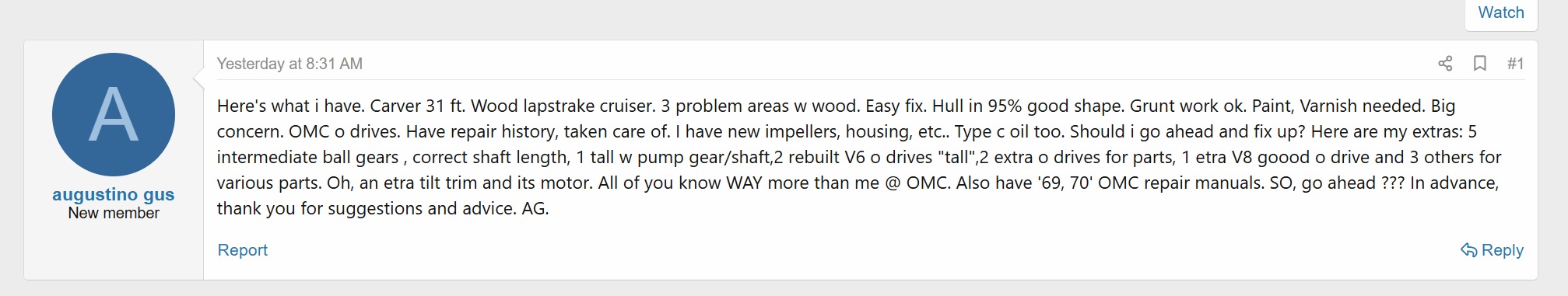

I'm bringing over some of the information from your other messages to help you out. This way anyone who reads this thread has all the important information in one spot.

I really agree with Droid here. Expect this to take MUCH longer than you think. You will spend a lot of time waiting for parts and tools when you order them. Also research on the process will eat up time as well. If you intend to drop this off with a boat mechanic you may have to wait for them to have space in their yard, or time. In my area the boat mechanics are insanely busy. If you need something small they will take it and give it back to you next day; however, if you want to drop your boat off for larger jobs they will put you on a waiting list, and then it will take them days if not weeks. Then consider that life happens and when life happens the boat project gets put on the back burner. In my case I had a lot of "life" happen. I had to put my project on ice for 3 years. Your case may be different, especially if you are retired.
I also agree with Droid on cost. I'm currently at 4 times the amount of money I had thought the boat might need to get her seaworthy and that amount is still going up.
I also agree with Droid that unless you have the space and time to work on this yourself I doubt it will be worth it for you. If you need to pay someone to do a lot of the work then I would guess that you will be spending more on the boat than the value of the boat will be when you finish. So if you plan on having the work done by a boat mechanic you may be better off getting something that is already seaworthy. Additionally I recommend you search around for a boat mechanic that will work on this for you. Even if you don't initially plan to pay a mechanic, you may get stuck and need help so it is a good idea to know what your options are, and what the cost might be if that happens. I see that you have some used units you can scavenge parts from; keep in mind that some boat mechanics either don't want to install used parts, or if they do install used parts they might say there is no warranty on the labor.
You said in the other thread that you have the manual. Read through the sections for the mechanical issues that you need to address and make a list of the tools and parts needed. Then start searching online to find the parts and tools to see if they are available and add up the cost of parts & tools.
I agree with Droid, only you can answer the question as to whether it is worth it to get this thing seaworthy. You will need to do some research and we are here to help with that, but the answer comes down to your personal desire and budget at the end of the day. That said, I can share with you my personal experience: If I could go back in time on my boat project I would have pulled out all of the OMC stuff and sold it online. Then I would have taken the money from selling that stuff and rebuilt the transom to close up the outdrive hole, add an outboard motor bracket and get one used large outboard, and one used small outboard (less than 20hp). The smaller outboard being a backup for emergencies or for efficiency when trolling at low speed. Not being familiar with carver boats I don't know if that's possible for a boat of that size and weight or how hard it would be, but that's what I would have done for my situation. Hopefully someone else who knows carvers can tell you if that's a bad idea. My guess is that you would need 2 larger outboards with how heavy that boat is. If I had gone with an outboard my boat would be on the water already, for roughly the same amount of investment.
Now some more information about your drives that may help inform your decision. I didn't include this before because I assumed you may have already known but I will share here now just in case. OMC designed the ball drive to get around the patents on the U-joint design and while it worked it also came with flaws. The ball drive gears were known to wear out early. They were negatively affected by shifting too fast, shifting into gear with too high of RPM, or running the outdrive while tilted up. Many of the ball gears did not last more than 300hrs especially when paired with larger engine sizes. The clutch springs were also known to break. OMC made changes to improve these units over time including getting rid of the E-shift in 1977 but by 1986 they discontinued the ball drives altogether and released the completely re-designed Cobra. Long story short the ball drive units did not last nearly as long as the engineers had thought they would and as a result they eventually had to scrap the ball drives and completely redesign the OMC lineup. So, if you have a ton of parts and the tools on hand already, staying with the ball gear might get you on the water FOR NOW. But if I were putting this boat together and wanted to keep it for the long term, I would personally want to consider something that will be more of a "long term" solution. Newer drive systems will have better availability of parts & tools, and more mechanics will be willing to work on them. Additionally newer drive systems were engineered better and will likely have a longer lifespan. If you start looking into an upgrade you may want to consider something with a cone clutch.
