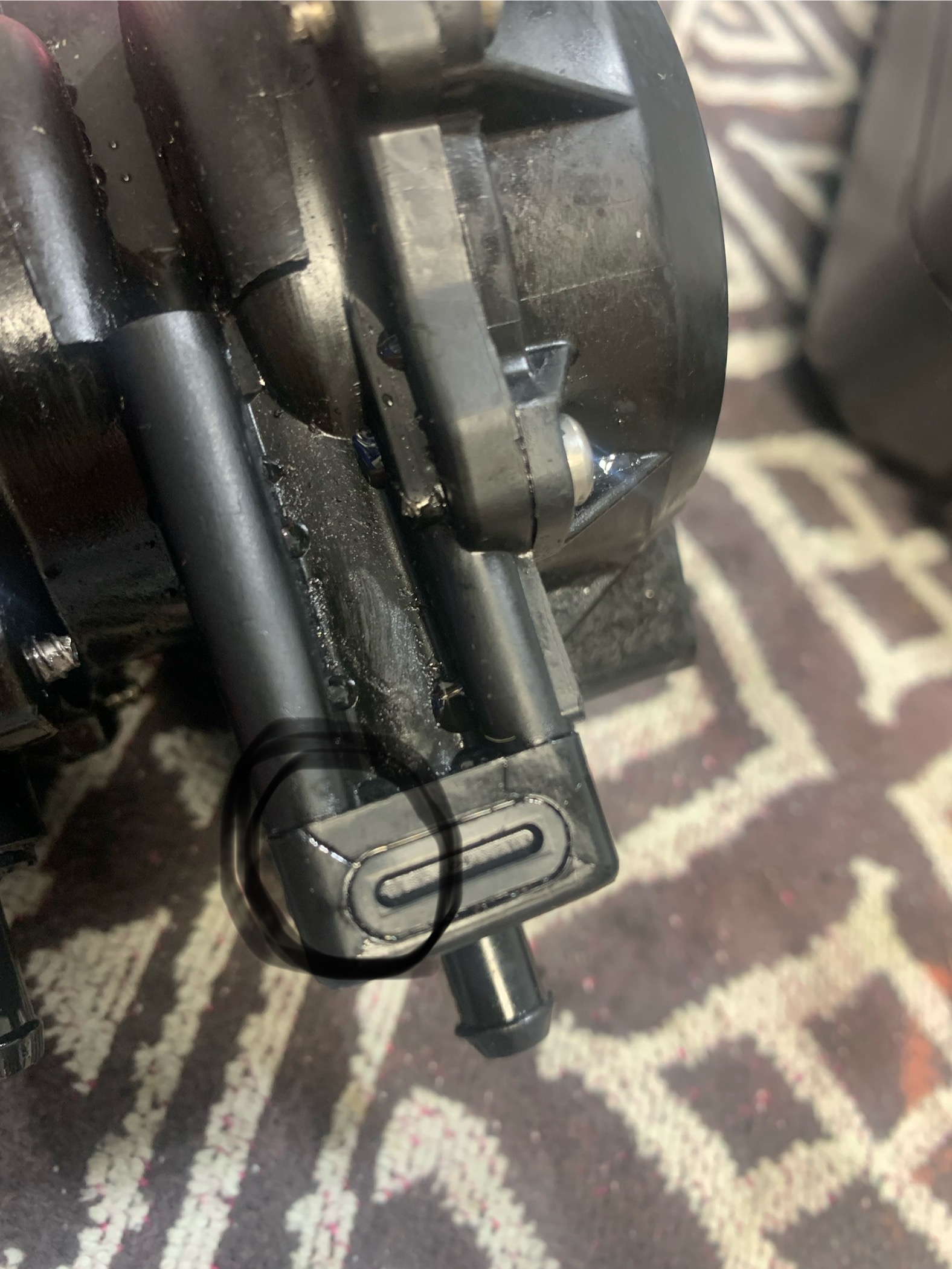

I would like to check my vro pump.
Pump won’t hold pressure. Dunked it and found it blowing bubbles out of this crack…
