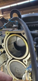

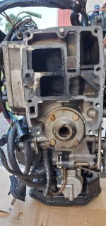

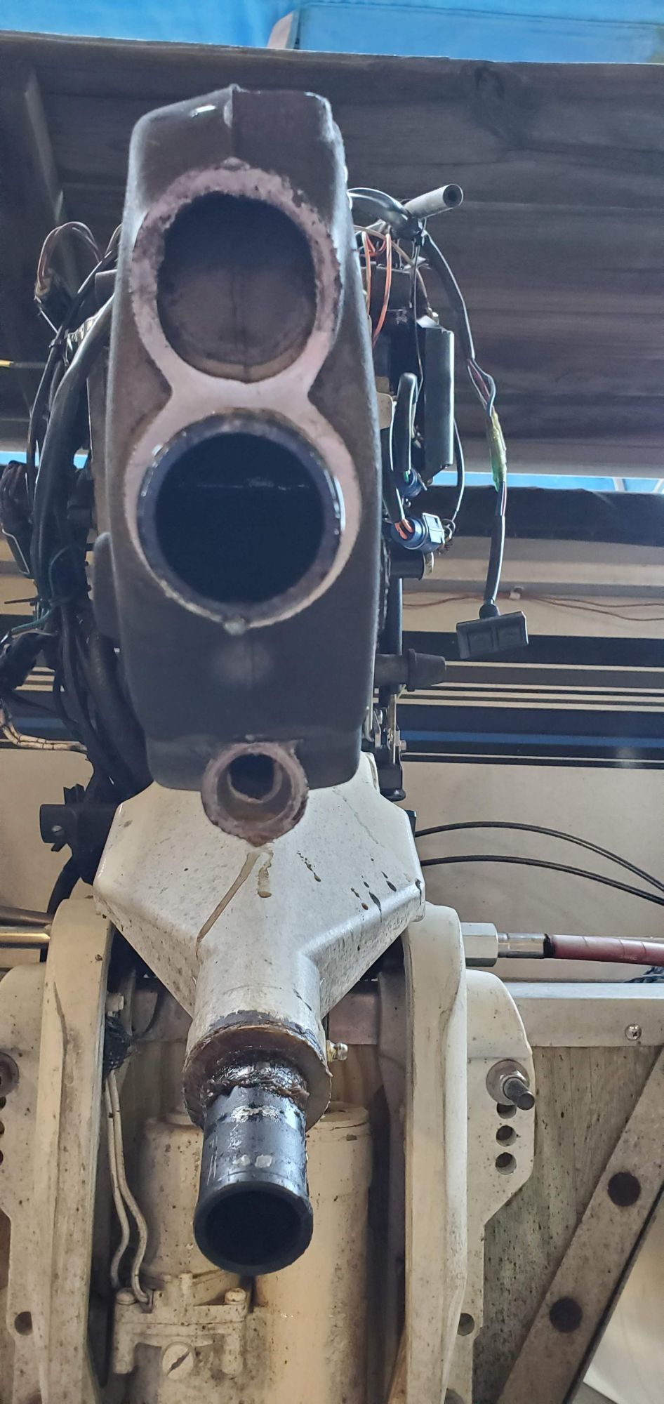

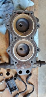

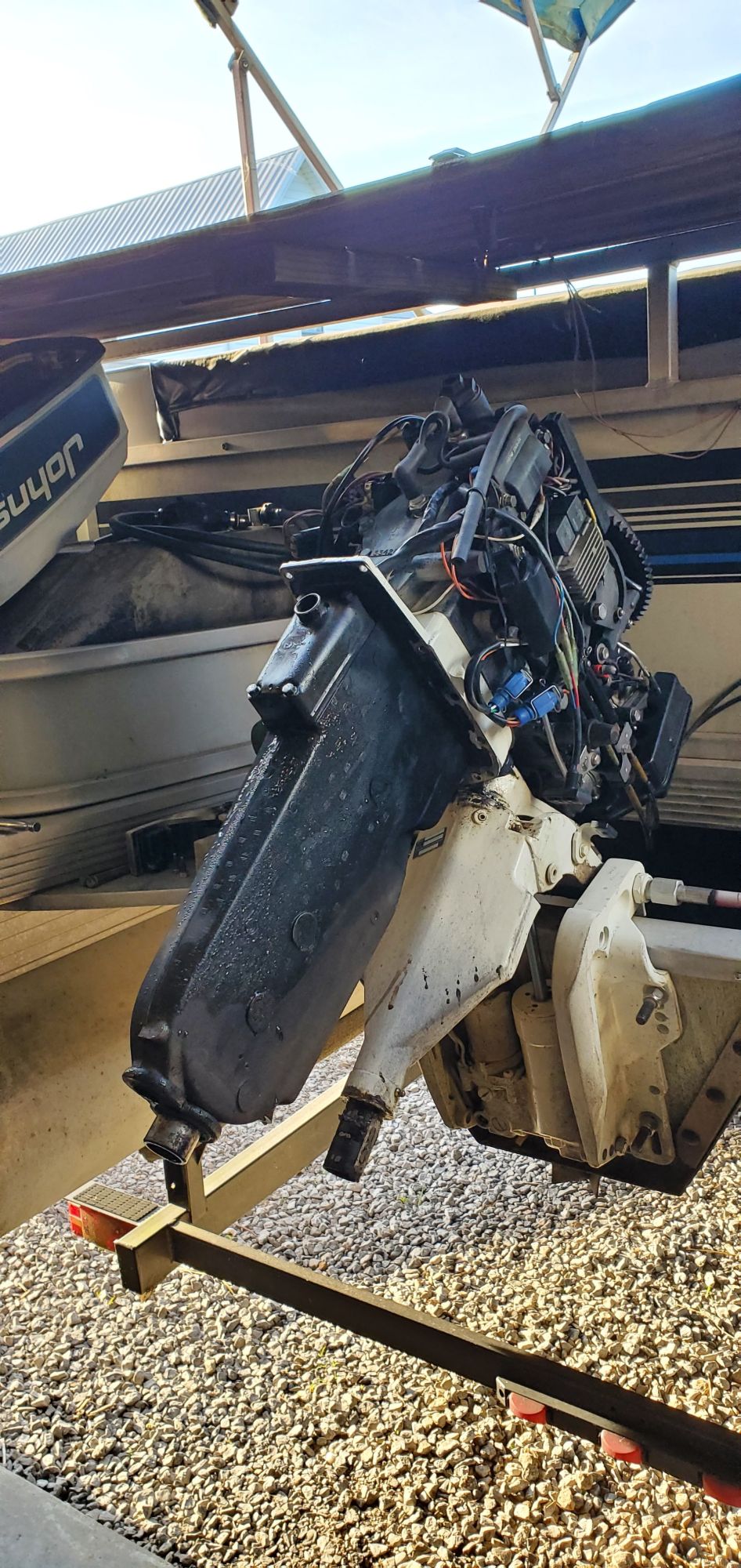

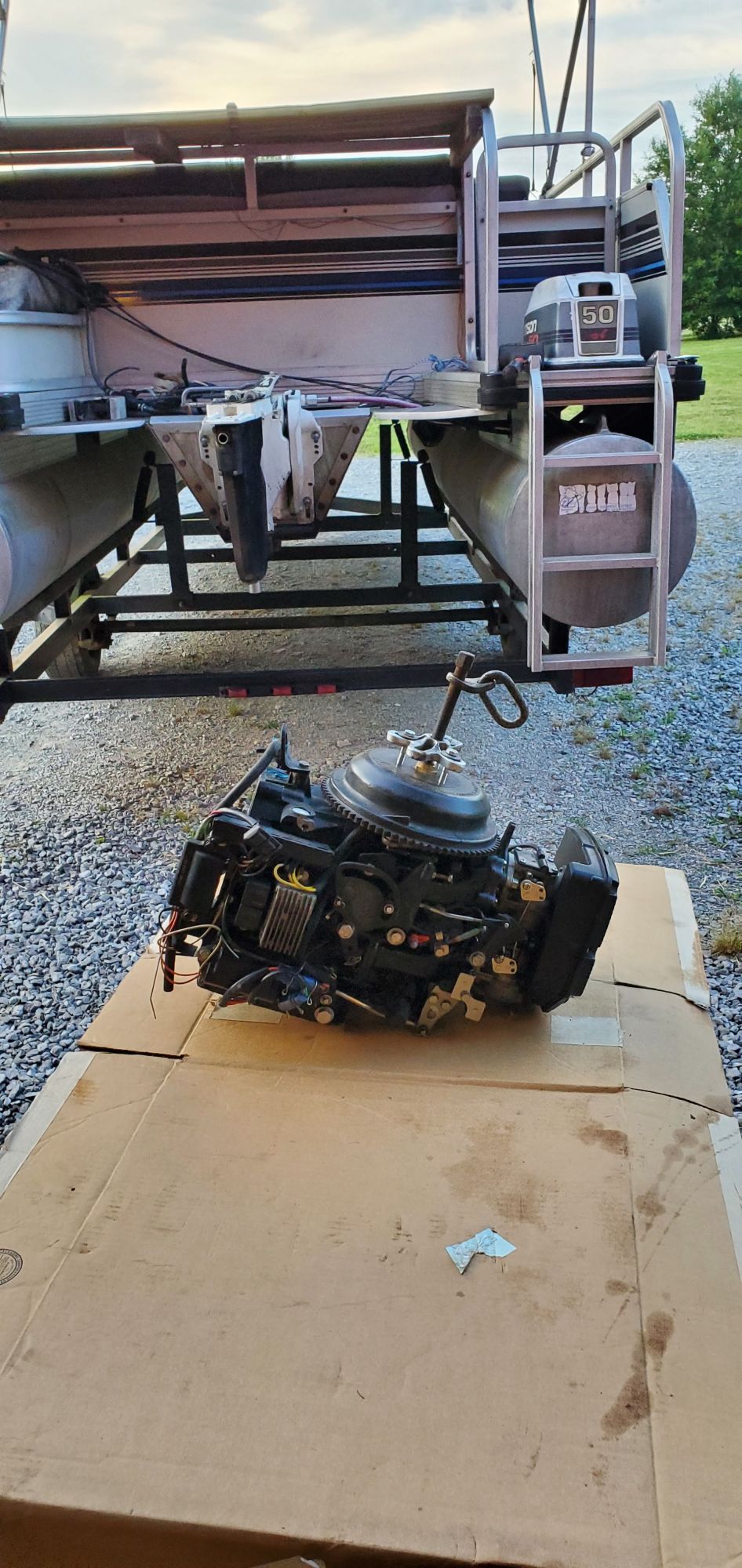

So, now onto the Exhaust side, as I've noticed through this troubleshooting that smoke is coming out of shift linkage hole (has been all along, but didn't really connect the dots), so I dropped the gear head and foot/boot. Now I'm lost...I want to think it's that the lower grommet is/has been my primary issue all along as it's floppy loose and has obviously been leaking, but I'm unsure. While I have it apart, I'd to just "fix it", so here's where ya'll come in. I don't know how to read the signs of what's happening here. Just don't understand it enough. Even like what's water/exhaust and which hole ha! Not sure what it's telling me that one side is "clean" while the other is dirty? Or is it leaking from the top (power head exhaust gasket) or leaking from the bottom (lower unit grommet) and spraying exhaust up inside?
See pics below...Thanks for any and all help here!
