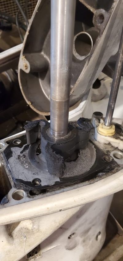

Update - After doing searching/looking for a replacement (and growing impatient, and also just want to see if I can "fix it", I decided to rebuild it. There is also some sentimental value here as it was my mom/step-dad's boat they've had since new. So, let the games begin... got the .020 over block back yesterday. Concluded it was the lack of maintenance (impeller) that caused the over-heat (top cylinder/top wall), that in-turn scored the piston/wall, and caused the no idle condition. Funny too, while dropping it off at the machine shop, machinist/owner said, "Let me guess...it won't idle, but runs great otherwise? It happens all the time with these...I tell shop mechanics (primarily does dealer work) who call me asking questions - pull the head and check the walls if it won't idle..." So I guess it is common. Preventive maintenance lesson for me going forward, to stay diligent on the impeller replacement.
Somebody ran that motor with no cooling water to the impeller.----This seems to be getting more common.---Looked at 2 70 HP motors within the last 2 weeks where impellers were destroyed running dry !!
