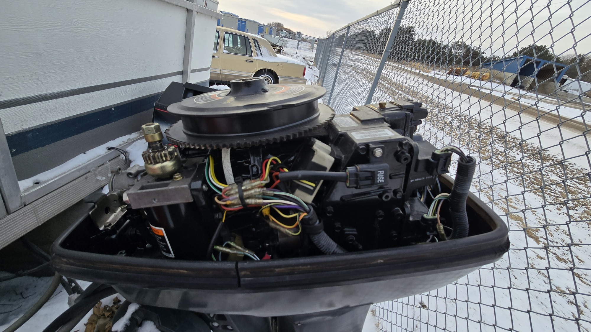

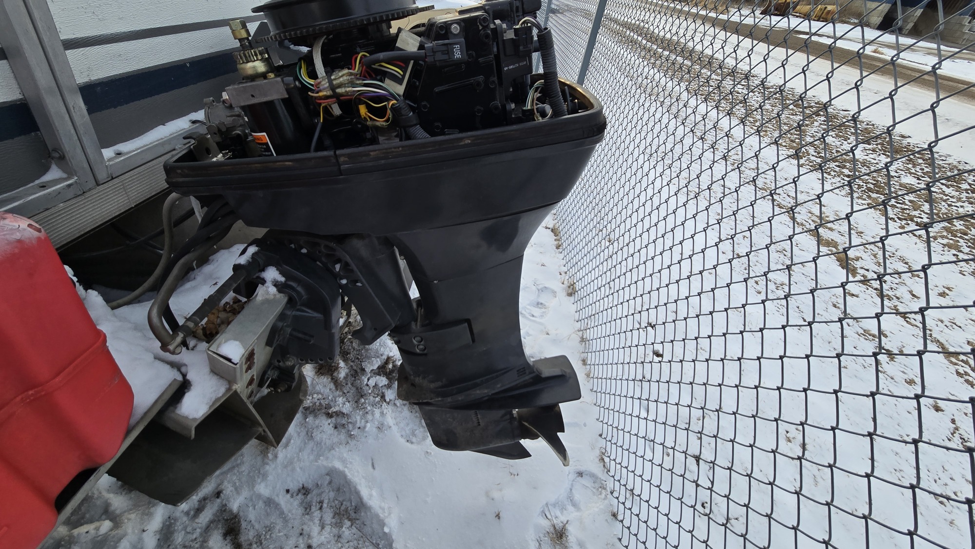

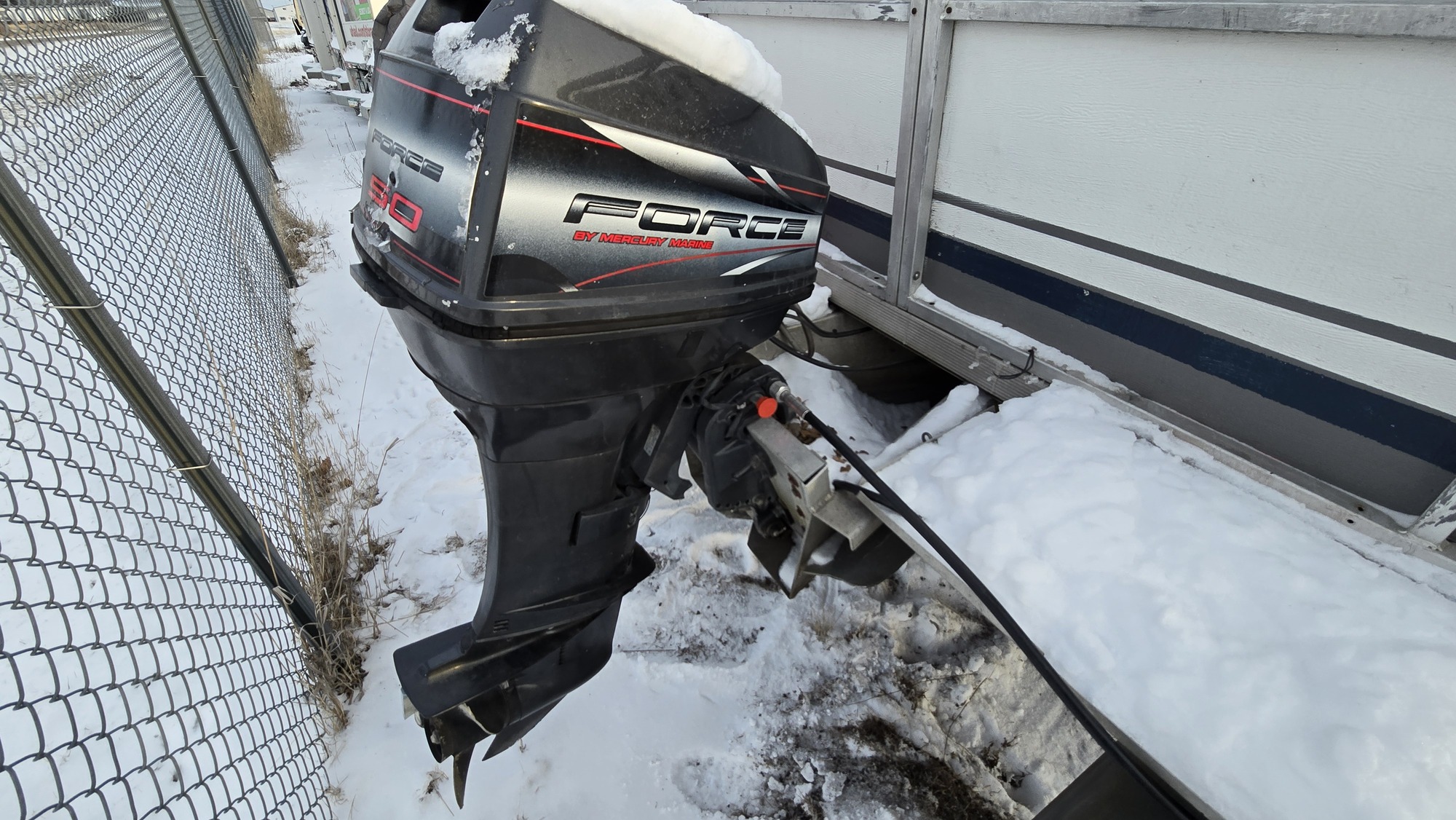

Hi, all. Just picked up a Smokercraft pontoon yesterday with a '99 Force 50 on it. Have not run it yet due to all the lakes around being frozen (Southern MN), but the motor looks almost brand new. I figured it's been very cared for, could've been NOS in a warehouse somewhere or recently rebuilt. I'm aware that's no way to determine it's condition, just throwing it out there. The main things I'm trying to figure out before the lakes open are what prop will fit it and how to diagnose the trim switch/wiring.
The prop that's on it had very clearly been banged on rocks at some point, it's very chewed up. I cannot find any numbers or anything on it that tell the pitch and diameter. Are these numbers typically hidden somewhere? On the Evinrude I have on a smaller boat, the numbers are right between the blades.
For the trim, it runs going down, but not up. I'm hoping it's just a wire came loose somewhere, but I've never worked on a motor with functional trim. Evinrude has it, but doesn't work, never bothered fixing it. Is there anything I should check first before anything else? I'm good enough with a multimeter to trace power, or lack of.

Trim and tilt, first pic: two red wires go to the relays, the relays are hooked to a green(down) and a blue(up) wires.
Swap the green and blue wires and see if the T@T works now. Works? then the contacts are bad or the relay is bad.
Easy testing with your meter.

I see the snow in your picture, where are you? Maybe fill out the profile?

I live in Owatonna, MN. Top speed isn't a concern for us, we're not pulling skiers or tubes any time soon. It's a pontoon boat that'll be used mainly for fishing and leisure crusing. The Force motor that's on it wasn't the factory motor, it used to have a Johnson or Evinrude at some point. I'll ask Solas and Michigan Prop for their suggestions.
