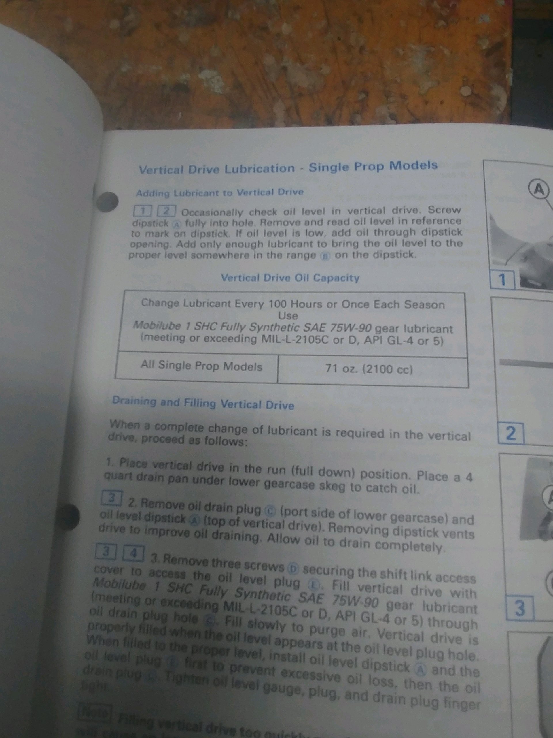

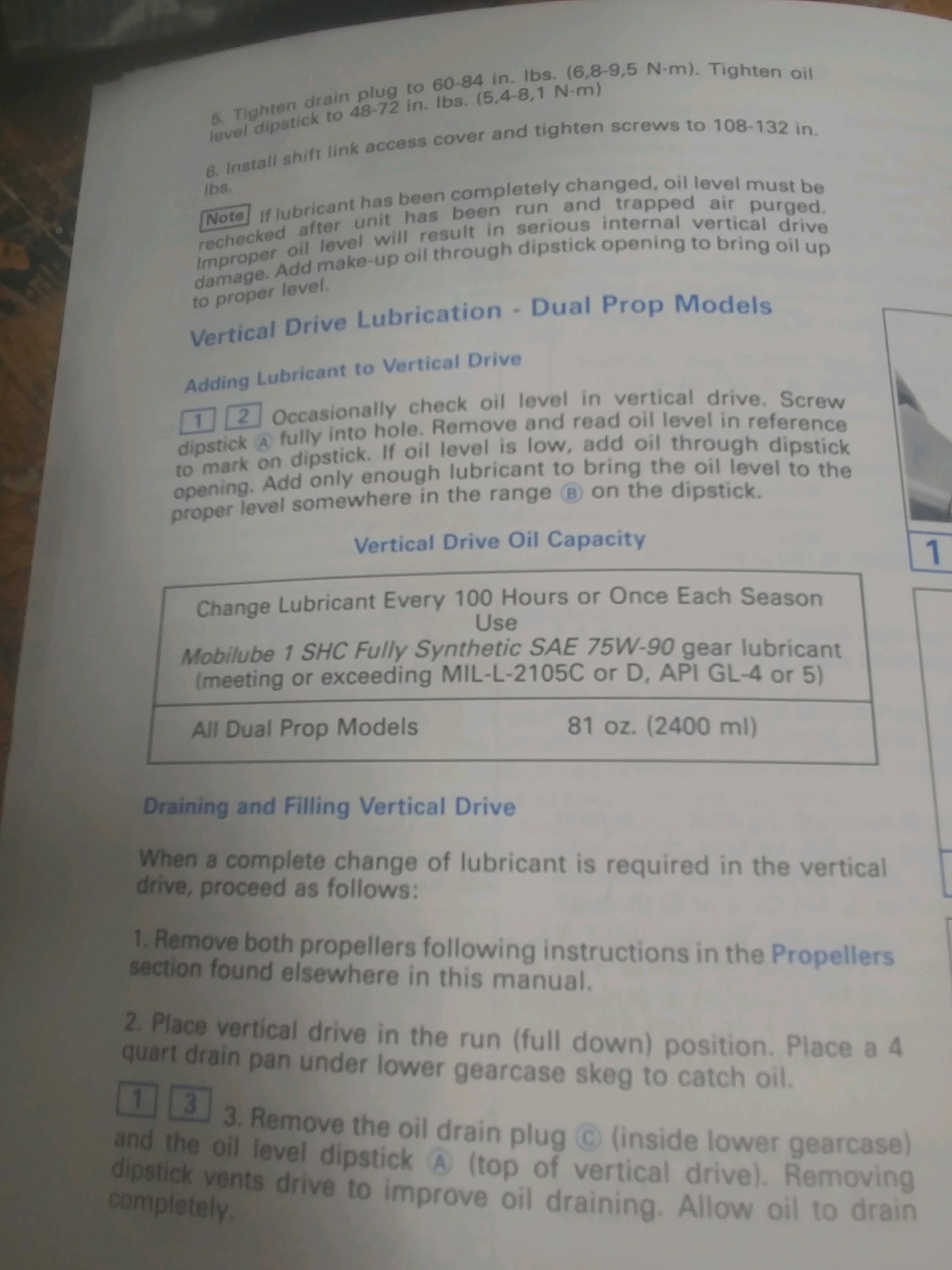

Since that is a "Joint Venture" drive, I took these 2 pictures from a 1995 OMC service manual. Only difference I see between single & dual prop is quantity.
Buy the correct oil.
