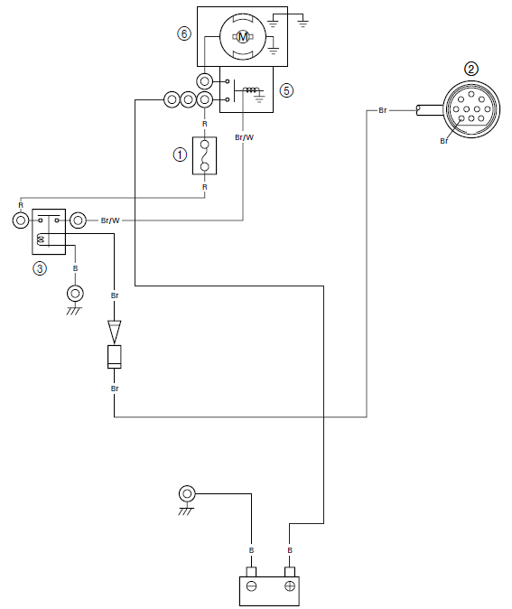

The F115 model uses a starter relay to activate a starter solenoid. The relay is activated when the key switch is turned to the start position.
Brown wire from the key switch to the relay. Brown wire with white tracer from the relay to the solenoid.
Relay is located to the left of the voltage regulator at the front of the motor. Solenoid is located on the starter motor.
Apply voltage to the brown/white wire. Solenoid should close and the starter motor should crank the motor.
Apply voltage to the brown wire. Relay should close and apply voltage to the brown/white wire. Starter motor should crank the motor.
See below.
See below.

Thanks for the diagrams.

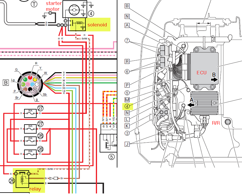

Thank you. can I just apply 12v to the large red starter wire/nut that's on the starter or do I have to do it to the brwn/white wire? I tested a starter on my zero turn mower by just applying 12v directly to the starter to see if it turned (it did) so I replaced the relay and all was good.
Is the relay just behind the large mass of small wires coming out the left side of the ECU? with the brwn/white wire going to the wire junction assembly that has the PTT blue and green wires wires on it too? I tried to uplaod a pic but server says it's too large. where is the Brown wire with a bullet connector that some say you can unplug and apply 12v to it to get the starter to turn? I don't see it.
thx
#1 is the main relay.

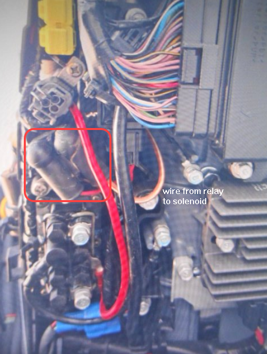

Thx. I just wish someone could post a pic of the starter relay on the engine so I know where it's at and looks like when installed. I have a good idea but just can't seem to I.D. it; yet....
I think it's mounted just above the PTT relay at an angle looking at diagrams. I took a pic yesterday of the area it should be in. Is it right above the PTT relay assembly (I have removed the PTT leads as my PTT is being refurbed) with the two rubber boots just left of the large red wire?
It's pouring rain today so don't think I'll be able to do anything until tomorrow.

It is right above the trim and tilt relay. As shown in the diagram above. In your photo you can see the brown/white wire that connects the relay to the starter motor solenoid. Rubber boots covering the power terminals.
outstanding! Thx.
yes I did see the diagram but I wasn't sure as to the actual position as the "line diagrams" you follow for placement/installation (like shown for some of the screws/bolts) weren't on the relay so I couldn't "follow" it to it's position...

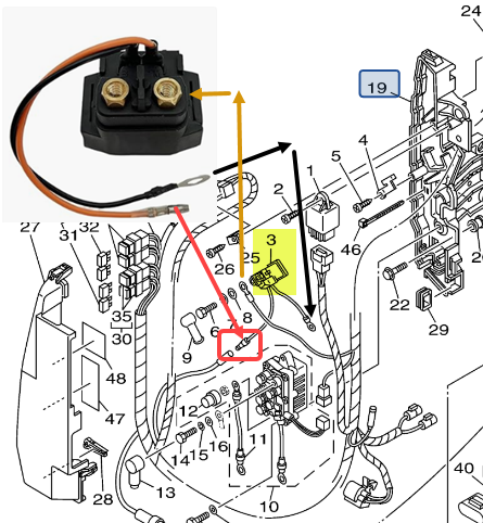

So now that I know exactly where it's at, :) I assume the "bullet" connector that I have read you can apply 12v power to to check starter motor is up under the ECU harness? or can I jump the brown/white and the red power terminals together on the relay itself instead?
Find the brown wire bullet connector and apply battery positive. See what happens.
I'll try that if I can get to it easily (the bullet connector). It would be easier to jump the bwn/wht and red pwr terminals together as they are very accesible. would that work too? (to activate the starter motor?)
Jumpering the brown/white wire to battery positive should activate the starter motor. That is what it is supposed to do.
Just like the diagram in post #3 above shows.

From the diagrams and Boscoe's post, the brown wire sends current to the relay, the br/w wire sends current from relay to starter solenoid, so jumping the br wire at bullet connection leading to the relay will send current from relay through the br/w wire to the solenoid. But if the relay is faulty it might not reach the br/w wire, if nothing happens try the br/w wire, if that works then it's a bad relay.

ok, check. I guess the brwn wire is likely coming from the ignition switch?
Red (battery +) wire to the key switch.
Brown wire (battery +) from the key switch (start position) to the relay.
Relay closes. Brown/white (battery +) to the starter motor solenoid.
Starter motor solenoid closes. Battery + to the starter motor.

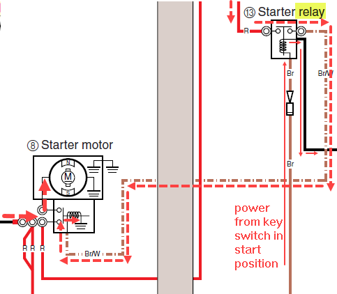

Brown wire from the key switch to the control circuit of the relay.
When there is voltage on the control circuit the relay closes.
Battery + then flows through the relay power circuit and on to the control circuit of the solenoid.
When there is voltage on the solenoid control circuit the solenoid closes.
Battery + then flows through the solenoid power circuit and on to the starter motor.

I appreciate you trying to educate me but I have little to no experience in reading electrical diagrams so it's a bit difficult. in both posts 26/25 i see the power going from the key switch via br to the relay. then from the relay to the solonoid via br/wt
I also see R on the relay (from the connection under the rubber boot) to the fuse (I think) then on to the solonoid and then starter.
My question is if the relay is bad (or good) and/or the selonoid is bad too, can't I just apply 12v to the large R on the starter motor solonoid itself to see if it activates. It looks like the large R goes to the solonoid AND the starter too which if true, should activate the starter even if the solonoid is bad.....
