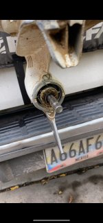

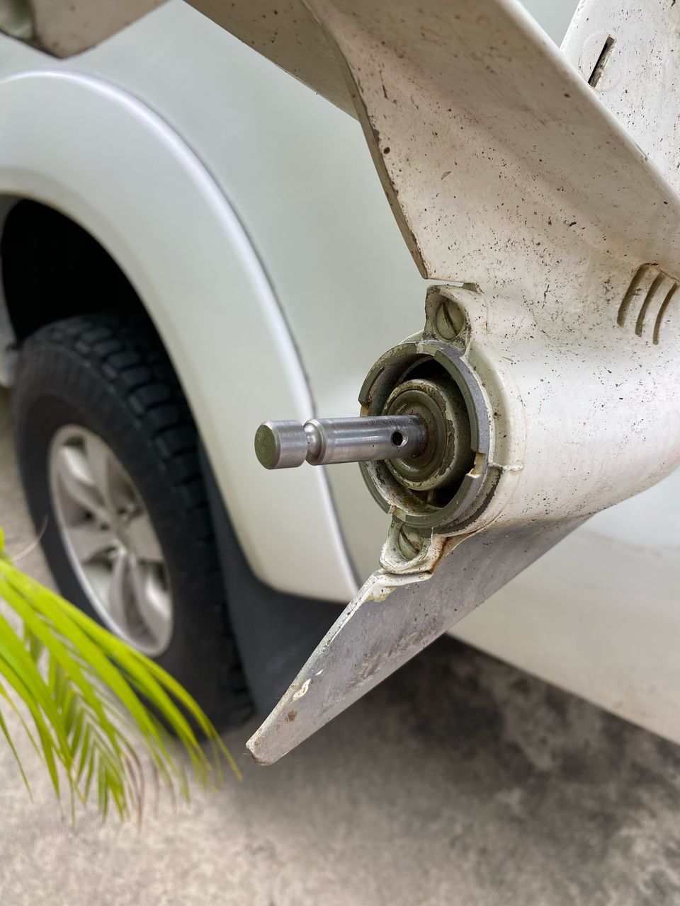

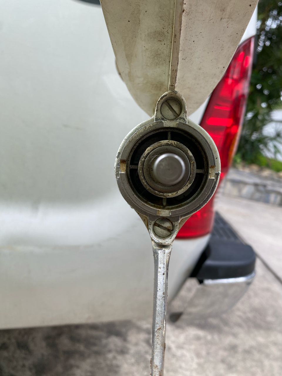

Also, when I first pulled the motor out of storage, I noticed a clear plastic ring at the base where the propeller mounts. It was deformed and tangled with fishing line, and unfortunately I lost it. The odd thing is, I don’t see this ring listed anywhere in the parts diagram.
Could this have been a part that’s included with the propeller or clutch ring? Or was it perhaps not original and someone had added it as a spacer or seal?

Those are the parts you need as listed. I have a 1978 and 1980 4 hp weedless drive and none have a clear plastic ring.
Are you sure that this gearcase is original to this motor? Earlier versions back in 1970 had additional bushings and parts. Look up the parts for 1970 and see if you recognize anything.

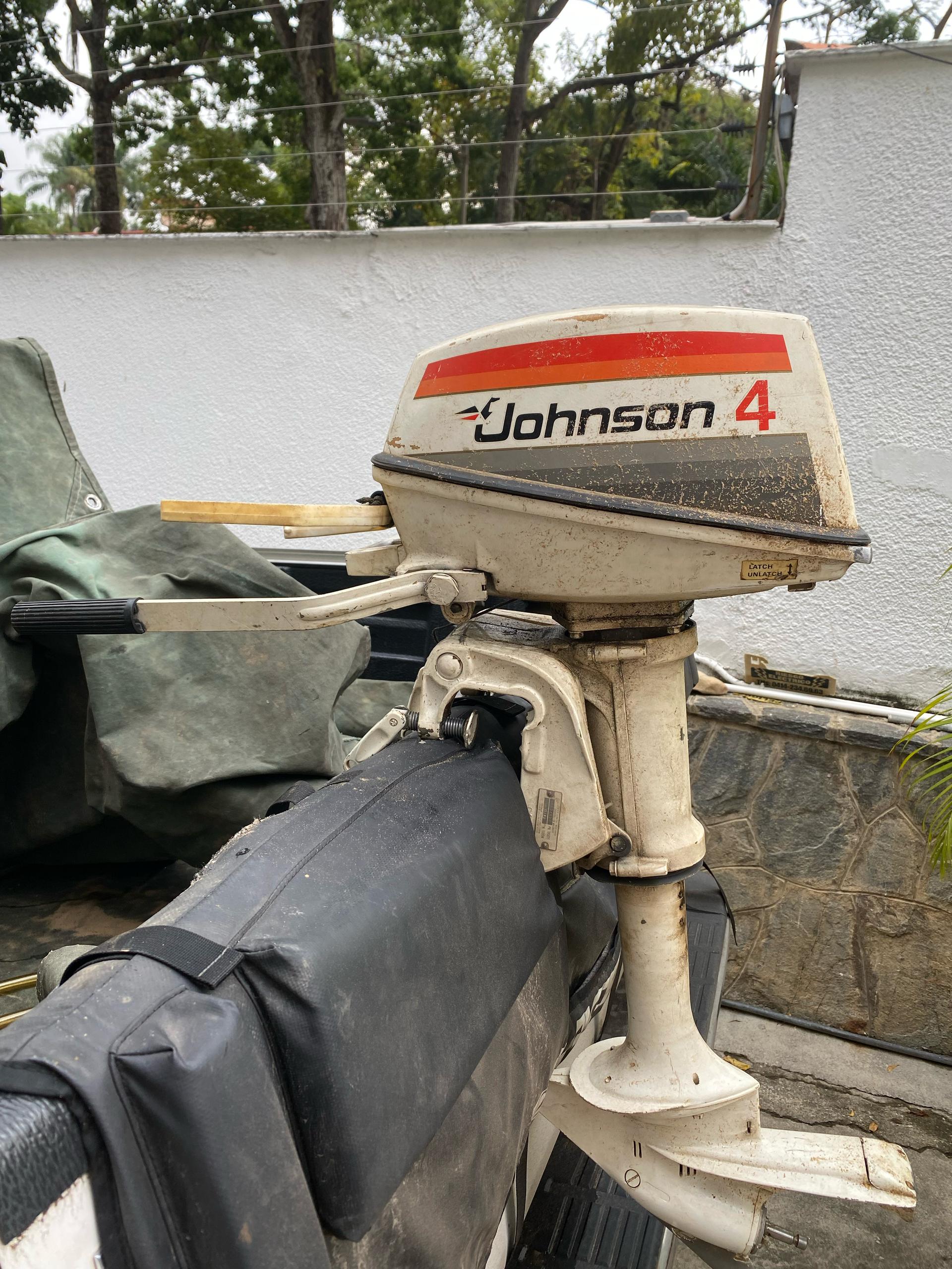

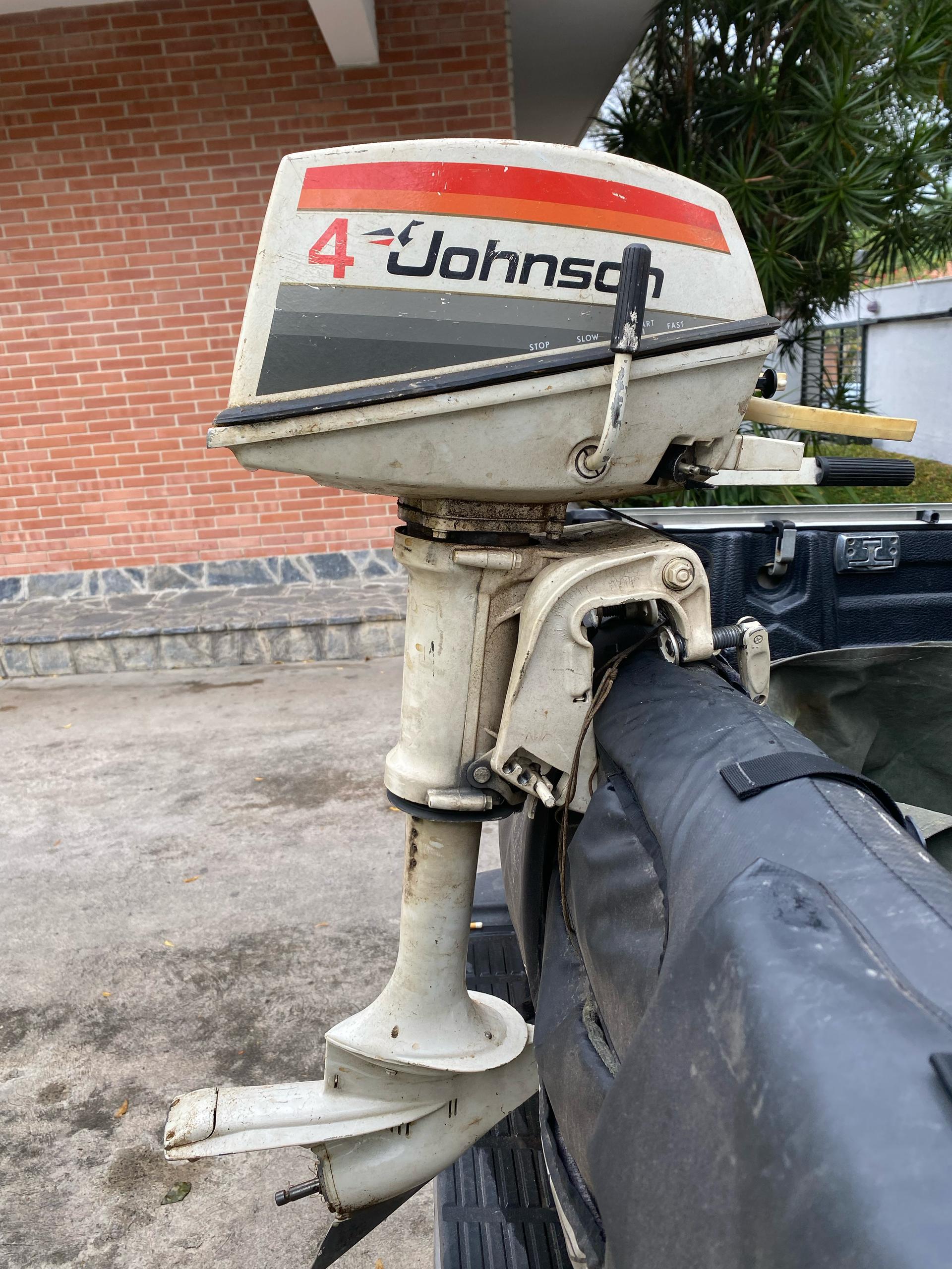

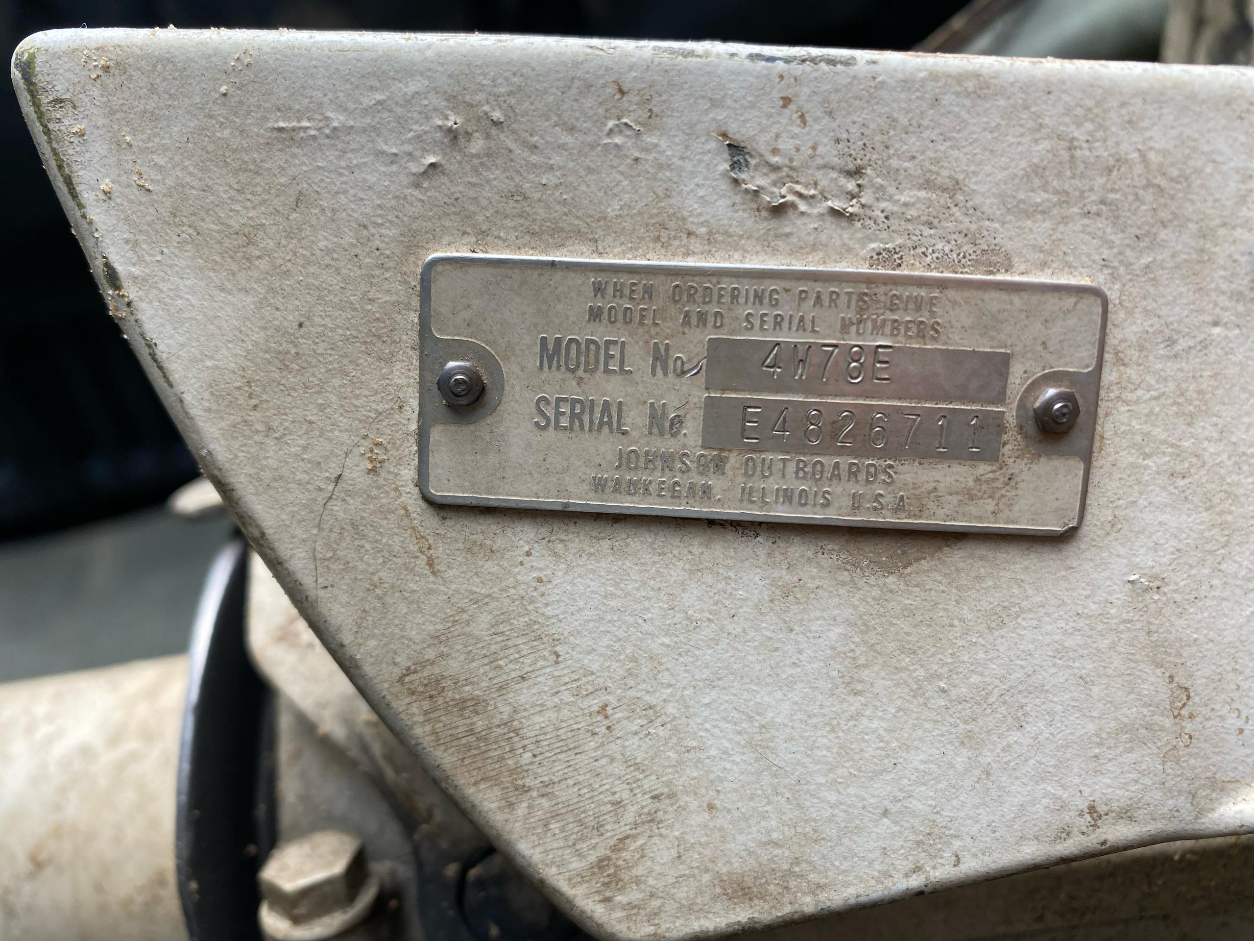

According to the parts diagram provided by Boats.net for my specific model (4W78E), the gearcase does appear to match what I have. That said, I’ll attach a few general photos of the motor in case you recognize anything that looks out of place or possibly missing.
I’m also including:
  • A photo of the model and serial number plate
  • A photo of the gearcase exactly as I found it when I pulled the motor out of storage
Unfortunately, I don’t have much background on the motor’s service history. It originally belonged to my grandfather, then was passed on to my uncle, and finally to myself about 20 years ago. At this point, I honestly don’t remember if anything was already missing back then.
Thanks again for your time and help—I really appreciate the support

I just went out the shop and removed the propeller from the exact same 1978 4 hp weedless engine. #25 and #26 is all that is there. plus the drive pin and cotter pin. Go forth and order!
does your 1978 4hp looks exactly like mine? also on yours the propeller has 2 or 3 blades?
It is identical to your engine, 1978 4 hp, 2 blade propeller, you may also want to check if there is any water or gearlube loss where that fishing line is wrapped around the propeller shaft. Fishing line can cut that seal.
yes, checked the oil and it came out spotless. also starting to believe the misterious plastic washer i found could be molten fishing line.
