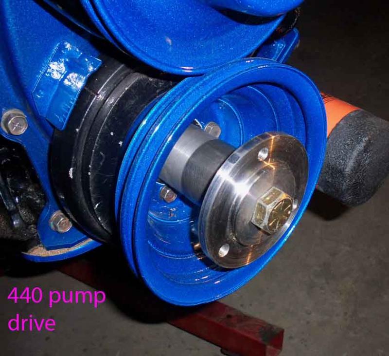

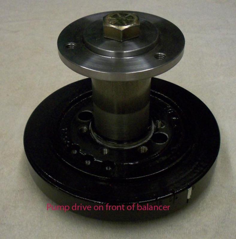

Here are some pics and explanations. The original parts that are used on these older Chrysler 440's are getting obsolete, hard to get, and were heavy. The engines are known for there longevity, huge torque and fuel efficiency over the other big Blocks. My Searay with twins uses just about 1/2 the fuel of my buddy's same Searay with twin 454 Chev engines as an example. After building these for over 30 years nothing on my engines, short of the blocks and heads, looks original. These engines are much lighter, run cooler, easy to get parts for and are very reliable. Engine modifications are not for everyone. However most of us who own a 30 year old engine are open for changes.
All the engines I build are total closed cooling. The manifolds are cooled with Glycol and only the stainless steel risers and the heat exchanger see raw water. I would NEVER put sea water, fresh or salt in an engine that is cast iron. after 1 season the block will have too much insulating scale, as well as small passages will be blocked causing hot spots in the castings. The strongest marine 440's used a head that has 2 extra passages per spark plug, on on each side to provide extra cooling to the plugs to prevent detonation. Every raw water cooled engine I have dismantled had these passages plugged.heavy duty head plug cooling.jpgStandard head.jpg I know that some guy's do not want to modify their engines and would be happy to post threads about it. I really do not want to get into that. If a person is happy with the way their engine is set up, great. It's all about enjoying the water anyway. i have posted a pic of a standard head and one with the extra cooling, these are 1/4 inch diameter holes, you can imagine what raw water will do to these. The extra cooling keeps the plugs much cooler, better for the volatile Ethanol fuel. The dual pocket raw water pump system work, but also cause huge amounts of block corrosion.
Here are some pic's of the pump drive I have been asked about in many emails. One shows the space from the edge of the crank to the face of the balancer. A depth of about.200 is need.Balancer front showing space.jpg If less a small amount can be taken off the end of the crank or the end of the drive adapter. In the rare case it needs extra I take it off the crank as this is what centers the pump drive. Some engines use a spacer behind the pulley and some do not. The adapter is machined to go inside the spacer so it works on either one. It works on 318 thru 440 engines as the dimensions are the same.
Just remove the bolt holding the balancer on, check for the right depth to the end of the crank, if good put the adapter on, put the longer bolt in and tighten to spec, thats it. The pump centers over the hub in the middle of the adapter then bolts on using the 3 bolts.
When I get a chance I will take pictures of the heads and manifold adapters. This set up removes about 200 lbs from the engine. If the Mercruiser stainless pipe style risers are used it adds better breathing and more weight savings over the cast stainless risers. I have used both.
Hope this answers some questions, or maybe just created more questions.
DanPump drive mounted.jpgBalancer showing pump mounted.jpgBalancer spacer and pulley.jpg
Here are a couple of other pictures I could not get to load last post.Front pump mounting parts copy.jpg

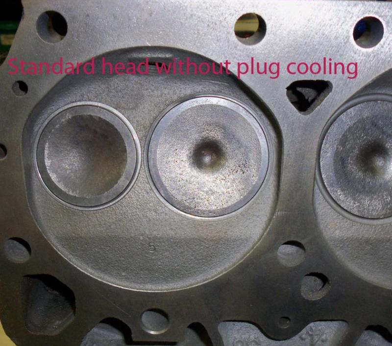

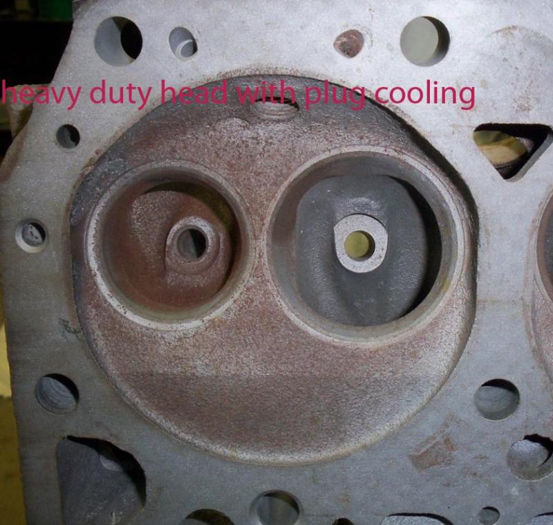

..."The strongest marine 440's used a head that has 2 extra passages per spark plug, on on each side to provide extra cooling to the plugs to prevent detonation."
Is that the "RV motor" that used peanut plugs?
Jeff
Dan, OK.... I see now what you had to fabricate in order to drive the crankshaft pump.
I see the two alternators..... so that answers my question as to why so many belt shivs.
Could you eliminate the forward-most un-needed shiv?
If so, would that allow the crankshaft pump to install without the drive adapter?
Another question.... for those running only one alternator, minus the extra belt shivs......, is the drive adapter necessary for the crankshaft pump?
Just curious.
Picture was taken when setting up the engine. 2 alternators are 200 amps each, total of 400 amps per engine with twin engines gives me 800 amps at 14 volts. My boat has full size fridge, apt size deep freezer, central heat and a/c, 1200 watt microwave, 4 gal, 120 volt water heater, large TV plus tons of lights and electronics. 8000 watt inverter peaking at 16,000 watt In hot weather I can cruise with the a/c running or idle and engine and have at least 300 amps to use. I have lived aboard cruising for over 4 months and never used shore power. there are 11 huge deep cycle house batteries. Each alternator uses both belts so all 4 are used just for the alternators.
The design of the Chrysler balancer does not allow direct mounting as the front of the pump was designed specifically around the Chev pulley. The bad thing about mounting on a stamped steel pulley is that if the pulley is at all out of round, typically of stamped steel, the pump will wobble. This drive I made is bolted to a perfectly machined surface so the pump runs true. Once I did the first one I would never go back to belt drive. If the motors runnin' the waters a pumpin'.

I have found these engines in RV's, White combines, marine engines and an irrigation pump marked industrial engine.
the 1973 version of the motor usually had a windage tray and the bigger 6 pack rods. 2 years ago I pulled a set of engines from a boat in Florida and owner told me were original, both had these heads. Yes the use the tapered seat BL9Y plugs (R43TS)
I will try to post a picture of a head that I have machined the hardened seats into on both the intake and exhaust valves. This makes a very strong marine head especially with ethanol.
Yep! Good for you! I like the idea!
With the GM pulley, there are two raised portions that act as dowels that align the pump base as to center it. Typically, we don't come up against any wobble concerns, unless there is an issue with the pulley.
That's why I was asking what you did to accommodate this.
Sounds like your adapter is the cure for this!

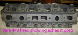

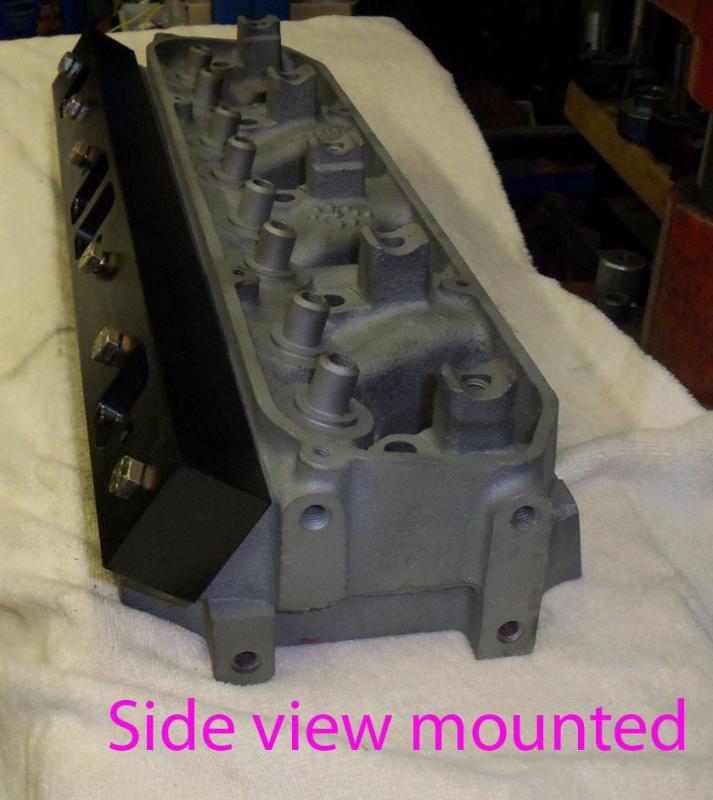

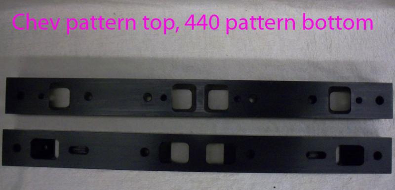

[FONT="]Here are some pictures of an adapter mounted to a bare 440 head. I had to use a bare one as the finished black ones would not show the adapter.[/FONT][/LEFT]
[/LEFT]
[LEFT][LEFT][FONT="]The width brings the mounting surface for the manifold out the right amount so the Mercruiser style 5.7 manifolds clears the rocker cover enough to remove it but not so much it sticks out to far.[/FONT]​
[FONT="]They are hard black anodized. These are the answer for getting rid of those massive old logs that Chrysler used back in the day. The old logs tend to overheat the end cylinders exhaust valves.[/FONT][/LEFT]
[/LEFT]
[LEFT][LEFT][FONT="]I just finished these so I had a set to take pictures of.[/FONT]​
[FONT="]This should answer the questions I have gotten.[/FONT]​
[FONT=&quot]Dan[/FONT]​

The manifolds I use are the same foot print as a small block Mercruiser but are aluminum from HGE. These are pressure cast not gravity poured. The adapters set them out just far enough from the head to be able to remove the rocker covers without removing the manifolds. So it makes about 5" out each side. The Glenwood, Nicson, Edelebrock logs all work great, but lack the rise needed for larger boats with the motors close to the waterline. I used Glenwoods on my old Gamma ski boat and they worked great.
