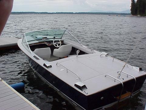

I have raw water cooling, using a double pocket pump. The aluminum manifold (now at 12 years) shows no sign of corrosion, but if it does fail, it is easy to replace. Between the aluminum intake and the aluminum logs, I think there was a weight savings of 150 pounds, quite alot in a 2200 lb boat. The torque in a 440 is amazing. arabian.jpg082.jpg

to answer Tonyj ....My boat is a Century Arabian 1969 model. I believe one of 68 built that year. I read somewhere that it was Cenury's first 60 mph boat. I am at 5000 ft. I purchased the boat in 1999. The engine had 4 quarts of water in the pan. Upon disassembly, I found that the port side log was cracked, allowing water to bleed back into the exhaust valve. Two cylinders were rusty. The engine had previously been bored .040 over. I choose to hone the cylinders, new rings, seals and a good valve job. I was lucky that the two cylinders cleaned up and the motor runs strong. This is a reverse rotation engine. I understand that camshafts are difficult to come buy. It is also reasonable on fuel. PM me if you want more info.
