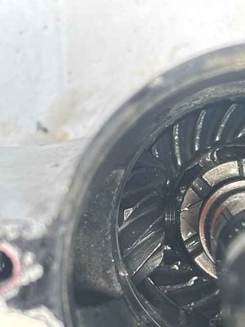

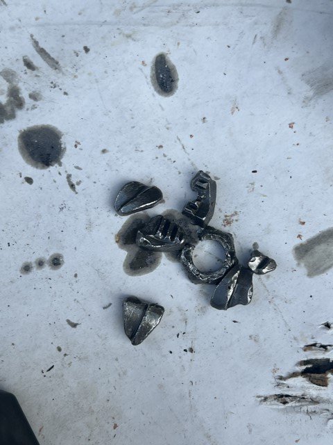

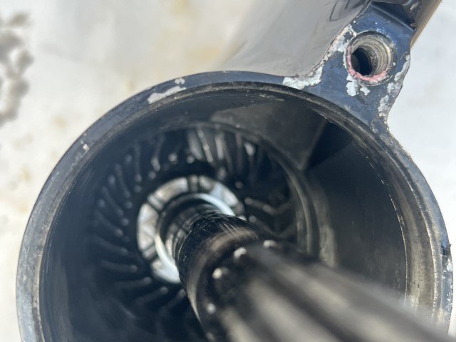

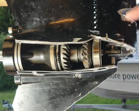

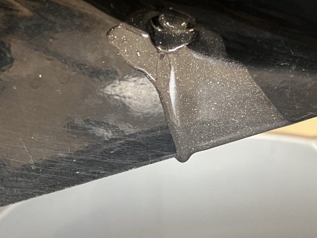

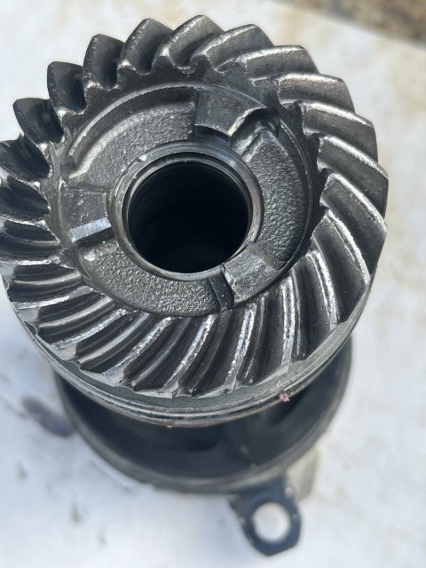

last picture shows a lot of small metal pieces...lots

That's your gear oil? If so, that's BAD.
Did you ever see this log, before or after the clunk? Or are you assuming you hit a log?
I'm going on the belief you felt the gear break & not an impact.
Usually the pinion gear (the gear on the bottom of the vertical shaft) which I don't see in that cutaway & forward gear (on the right in your picture) break together. Actually, the pinion gear has less teeth so each tooth works more over its lifespan than forward. Pinion breaks causing collateral damage to forward & reverse. Most damage to forward because it is under load when the pinion fails.
I assume in your case there are enough tidbits of teeth on the pinion gear to drive reverse (gear on the left).
Reverse usually isn't the gear that fails simply because is typically does nothing but spin freely while the pinion gear & forward are doing the work. It gets chipped as collateral damage from broken gear pieces from the other 2 gear.
