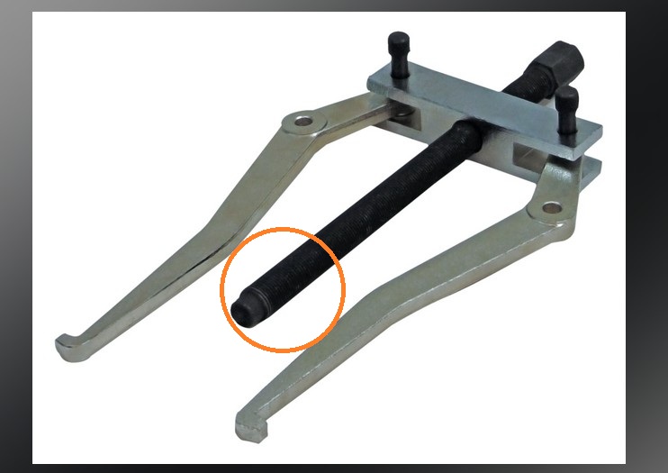

Put puller legs where the most meat is on carrier. Use a prop thrust washer which is about 2 1/2 inch diameter (install on prop shaft at tightest point of puller legs to keep them spread all the way apart for best grip on carrier)
If its been in there a while expect it to be difficult to pull out and possibly the puller could break the aluminum carrier.

Image shows typical puller used thats easy to come by. The red circle shows where the thrust washer would go, The smallest gap between jaws. it helps keep them spread apart and engaged to the carrier.

Depending if you have an early or late model will determine if the puller jaws face in or out. Good possibility of damage to the carrier if you get it wrong.
If you need to use the out method, be careful if you're using a generic puller. Some of them have the hook on the jaws too long and will scrape the threads in the gear housing. Might need to modify the jaws by grinding a bit off.
