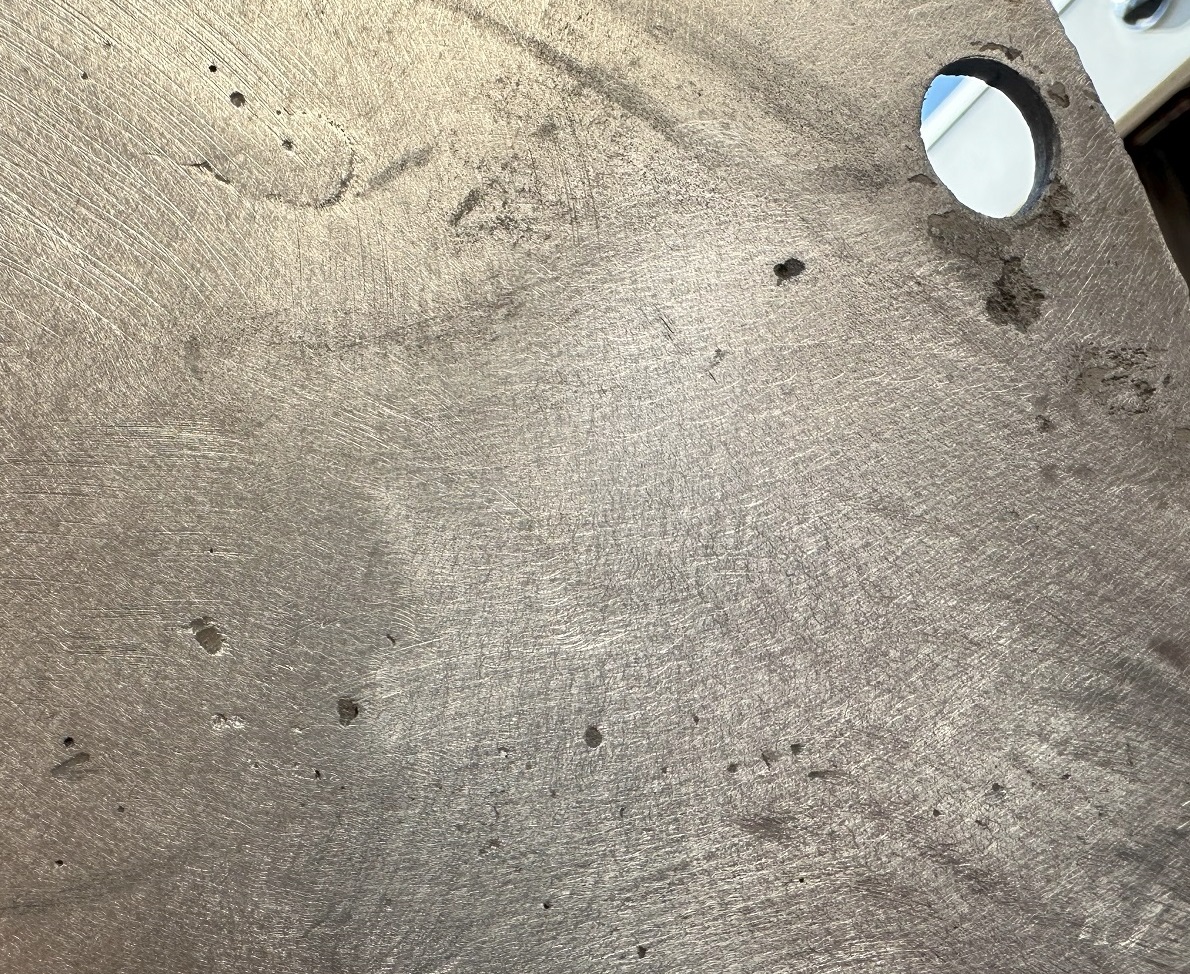

As is the tradition I must share the photos the weld.
This shows everything from the outside.

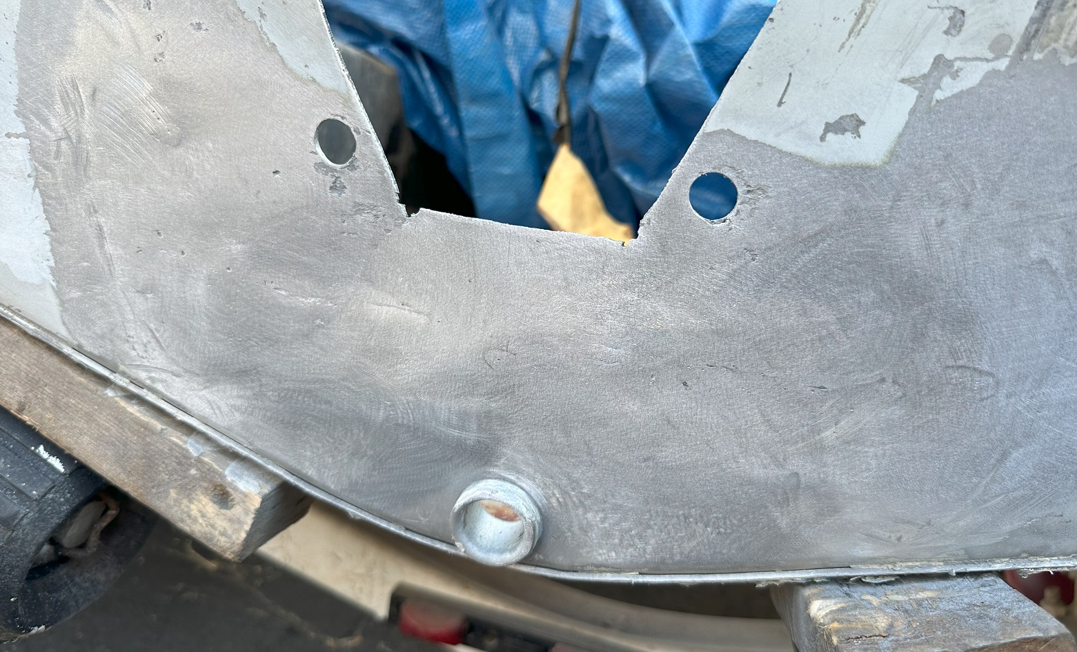

This is the weld on the right bottom side.

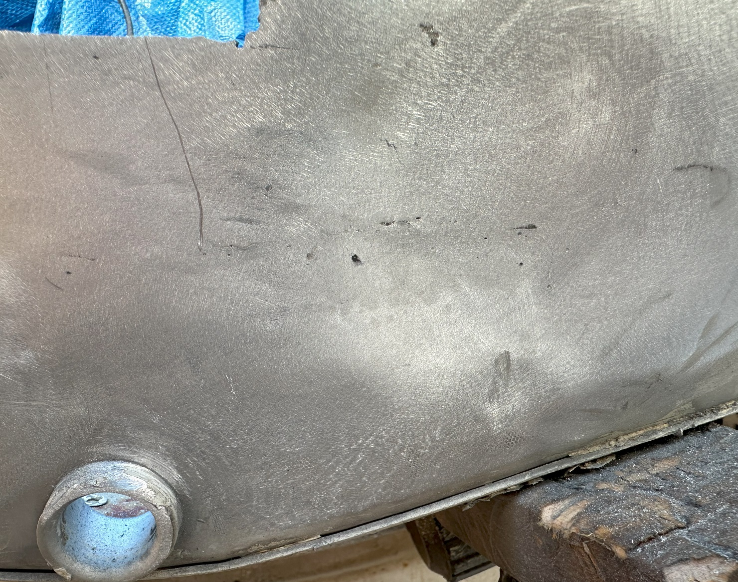

One more photo coming but it won't fit on this post.
Let me know what you think. I notice there are some shallow pits and a few low points. Not sure if I should be worried about that.
He did strike it many times with a heavy metal hammer trying to expose any fine cracks that would be forming. So I feel like it's a pretty strong weld.
Is there anything I can fill those shallow pits with before paint, or should I just cover it with high build primer?
I plan on painting the boat, but I was considering a short wet test on freshwater for 15 minutes before I paint. Is that bad? Or should I paint before I do the wet test?
Thanks! I appreciate you taking a look!
Is there anything I should coat this with for the short term? Should I be worried about corrosion while that metal is bare?
Not sure if its worth worrying about like the flash rusting on steel.
looks ok...
on the shallow pits, I would fill them with epoxy, especially where the transom plate gasket will go.
as for paint, I think sooner is better than later...just use a good aluminum primer and paint...in this area, you usually get what you pay for.
