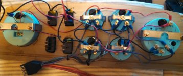

Drill holes in new dash panel for gauges(have)
See if i can free up the steering cable. Its stiff but turns fully both directions. It is the cable for sure, not the steering fork bushings
Install new gauges(have)
Make holes for new Rocker style switches(have). Had broken toggle switches.

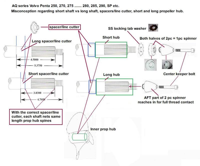

Well, let's talk about the shaft length again.
The 250/270/275 style shaft is indeed shorter.... and the 280/285/290 style is indeed longer.
However, we don't concern ourselves with that, because when the correct spacer/line cutter is installed, each nets the same length of usuable splines, etc.
In other words........ without the correct spacer/line cutter on the prop shaft......., no prop (short or long hub) will work correctly.
So... in essence, it doesn't matter in terms of short/long shafts.... until you consider that the 270 exhaust outlet won't allow for the Large Prop, nor is the prop shaft threaded for the spinner center keeper bolt that is required for the long hub prop.
Your 280 prop shaft will allow for either length prop hub.
However, with a long hub prop, you must have the 2pc spinner, in which case only the AFT section of the spinner is used.... along with the center keeper bolt.

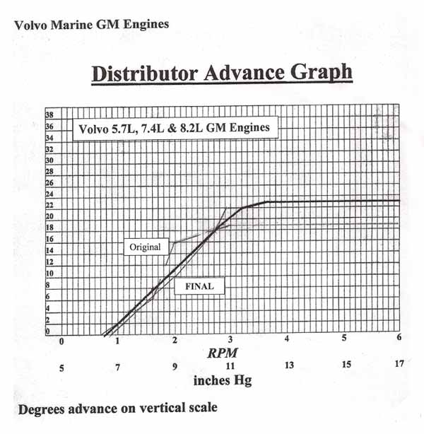

When you time the ignition system, be sure to look at the progressive and total advance.

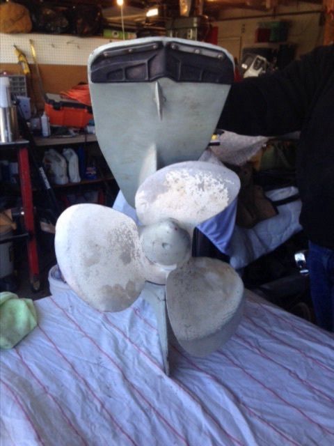

So i'll just order the same style as what i have. But i dunno if the one i have is long or short? Can you tell from the pic?

Might be needing to post this in the electrical forum?
The tilt toggle switch is looking pretty out of place with all the new gauges and rocker switches i have so im wondering if i can replace it with a rocker switch that operates as (on) off (on) and a led for the light?
Well through research i answered my switch question and i went ahead and ordered a 15X17P LH prop.
I can't tell from the image whether your have a full spinner, or the AFT section of the 2pc spinner.
With a long hub prop, the prop shaft splines will be recessed within the female splines of the hub.
This does not leave us with enough shaft threads to secure the full spinner nor propeller to the shaft.
This means that the AFT section ONLY of the 2pc spinner will reach in and will accommodate for the recess.
Since the prop shaft splines are recessed, the SS locking tab washer is left with ZERO to attach to..... so, the center keeper bolt must be used.
With a short hub prop, the prop shaft splines will sit "proud" of the female splines of the hub.
Therefor the full spinner, or both sections of the 2pc spinner, will work.
Since the prop shaft splines sit "proud" of the female splines, the SS locking tab washer keys into the splines, and the tabs are then folded for the "lock".
Therefor the center keeper bolt is now optional.
I cannot emphasize well enough of the importance of this.
Its a full 1pc spinner. I ordered a long long hub.
I have no way to check the advance curve and no one around here can do it that i know of. I can tell you the weights are not stuck and move freely as they should and the pins they mount to are in good shape as well as the weights.
Its a full 1pc spinner. I ordered a long hub.
That will work, but you'll need the aft section of the 2pc spinner and center locking bolt.
If up for the task, your balancer can be marked off (see second image at bottom).
Then as you strobe the timing marks (as engine speed is increased), you will be able to see the mechanical advance.
You should be seeing a fairly linear curve until the "full-in" rpm is reached.
Keep in mind that the vertical scale DOES NOT include BASE or Initial advance.
BASE/Initial is simply a result of the housing's position before any mechanical advance RPM occurs.
However, as you strobe the timing marks, BASE/Initial will be seen as part of the over-all advance as engine speed is increased.
(Example curve only)
attachment.php
This will allow you to verify it. Hopefully all is good.
GREAT info and the prop pic is the best explanation i have seen by far anyplace!
Send money to bank account XXXXXXXXXXX! ;):D
Pat, over the years I've seen way too much misinformation regarding this.
Even by Volvo Penta techs, and prop shops. :eek:
Once the idea is explained, and once a person see the parts needed, it's fairly easy to see.
Thanks Ricardo.
Just a question.
I cruze ebay for Volvo Penta stuff often and i often see lower units listed with a gear ratio. I thought all 280 lower units were the same and the transmission had the different ratios
Am i misunderstanding?
Thanks Ricardo.
Just a question.
Yes, you are thinking of the Mercruiser A drives.
The lower unit determines the ratio.
Jeff is correct! If we stay within the AQ series drives, the over-all or final gear reduction is determined by the lower unit gears.
However, there is one exception to this, and that is with the Diesel "E" drive.
The E transmission reduction is a tab bit greater, allowing (for example) a 1.78:1 Duo Prop lower unit to offer an over-all or final gear reduction of 1.95:1.
(the 1.78:1 DP gear set is slightly stronger than a 1.95:1 set..... and this is how V/P gets to it)
So all 280 transmissions are the same?
In terms of gear reduction, yes!
Heck thats nice to know. I have seen some transmissions sell for a affordable price but with the listed wrong gear ratio for my V8. So maybe a spare is a good idea!
1..... I have seen some transmissions sell for a affordable price but with the listed wrong gear ratio for my V8.
2..... So maybe a spare is a good idea!
1.... Pat, it's quite common to see the Volvo Penta parts listed incorrectly. Average Joe seller just doesn't know what he has.
2.... I've been doing the AQ series repair for 23 years or so.
Each of the older drives have what Volvo Penta has called a PZNR number. This is a serial number plus a ratio ID number.
The number is good ONLY if someone has not changed an upper or lower unit.
Transmissions ending in the alpha character "B" were to be found behind V-8 power..... 1.61:1 overall reduction.
Transmissions ending in the alpha character "C" were to be found behind the inline 6 cylinder..... 1.89:1 overall reduction.
Transmissions ending in the alpha character "D" were to be found behind the inline or OHC 4 cylinder..... 2.15:1 overall reduction.
Of all the service work that I've done to these over the years, I see the transmissions behind V-8 power more so in need of Main Drive Gear bearings.
I rarely see the transmissions that have been behind smaller engines in need of these bearings.
The other two large angular contact bearings appear to survive very well!
Point being, if you do pick up a transmission for a spare, buy one with the PZNR number ending in the alpha character "D".
Or..... tear yours down, and replace the two main drive gear bearings and do a re-seal at the same time.
If these two bearings are good and are adjusted correctly, and if the seals are keep in good condition, and if the 30W drive oil remains clean, these will go for years and years without any trouble.
NOTE: we cannot simply swap transmissions from one Intermediate housing to another, nor swap lower units from one Intermediate housing to another, without going through the shimming procedure.
This is a critical procedure that must be done!
Back to post 105.
Turns out the gauge set i ordered has a volt gauge. Did not even realize that. My old gauge was a amp gauge.
Going to be working on wiring all week i think. Just seems to go slow when your figuring it all out!
Ok So i tried my new long hub prop on and it hits the little trim tab. I notice it is off set a little bit where the bolt attaches to it.
I assume it is just a simple matter of turning it around so the short side is near the prop?
Also i wonder if anyone can post a pic of there 290 lower unit exhaust outlet. Top, Side and bottom. For my little flapper conversion.
The short side is supposed to be FWD.
Someone has installed it incorrectly.
http://www.marinepartseurope.com/en/volvo-penta-explodedview-7744020-44-17980.aspx
Nice. It should be easy to turn it the proper way and should clear then.
More looking for actual pictures as i like the squared off look of the newer drives and with a few good clear pics i might be able to recreate it on my 280.
From the pics i can see on Ebay it looks it can be done with a little patience bit i need some clear pics of the actual unit to start with.
Oh Almost forgot. Here is a pic of my new dash. Almost done:cool:
Still have a little wiring to do on the boat. Hope it is just plug/play easy.

When i added new gauges and switches for the tilt i used a (on) off (on) momentary switch and 1 LED for the light. The LED comes on when the drive is completely down.
Is there a way to add another LED to come on when the drive reaches the full up position?
