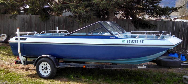

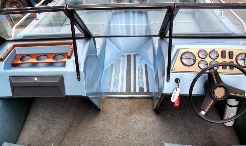

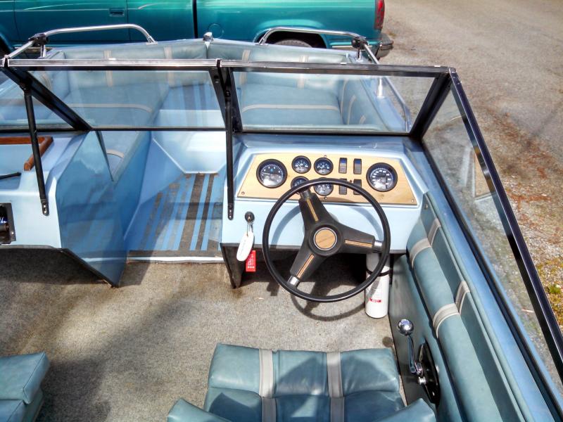

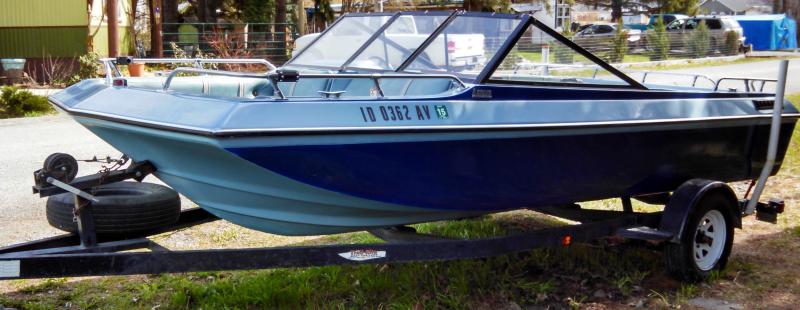

OK PICTURE TIME!!!!
This is what we have been working on over the winter. Its still dirty and the back seats are out but its basically done.
Had it at the lake today for about an hour and all worked fine mostly:cool:
3 Small issues
The Quadrajet does the Quadrajet bog so i need to adjust the secondaries but the rebuilt carb works fine other then that and a little tuning will fix it.
The shift cable needs adjusted
Prop seems like it needs more pitch. It is 15.5X17P cup. I ran it at 3500 rpm(checked with boat tach and hand held) and got 32mph. Forgot to check gps so that's what the boat speed'o said. WOT was 4400 right on the spec but i do think it will still reach 4400 with more pitch
I'm thinking a 21P would be more for me. I don't pull skiers. Just race from one fishing hole to the next!

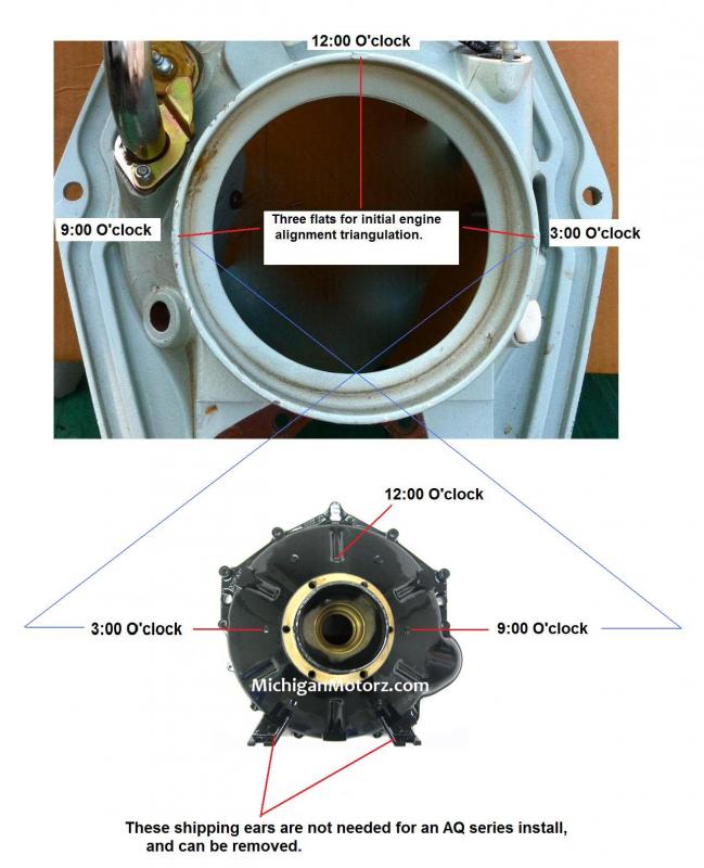

Do Volvo Penta 280 drives need alignment? I have searched and can't seem to find any info about it but can find a tool that says fits Merc and volvo.
Reason i ask is. I discovered the two big nuts on 1 motor mount are lose and are about 3/4in lower then the other side. I raised it up so its even with the other side but after thinking about it, it may have been the wrong thing to do?
Pat, yes... there is a one-time-alignment that must be done each time that an engine w/flywheel cover is being R&R'd.
This involves a triangulation procedure.
If your engine mount stud nuts became loose, at best you'll be guessing at the height adjustment.
To do this correctly, you'll need to remove the transmission, loosen the clamping ring bolts, and start the triangulation procedure from scratch.
The goal is to achieve equal distance or space between each set of flats in three locations........ 9:00, 12:00 and 3:00 O'clock.
You'll be using the engine mount stud adjustment to change the dimensions.
Once equal distance/space is achieved at all three areas, you'll tighten the clamping ring bolts.
Thanks Ricardo.
With the transmission removed could you explain where to measure from with the drive installed? I can't visualize where i can measure from 3 equal destance spots.
Actually think i figured it out.
Loosen the 6 bolts, Measure from the inside of the red thing to the center of the drive shaft and adjust motor mounts until its centered in the hole then tighten it all back up and recheck. Do i have it right?
Pat, take another look at my image.
I have drawn arrows pointing to each of the six flat areas. Three on the transom shield and three on the flywheel cover!
When grouped in twos, there will be three locations.
9:00, 12:00 and 3:00 where 3 of them will correspond to the other three.
When the distance between each of the two corresponding flats (three areas total) are equal, you are in alignment.
This is Triangulation!!!!
I guess im not understanding totally.
Waite. Maybe im thinking the wrong way. Am i trying to center the drive shaft in the red part where the aft pds bearing is. I measured there and its so close i cant adjust it any better then it already is.
OR
Am i needing to center the bell housing to the transom shield?
OR
Pat, the primary driveshaft is fixed geometry… There is no changing that.
You will be centering the flywheel cover into the transom shield using the triangulation process, via the three measuring points.
The goal is to obtain an equal squeeze on the two rubber cushion rings creating a good seal.
