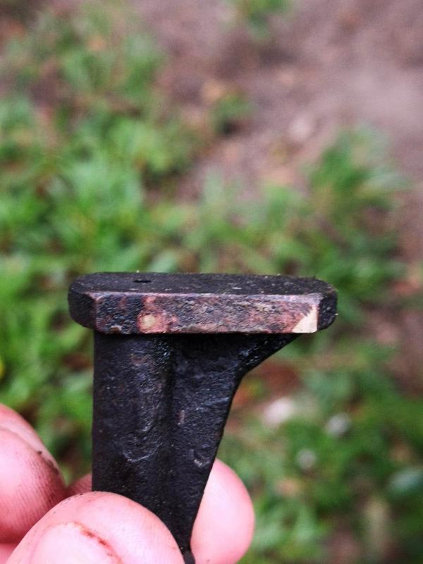

If the U shaped part has slop and the slop is excessive then the bronze part is more than likely worn.
Also the U can get bent if the drive was not in forward gear when it was attempted to be removed.
Some people will try to pry the drive away from gimbal housing
This can ben out the U and/or scrape away part of the bronze part square edge..if the edge is not square and severely rounded it will not shift correctly.

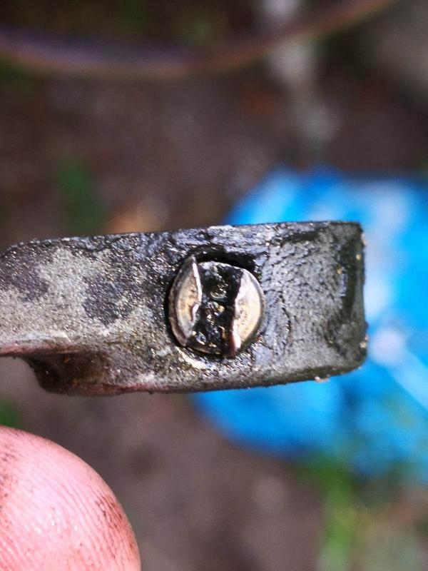

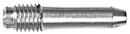

See pic for screw type,
Threads are 10-32
Material is stainless steel
Difficult to drill out if you cannot get it out as is................but can be done, carefully!!

My advice at this stage is to,
1. Replace bronze piece, I did not like all the slop/play in your earlier video.
2. Remove and replace that screw-pin at wheel part if you can.
If you cannot remove the pin then a new vertical shaft and wheel assembly and screw/pin will need to be replaced as you may have to CUT the shaft to remove.
This is rare but not uncommon.
Is that the screw coming in from the side?
Yes, a slotted screw. Very difficult to remove after being in there for years and more difficult when someone else has messed it up.
When I have replaced them I grease them up good so if they have to be removed it will come out. They are not greased normally and the dissimilar metals between the wheel part and the screw cause a corrosion bond absent the grease.
If you can get it out, make sure you SQEEZE the slotted vertical shaft where the pin goes thru. That will also help in a tight fit. If that hole/slot in the shaft is damaged beyond use then the shaft will need to be replaced.
If you have a impact type screw driver that is what may be needed to get that screw loose.
I have broken many slotted screw tips when trying to remove this screw!!!!!!

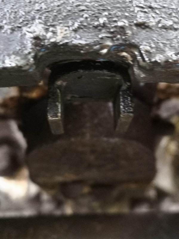

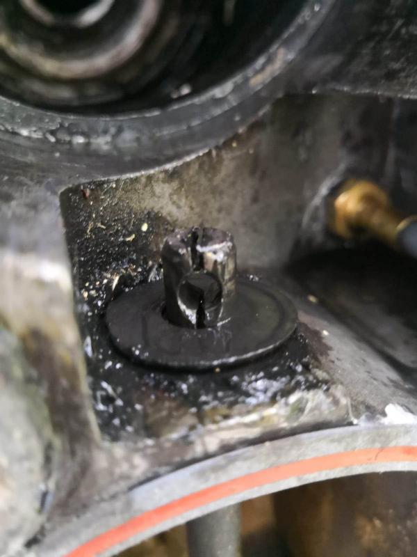

I made a new video and some pictures :)

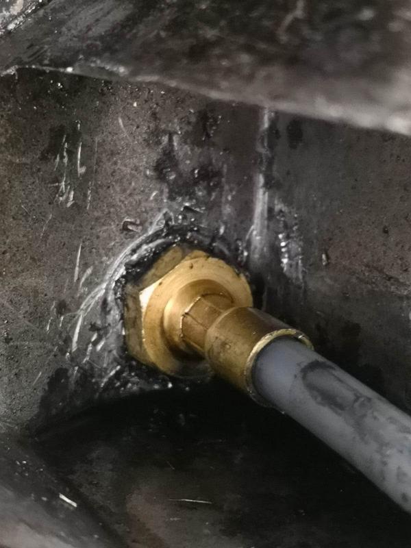

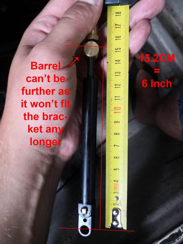

Also this is a problem. The below picture is taken when I had the drive on and in forward gear. I could push the cable even further in and this is what happens. The 6 inches is not even possible to adjust to...
Here are some extra photos

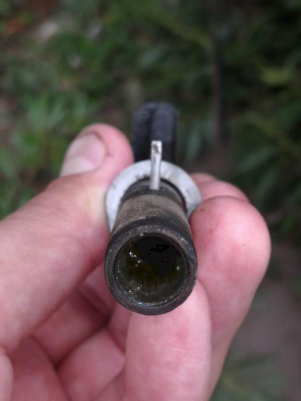

Questions,
1. The cable end that wheel fits into. Why does it look used. You said you replaced the cable? The cable kits give you a NEW one.
2. On the bracket side of the shift cable, the plastic end,
Did you feed the inner cable core all the way thru and into the small round hole until it hit the top of hole and then tightened the pinch screws?
3. REPLACE THAT PART WITH THE WHEEL. It is very worn.
4. Replace the Bronze part. Just because I said so.
5. Buy new wheel to shaft screw so it is new!
6. Lets focus on 2. And see where that leads.....
Its clear this observation was missed earlier....
What ever is wrong there is not normal.
Explain what you used as a cable replacement????
Something isnt adding up
Questions,
1. It is new but I tried to unscrew the white plastic with some pliers which wasnt possible on this cable. My old cable was simply screwed in.
2. Yes 100%

I got both forward and backward gear working again!
The shifting arm at the upper (U-shaped) shifting rod was loose because the flat screw that holds the arm was not tightened. This gave the system too much slop. Now it is still a close call as I was forced to move the adjustable stud on the shifting bracket all the way up to make it work. I will order a new replacement arm (and roller) just to be sure and maybe counter some extra slop!
