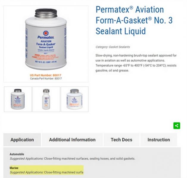

I have yet to do what you are doing but I have used this product for my thermostat housings on both engines and not a leak anywhere and the temp does get to 160+F.
Maybe someone can advise if this stuff is only good for "non'vertical/angled" parts or not

On my Barr replacement pieces, I removed the manufacturer's paint from the machined surfaces, wearing rubber gloves, with a rag and solvent. I think I used acetone, but it might have been lacquer thinner. when assembling, I used Permatex #3 on the gaskets that came with the hardware, and they have been holding up fine for the past two years.
After paint removal, run a file across the face of the manifold and elbow. A couple passes will tell you if the mating surfaces are flat or not. I too use the Permatex Aviation #3. Usually the surfaces are pretty good, but, I've seen defects that I was glad I had taken a file to. Prep is everything.

Perfect Seal is the quicksilver version of GM's GP gasket compound which is functionally equivalent to Permatex #3. I've never seen any restrictions on the parts it is used on installation angles....
The need for sealer is driven by the gaskets used....old plain gaskets usually benefit from some #3; newer coated gaskets usually don't need any sealer.....
Either way, the surfaces to be sealed need to be 'flat & parallel' for the gasket to work.....
