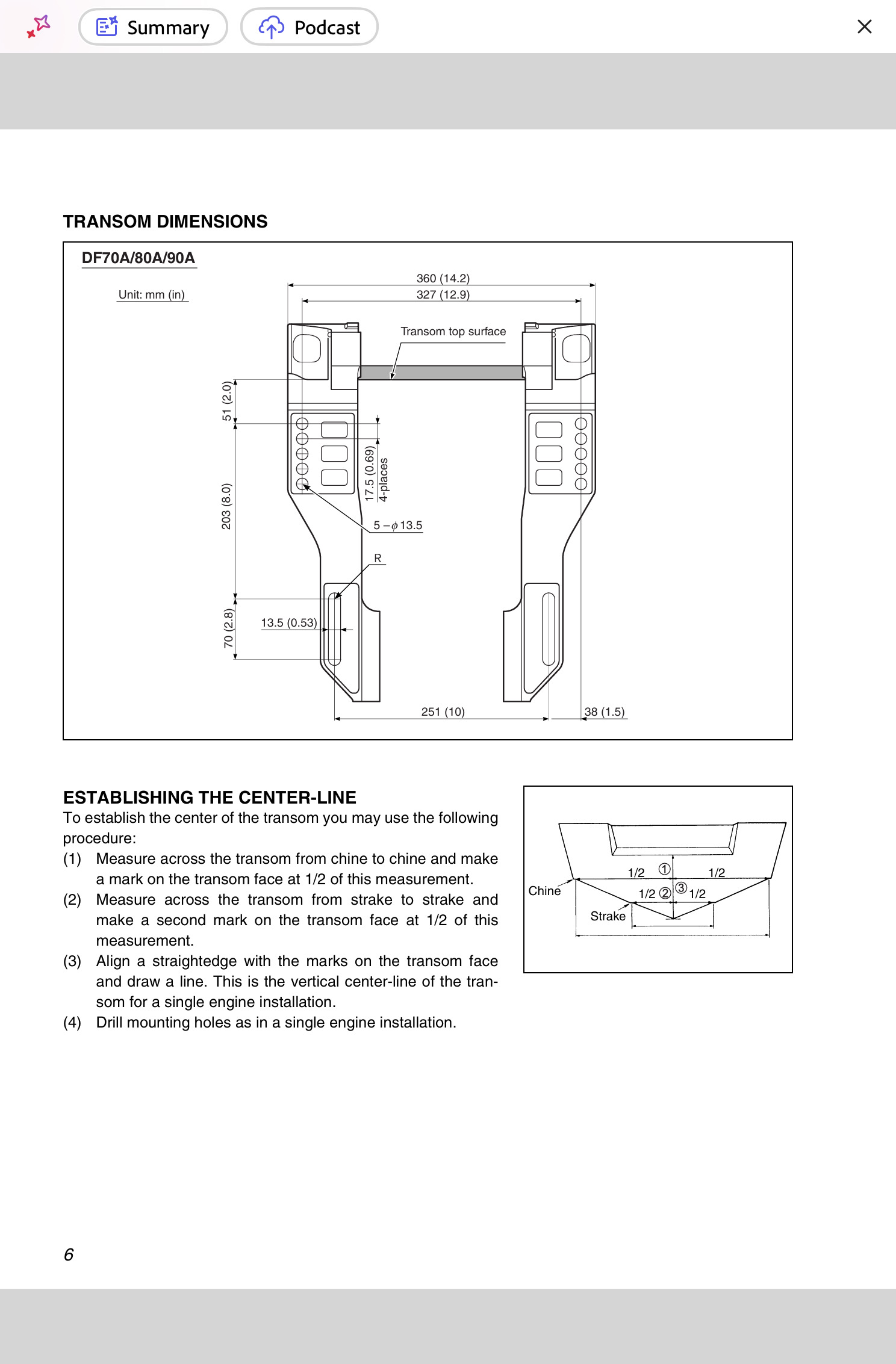

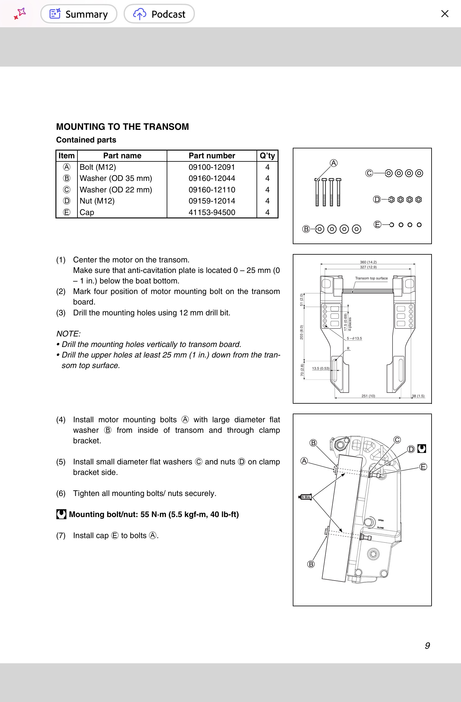

I'm stuck on exactly what size bolts I need, I know it's M12, but beyond that there are two dimensions that are not clear to me:
What is the actual hole size in the motor bracket? I'm assuming it's more than 12mm to account for the unthreaded shank of the bolt.
How deep is the hole in the motor bracket, so I can account for getting the correct length bolt to go through my transom.
My transom is 1/4" thick with a 3/8" doubler plate where the engine sits, so total 5/8" transom thickness. Just trying to figure out the bolt size and drill size I need to make sure I can get this mounted without being angry.
The screen shot below are from a 2009 DF90A Installation Manual from Suzuki. I found it on the internet about 10 years ago. I have no idea if it would apply to a new engine. One would assume your new engine would come with an Installation Manual unless it’s something Suzuki supplies to dealers only?
