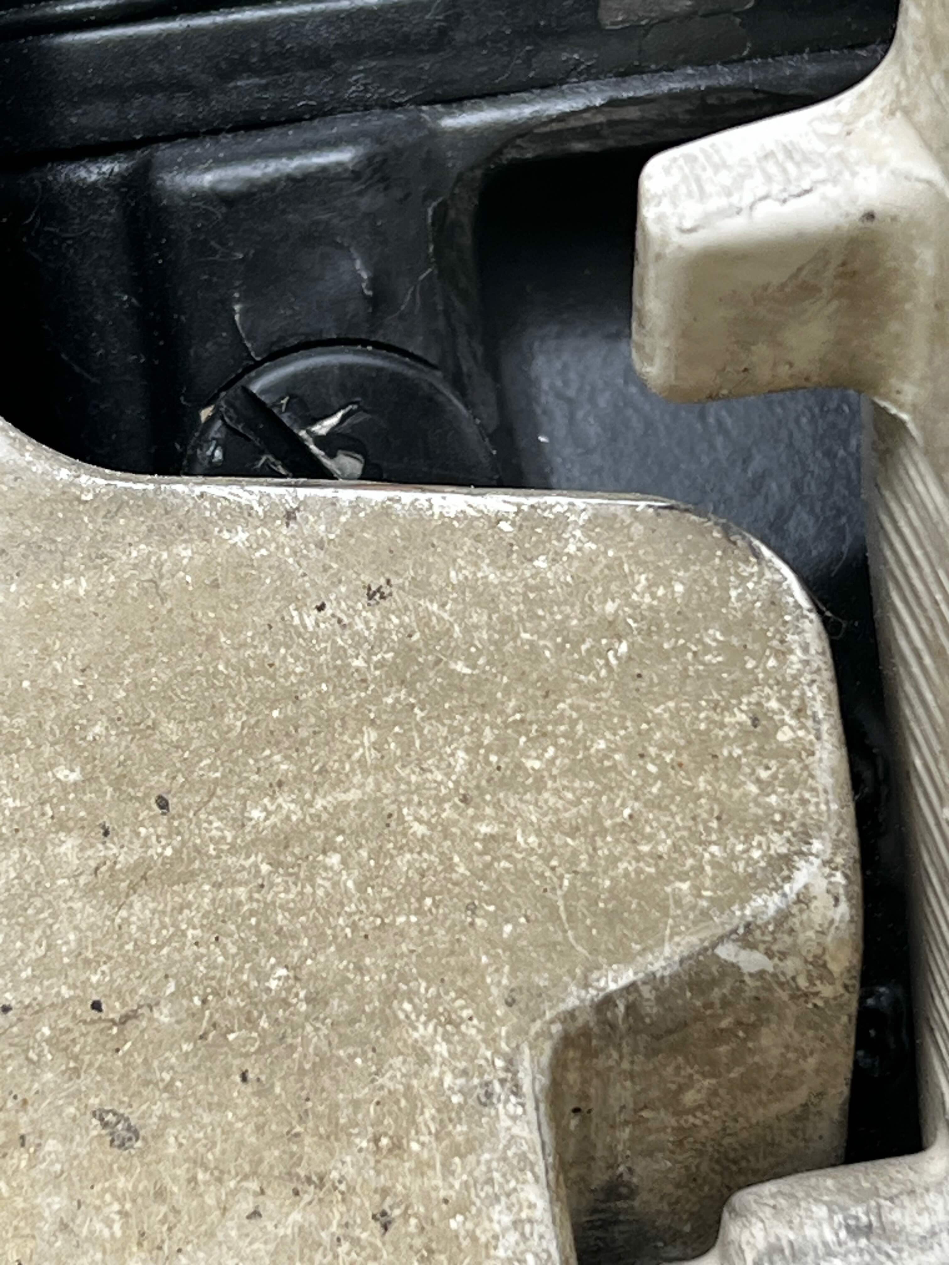

This is the fill screw, I believe. It is restricted from being removed by the engine mount.

I have the same issue. The motor can be titled up further than what the trim control buttons allow. You need to unscrew the relief screw on the side of the tilt pump (it’s inset quiet a ways and should be marked) this will allow you to push the motor right up, almost to horizontal and then either brace the moto or flick the trim cam down to lock it in that position. This should give you enough space to remove the fill screw on the side of the reservoir to fill it until the fluid bleeds out. Put fill screw back in, then screw the relief screw in, let the motor down, cycle it up/down a few times and then repeat the process again to ensure you’re filling the pump and lines fully.

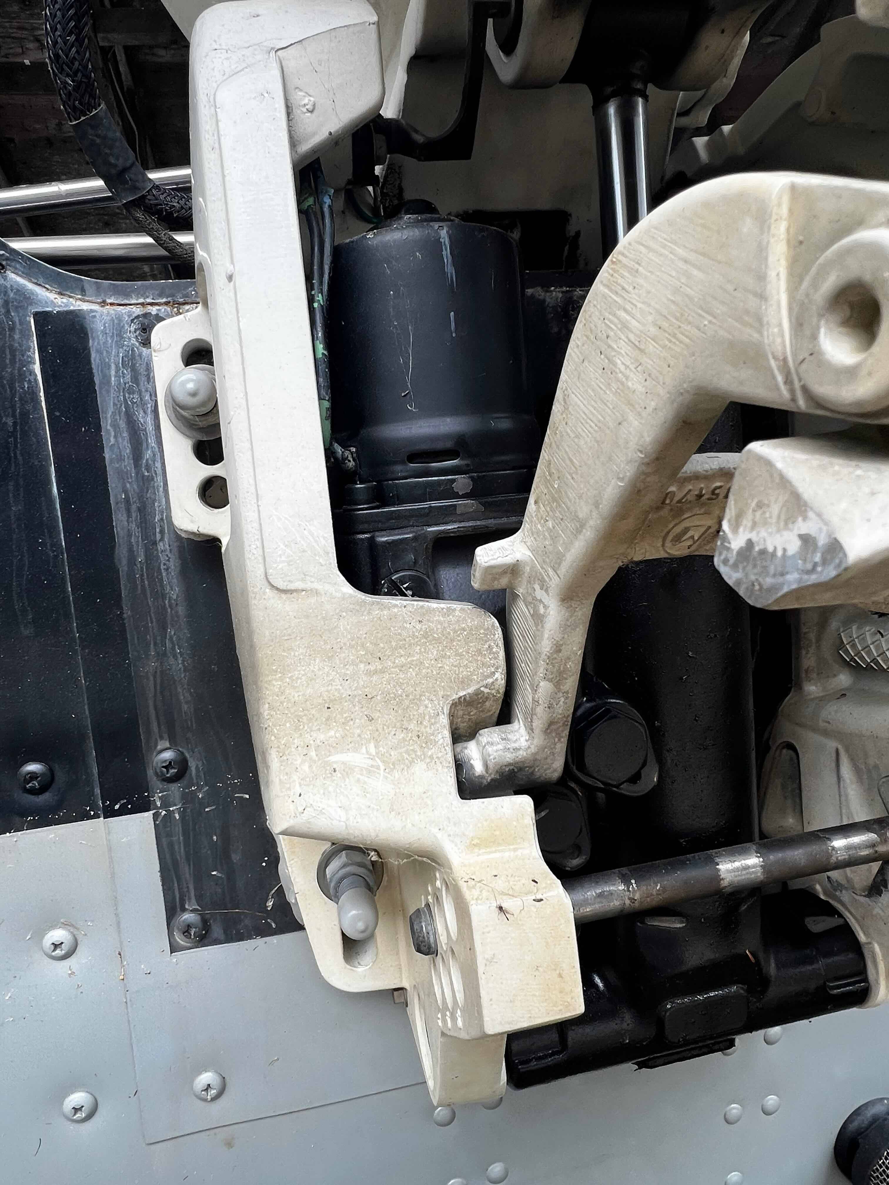

Is there a solution for a seemingly inaccessible trim fluid fill screw cap? With the motor fully tilted up..bracket engaged, the motor mount obstructs access to the cap for servicing. Suggestions?
