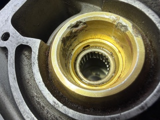

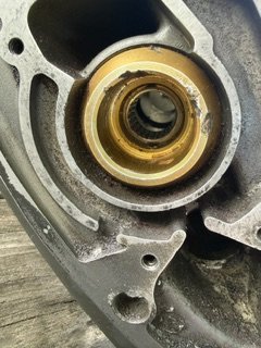

Currently working on resealing the lower unit on my 1991 Mariner 25 MLH. After removing the driveshaft seals I found corrosion and marring on the gear housing sleeve. Service manual states not to remove the sleeve, which I take is it’s not replaceable. I’m curious if this is repairable or if I should start looking for a new lower unit. If the sleeve is not replaceable, I plan to continue with the reseal then pressure test and hope for the best.

Install new seals wet with Permatex 80017 or 80019. Same stuff, different size containers.
Hope for the best.
