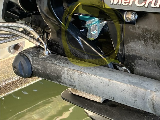

2014 StingRay, 5.7L, Bravo 3 - got a bad leak of gear oil external to stern drive. See photo. Appreciate feedback, never had this problem. I am sure an expert will know what this is all about. Thanks.

Check the transom plate gear lube fitting and hose going to the drive.
No the transom does not use oil.
Since I don't know your serial number, I've picked a generic image. Most likely your boat has the style in the upper left box, fitting #6 and/or hose (#12 is bulk piece used inside & out of boat), the portion shown as "S" shaped buried between bellows & outdrive.
