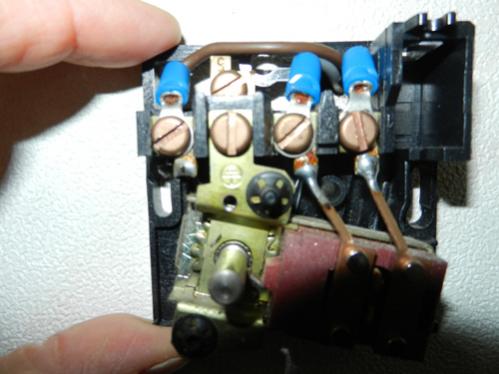

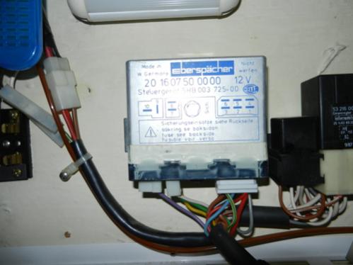

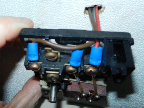

I seem to be making some progress. I installed a long jumper from t-stat terminal 4 to control unit terminal 11, and this allowed me to start the heater. Now it's time to actually troubleshoot.
Jumping terminal 4 to 6 gives one long blink and 3 short, indicating "safety time exceeded no start". (Actually, this happened once, and now I seem to have entered some sort of ventilation only mode, where the blower comes on, but nothing else tries to start. Is there anything I could have done to stop if from trying to heat?)
