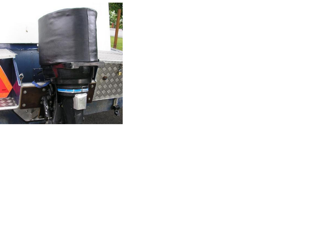

Really interesting!
Next step?
Maybe!....but if it blocks your ability to hear the noise, does it also block the ability for air to enter those additional muffler vents????
