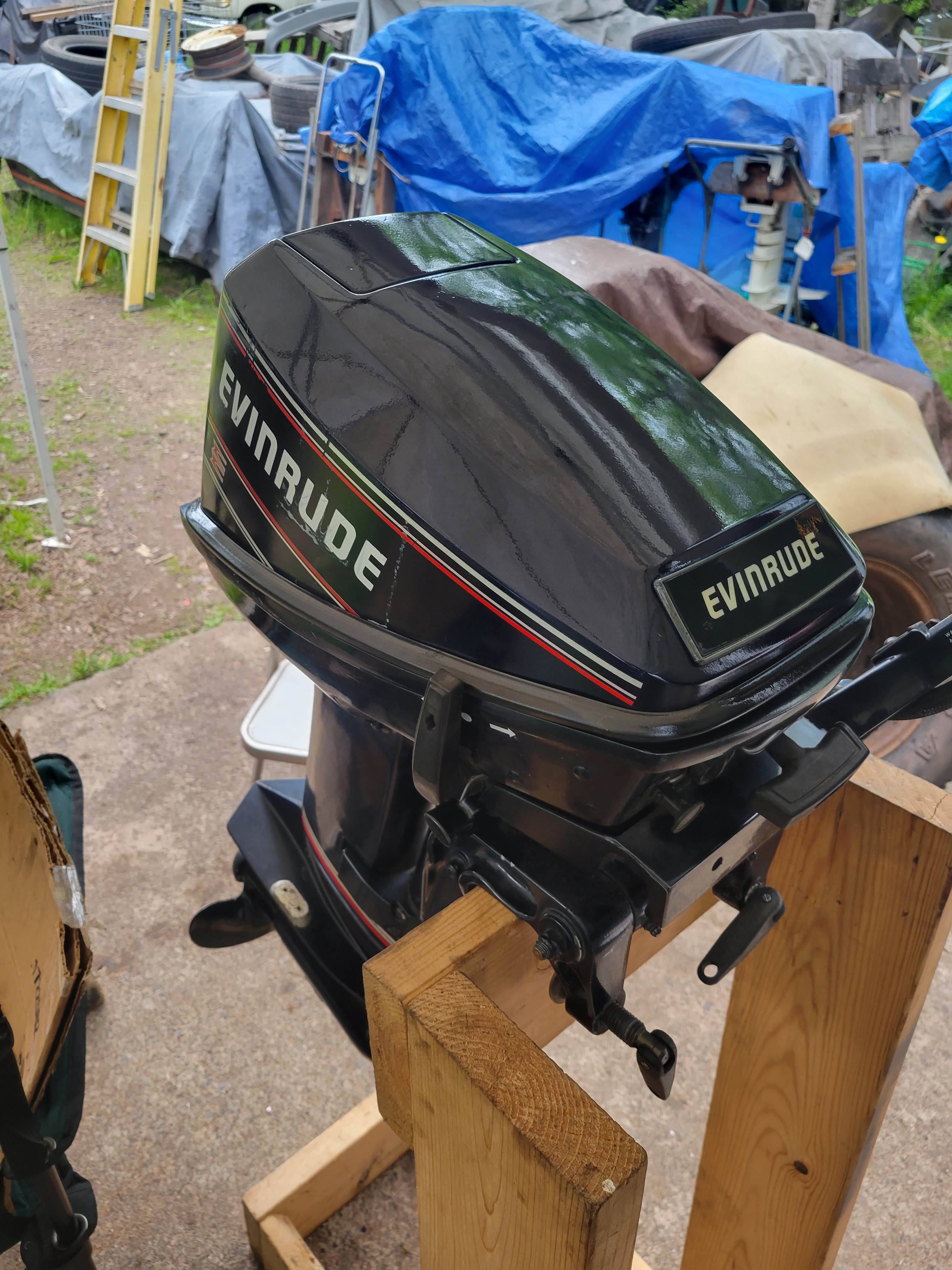

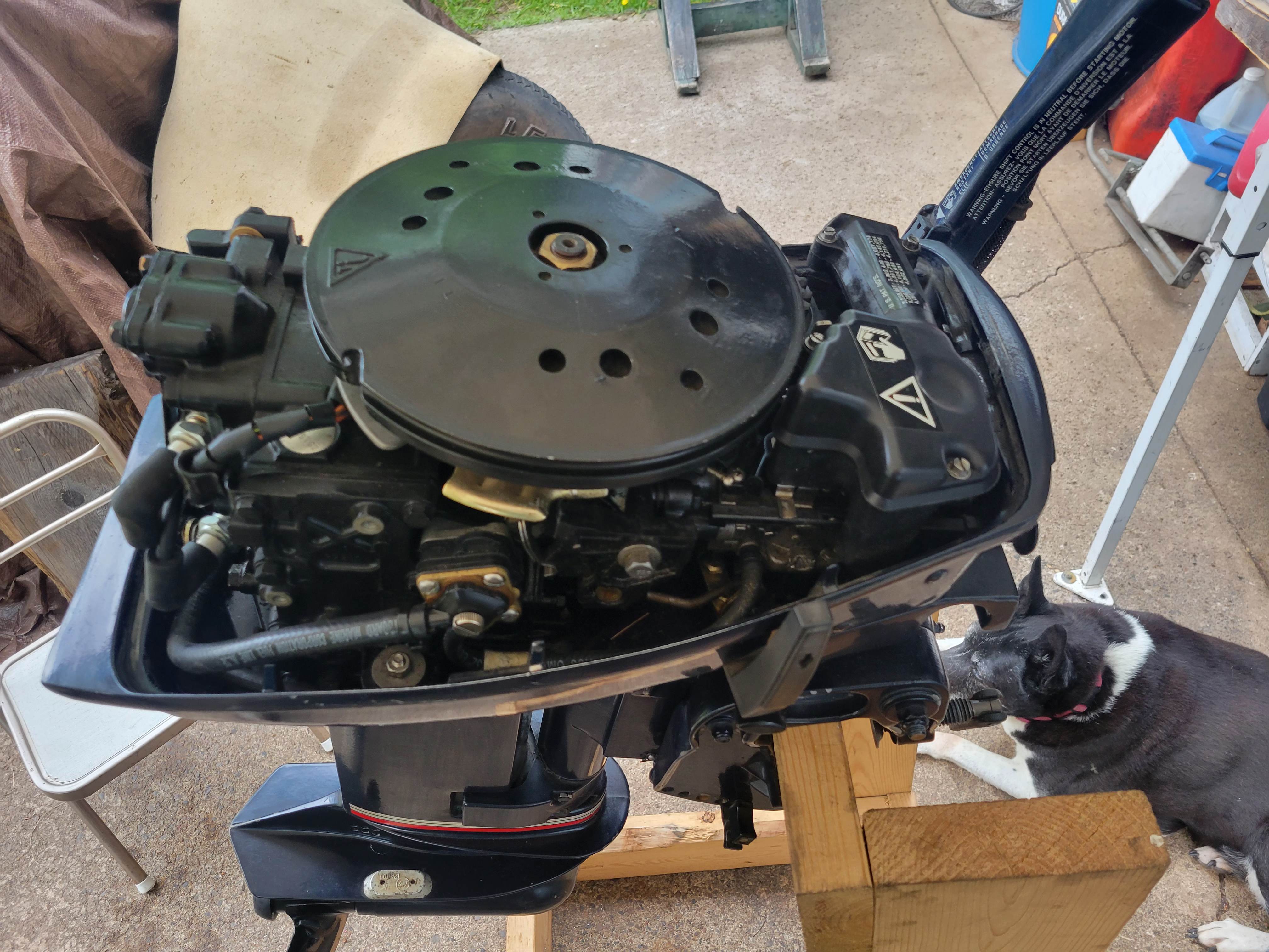

Yes, I agree. I still sell a lot of the 9.9 to 15 horsepowers and often get upwards of $1,000 for each motor with a one-year warranty and nice steel fuel tank. I just sold this 92 short shaft manual start in mint condition for $1,500. There is probably not a better fishing motor that has ever been made. And yes that includes Yamahas, as I just spent 2 weeks waiting for parts for a customers 8 HP Yamaha 2 stroke.
