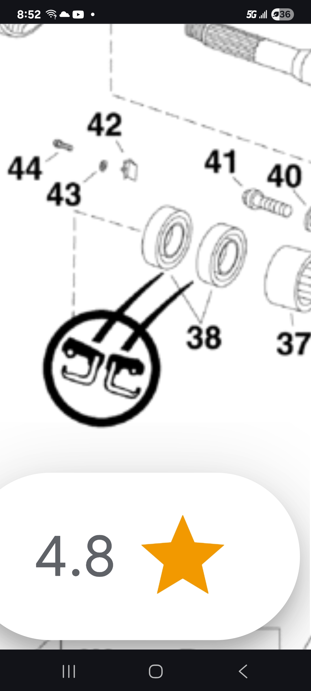

If it truly is gear oil, how does the shaft surface look where the seals ride? Installing the seals like this?

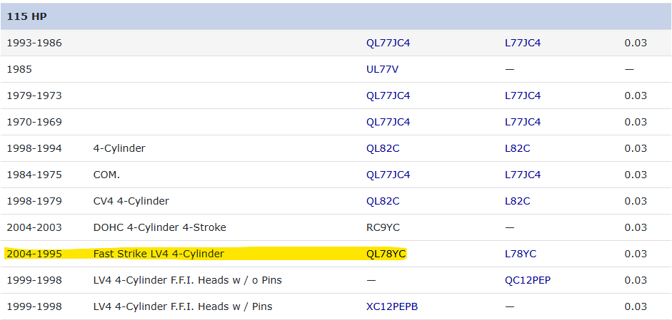

Agreed, likely normal 2-stroke exhaust oil. You could possibly have weak spark due to worn spark plugs. Make sure you have a fresh set of properly gapped Champion QL78YC spark plugs in the engine. Do not substitute other brands of spark plugs, the OIS 2000 ignition is very sensitive to RFI & MFI noise and the Champion plugs meet the specs exactly.
Also, I'm pretty sure 2004 was the last year for Johnson 2-stroke outboards.
