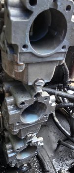

Dropped and adjusted. It'll go into reverse now I feel i might be a tad bit off still. I did notice quite a good bit of fuel coming from my carbs though.
No idea how its getting like that. Took it out yesterday and she wouldn't go over 10mph. Gonna recheck the compression and tear into the carbs.

If there was water in the tank, it's been pumped via the fuel bulb into the carbs. And the fuel line may be full of a wster cocktail too.
Remove the airbox if you did install it & remove the drain screw at the front of each carb. Pump the bulb until you get clean fuel, not the cloudy stuff as shown in the picture.
It may take several pumps. Perhaps a quart total assuming the fuel in the tank is clean.
