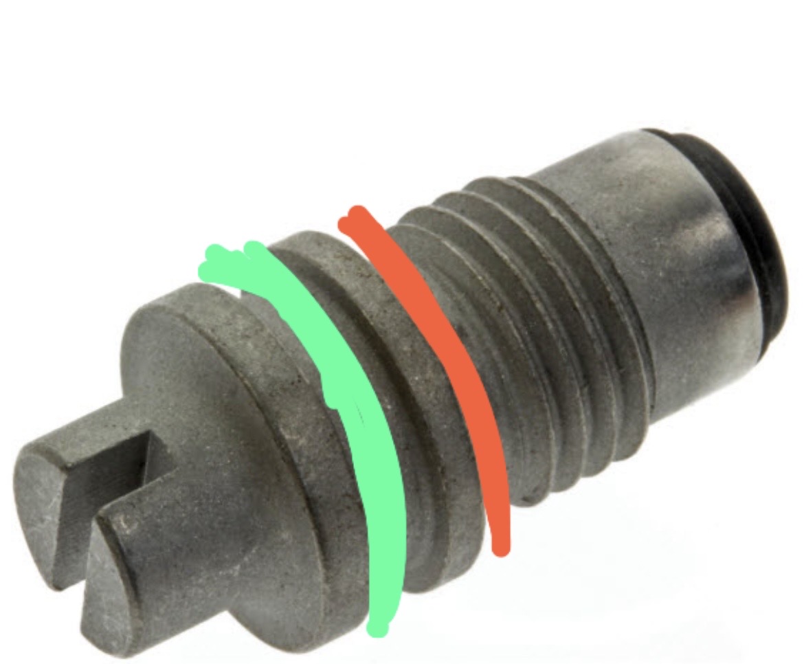

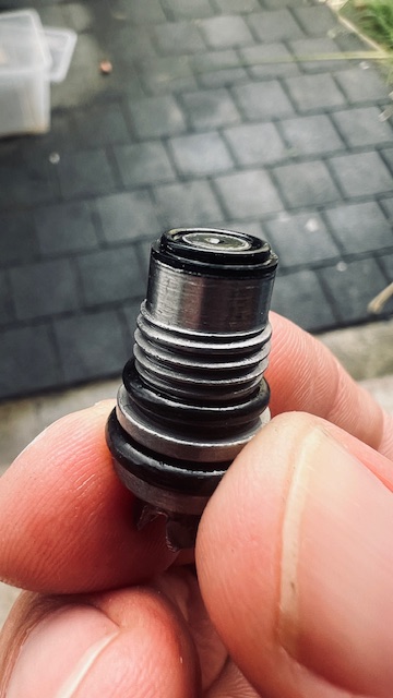

  • even if I close the relief valve (hopefully completely, but it feels like it) and the refill-screw on the power trim unit, I am able to manually move the outboard up and down... does this tell me, that there is now pressure in the system?
  • Is the seal in the right position (it took the one right where the screw begins off already) on the relief valve and is it big enough (again because of lack of pressure in the system) - or where does the seal go?
  • how much fluid goes into the cylinders? I lost quite some fluid when taking out the relief valve
Maybe someone can help? I would like to try everything, beforeI start changing the whole rods/seals in the cyclinders

Thanks @Droid.
Actually took the relief valve out again and switched to a smaller o-ring. That did the trick.
The power trim works fine now. đź’Ş
