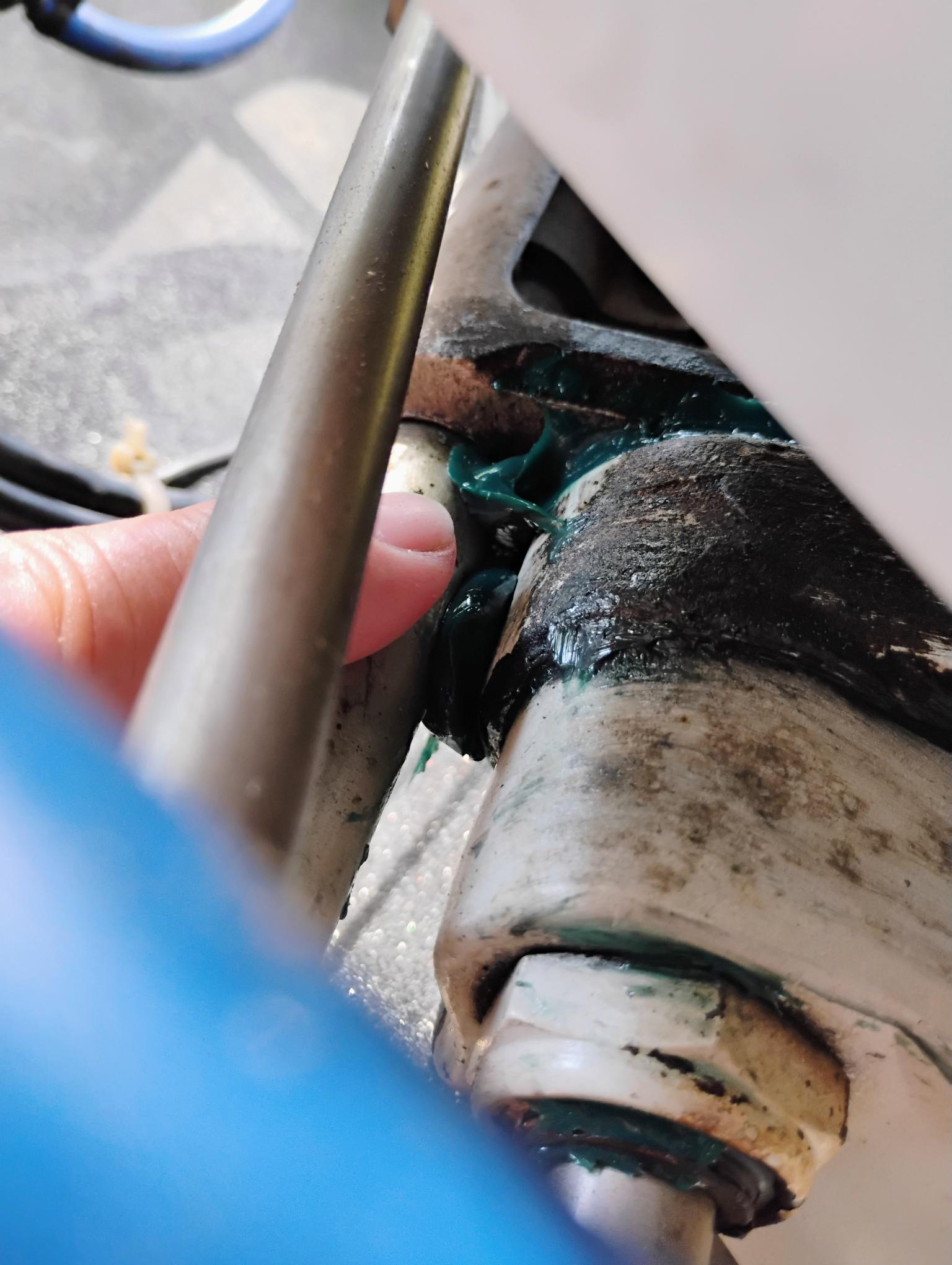

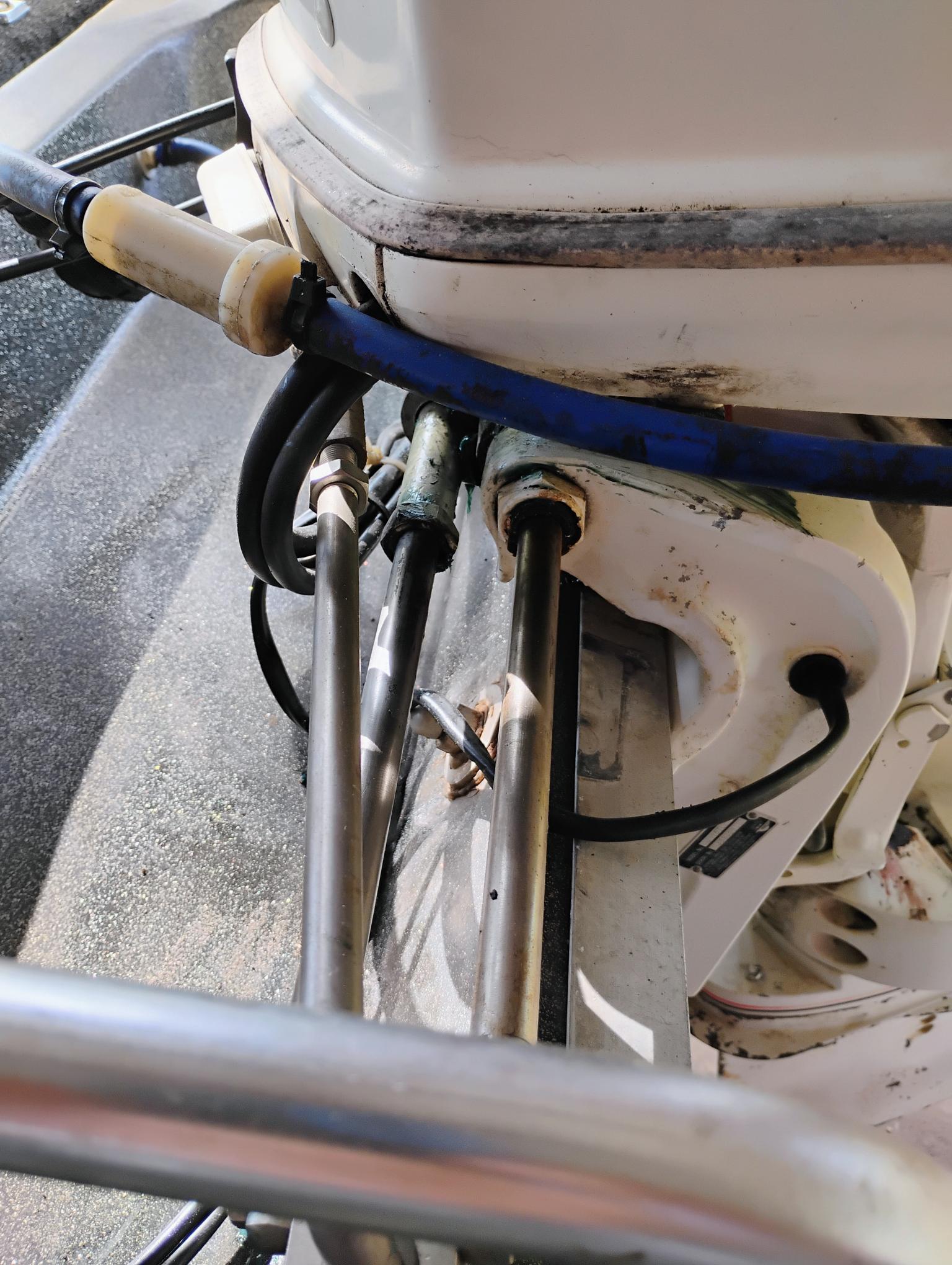

Hello, I am doing some maintenance on the steering system on my 1983 Johnson 115 hp motor. I have two steering cables that connects to two steel rods that connects to the rod that turns the motor from side to side. Only the housing for the back rod which is the closest rod to the motor has a grease fitting. I can't see how grease gets to the front rod because the housing for the front rod doesn't have a grease fitting and the front housing for the front rod and the housing for the back rod doesn't seem to be interconnected. Can someone tell me if/how grease gets into the front rod housing. Also, I put grease into the back housing fitting for the back rod until grease came out at the seams. I turned the motor side to side several times, but the steel rod is still dry. Should the rod have grease on it since I put grease in the housing, and I turned it side to side? There is a nut, (visible in the attached picture) on the outside of the housing that the rod goes through and that nut may be cleaning the grease from the rod as the rod moves through it, not sure, just guessing. Should I put grease or a spray lubricant onto the rods? I looked online to see if I should do that and there are mixed comments about putting grease or a spray lubricant onto the steel rods. Some people say to do it because it will help the motor turn easier, and others say don't do it because it will attract dirt, grime. Attached are two pictures, one of the grease fitting where I am pointing to it with my finger, and the other picture is of the two steel rods that connects to the steering cables.
The grease fittings are for the tilt tube on the motor.-----A thin smear of grease can be put on both rods.-----That second cable was an option for light fast boats.
