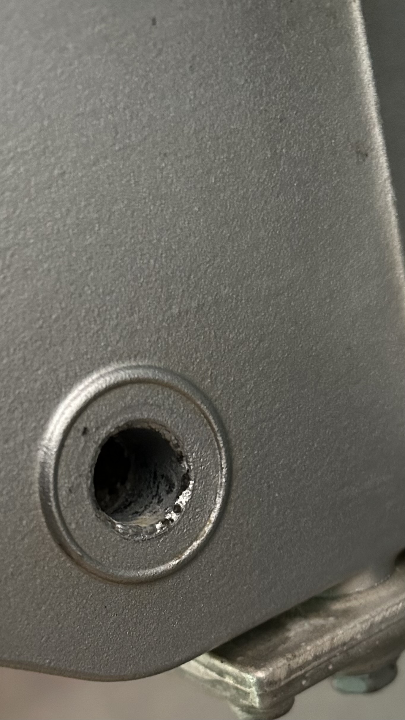

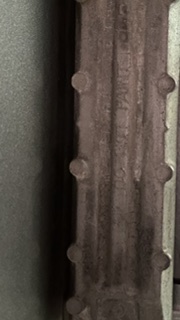

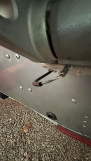

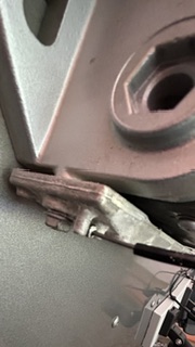

Hello JGMO
Thank you so much for that info..#1 my outboard is a 2016 BF115D had it since new. I maybe have 50 hrs on it my electric troll motor has probably 1000 hours on it so I go to show you. I don't use the outboard all that much, only from Point A to point B. i maintain it faithfully. As far as the Anode they is a slight discoloration but it's not pitted at all.. wire it still looks brand new.. but I am going to get a new Anode kit even though they don't look bad at all, I know they should be replaced sometime for time.
#2 I took the upper cylinder pin right out. It was in perfect condition. Still had some grease in it, but I greased it. Lower rod bolt i removed left side was fine but right side there was very slight corrosion it wasn't any powdery form most look like it was dried up white lithium grease but maybe it was corrosion cleaned it up loaded it with grease.. i did notice very slight play going up and down not sure if that's normal or not. After all that the noise stopped goes up and down smoothly no noise whatsoever but that #10 bushing I love to replace. Sure I can remove that bracket but wouldn't i need a hoist to keep the motor from even dropping down, this is something I'm not equipped with.

I managed one photo the other three doesn't download

Well, in my opinion, you don't need to worry about the zinc, wire OR those bushings. 50 hours is almost nothing for these as long as it's on a trailer and not submerged in salt water on the back of a boat.
It also sounds to me as if you've taken care of your concern with a little clean up and some lube.
