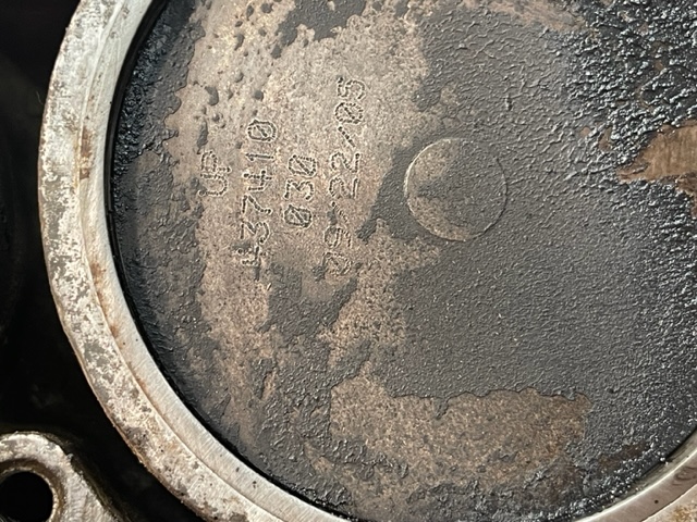

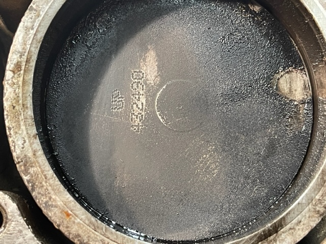

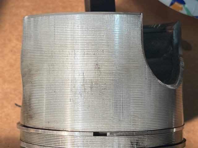

Hello everyone! RC1 Tear down complete here are some pics. Piston tops

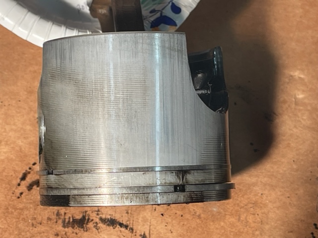

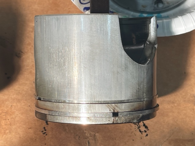

Piston skirts

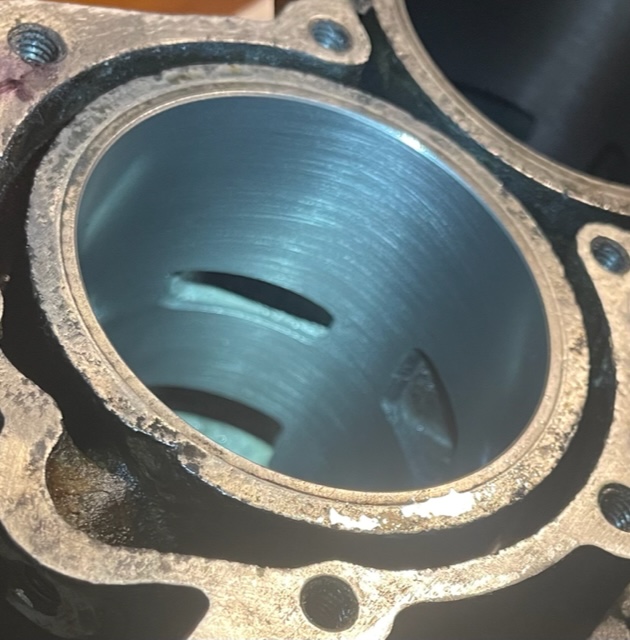

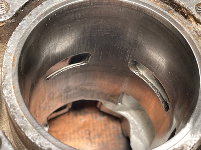

Cylinder bores

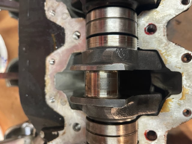

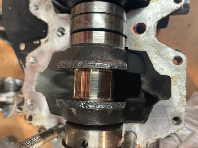

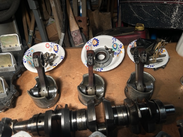

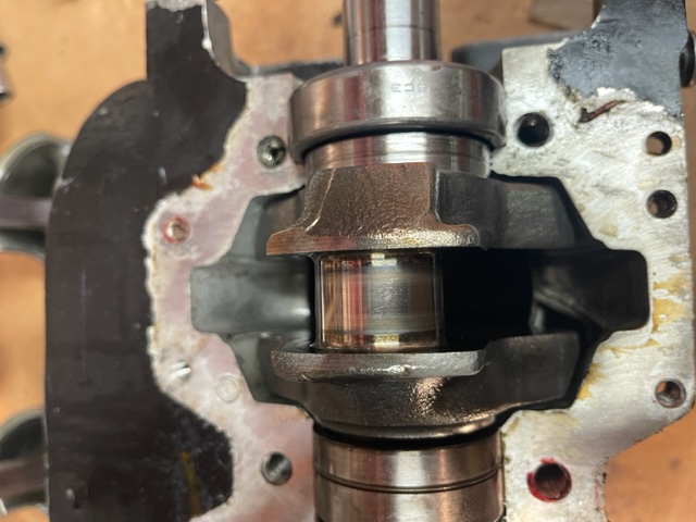

Rod journals
No broken rings and main bearing looked ok to me. However every piston has different numbers and apparently #3 is .30 over which didn’t surprise me due to the damage on the head. I noticed the piston also has the date stamped on it too. I wonder if need to pop a ring off and see what the gap
is.
I don't think breaking a ring will help you as it is unrelated to your problem. It would help to find out the point where you hear some very strange and loud noises.

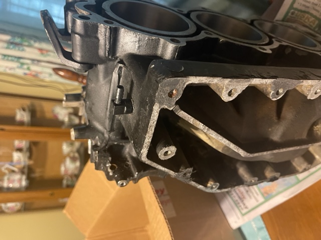

Update guys finally got the block back from the machine shop, after I measured the cylinders and found out 2 had been already bored .030 over and the other standard I decided to take the block to the machine shop. Well he double checked and verified that was the case and told me the cylinder walls were pretty scored and recommended boring all to .040 so that's what I did. Here's a pic of boring job. Bored than ball honed to chamfer the ports and put the hatch marks on the cylinder walls. Cleaning up next.

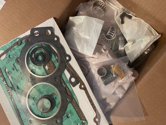

WSM pistons and gaskets seals and bearings. Ordered the different lubes from Crowley so I’m waiting on that now before I can start going back together.

So in the kit they sent caged wrist pin bearings not the 28 needle bearings I guess that must be an upgrade….you can see them in the pic above.
I always install the loose needle bearings.----The caged bearings are cheaper and will work I guess.-----And now you need to determine why this happened or it will happen again.------VRO checked out if still in service.----Tell tale hose comes off the top of the block ?----Latest water pump kit ??----Latest kit comes with parts and instructions for cooling system upgrade.

???---Compare the wrist pin diameter to the new pins in the kit.-------I would be installing the 28 needle bearings.-----And in my opinion the starting fluid had nothing to do with the scoring.----Unless it was used excessively and somebody did not know how to start this motor !----Bearing type has nothing to do with the WSM piston or 0.040" O/S either.-----The operation of a 2 stroke and the lubrication is much mis-understood !

The caged bearings are standard OEM on later 90's and up engines and work perfectly fine. Make sure you wash the block with hot soapy water. Run a string thru exhast port with piece of rag to clean all the boring/honing debris. Must be able to wipe cylinders and ports with white rag and get NO gray residue. The wipe down with a good spray lube. Also up the main jet 1 size at .040
Loose needles ( 395627 ) is the kit used as original equipment on 3 cylinder 70 in 2000.----Also used on the 2005 model 90 HP.
Thanks guys for the tips and info. I'll make sure to be critical about the cleanup on the block and make sure it passes the white rag test. I called WSM today and asked about the wrist pin bearing it's not a problem WSM P/N 010-140-01 same as Johnson/Evinrude 0395627. I asked about Caged versus the 28 pin and seems it's a preference issue.
