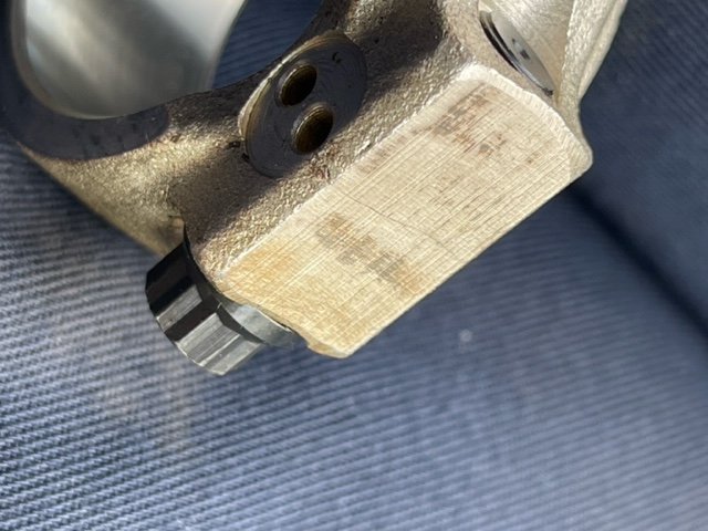

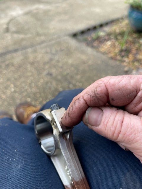

Another round of frustration! I want to say these rod caps are giving me fits but today I worked with just 1 #3. Even went to Walmart and bought a big magnifying glass that idea turned out to be worthless. Maybe I'm being to critical
Update, today I spent some time on #1 rod cap. I did all the usual things to get the cap to line up but again could not get it perfect not even on one side. So I pulled the cap blew the joints out with compressed air and gave it another go but still no luck. So at this point I took the cap off and bearings out and tried to fit the cap to the rod with nothing in the way, still more of the same it’s not perfectly aligned. I quit and covered it up and have decided to look into 3 new rods, that will mean another tear down. I wished I had checked the rods before I pulled them apart to see how they felt!
Here’s some pics of the number 1 rod and cap

Also this is not the first time the powerhead been into remember #3 had been bored 30 over. I wonder if the caps weren’t lined up back at that time?
I appreciate your bluntness and I can check with the shop and see if Mr. B will help out however maybe you have a suggestion or method that would warrant another try?
Factory new rods are listed at $270 each.-----And what if you have the same issue with them ??----Go find a shop to help you !!

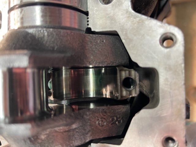

Update everyone,
I pulled it all back down, I wanted to do a close inspection of these rods and caps. I dry fit each one just cap on rod and you can feel the connection between the 2 pieces and you would think they'd be perfectly fit together however they are not. I have no other explanation other than to say it's my best guess that when the motor was previously built care wasn't taken to make sure the rods and caps were correctly fit and mating surfaces were damaged when they were torqued down. I'm in the market for 3 rods
Pics of the caps, crank and rods
<p>
Forgot to mention that the cap and rod on #1 were magnetized! The others weren't. Caught me off guard when the cap snapped right to the rod!</p>
Ok Anyone want to try and dry fit these rods and caps before I buy 3 new ones!!

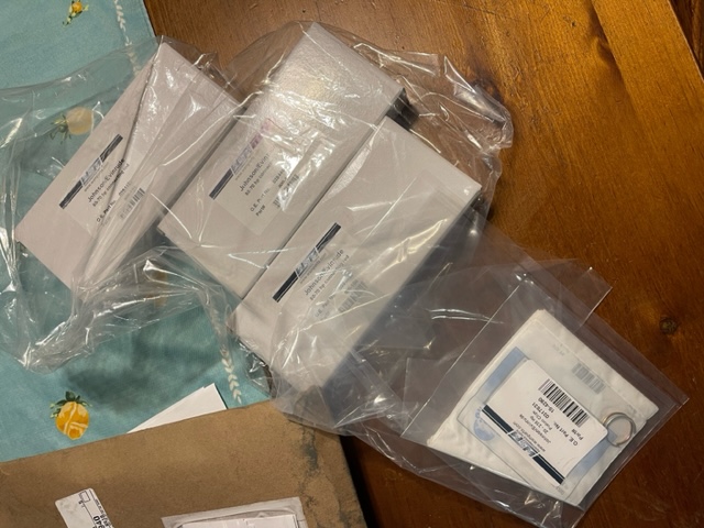

Just a quick update for everyone, I've ordered 3 new WSM rods and 3 new piston c-clips. Just waiting for them to hit the door so o can get back to square one.
