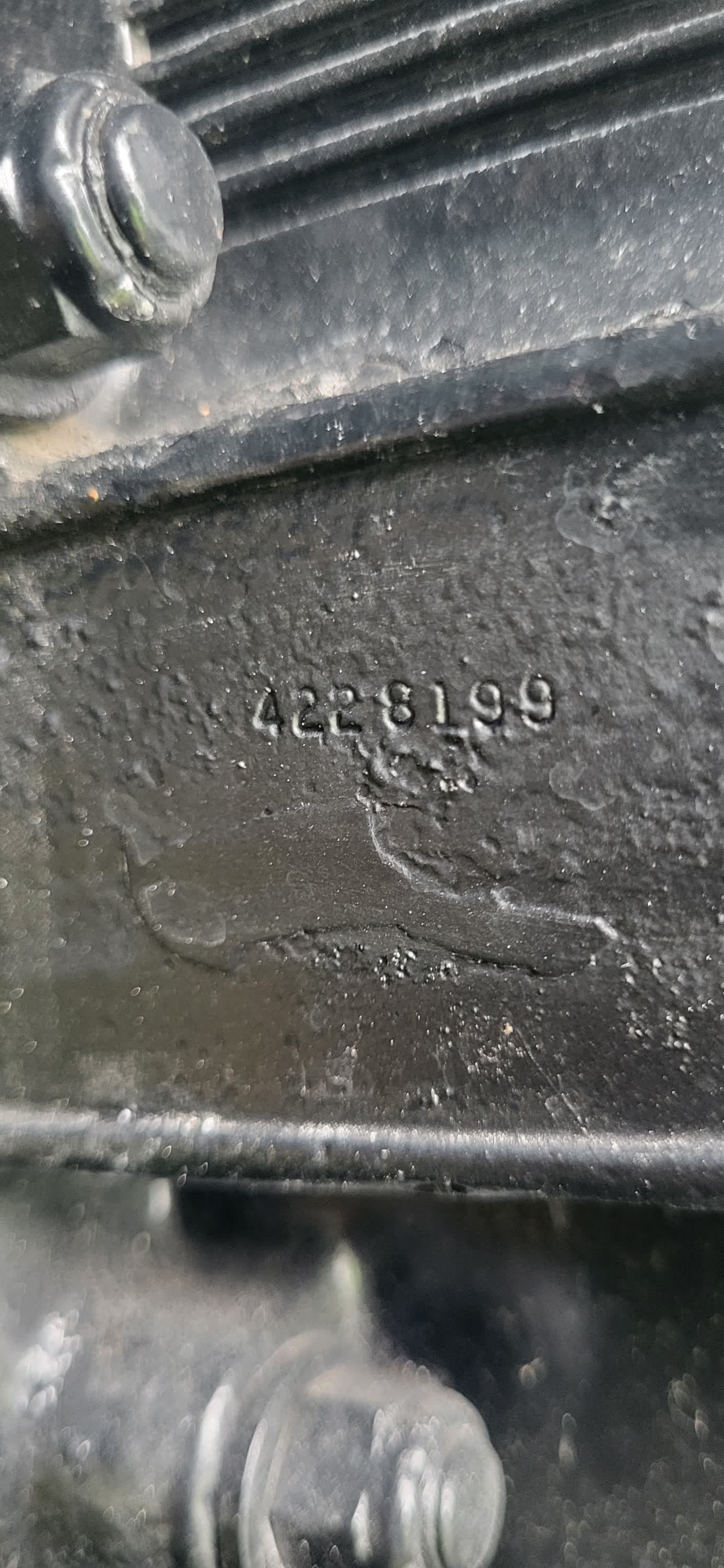

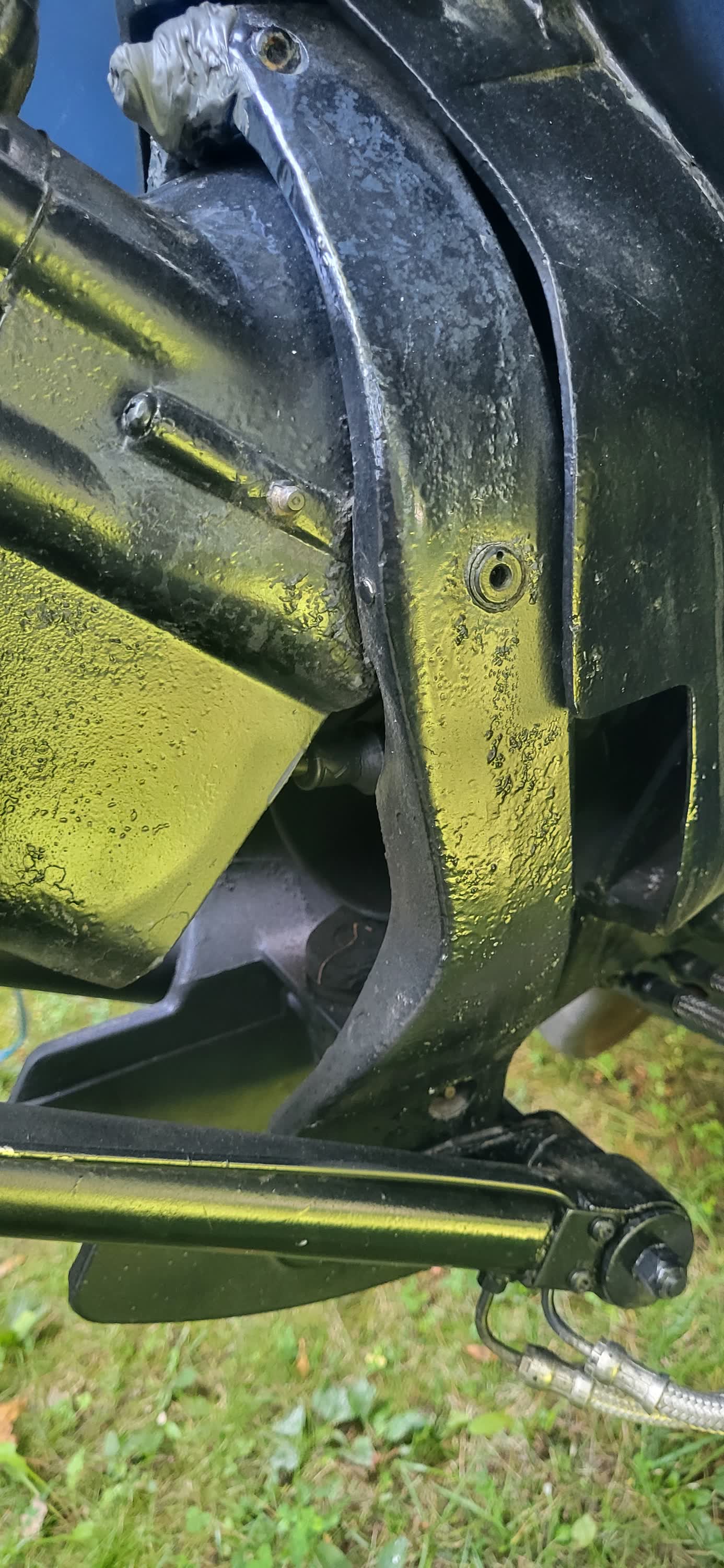

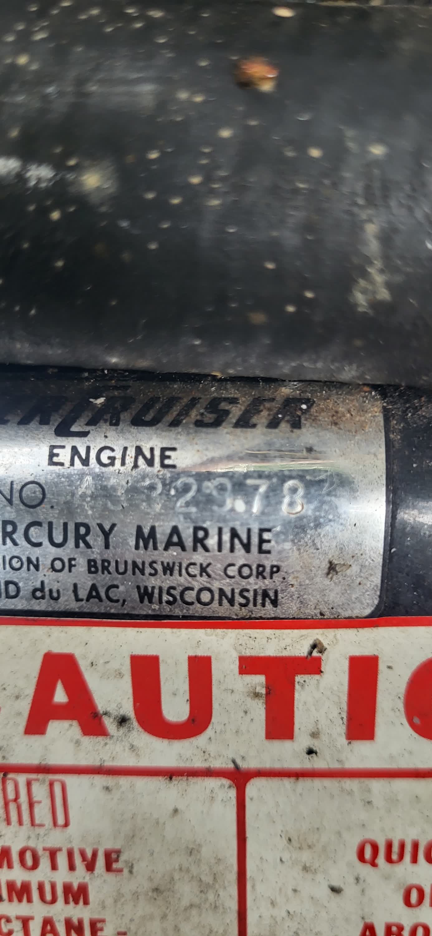

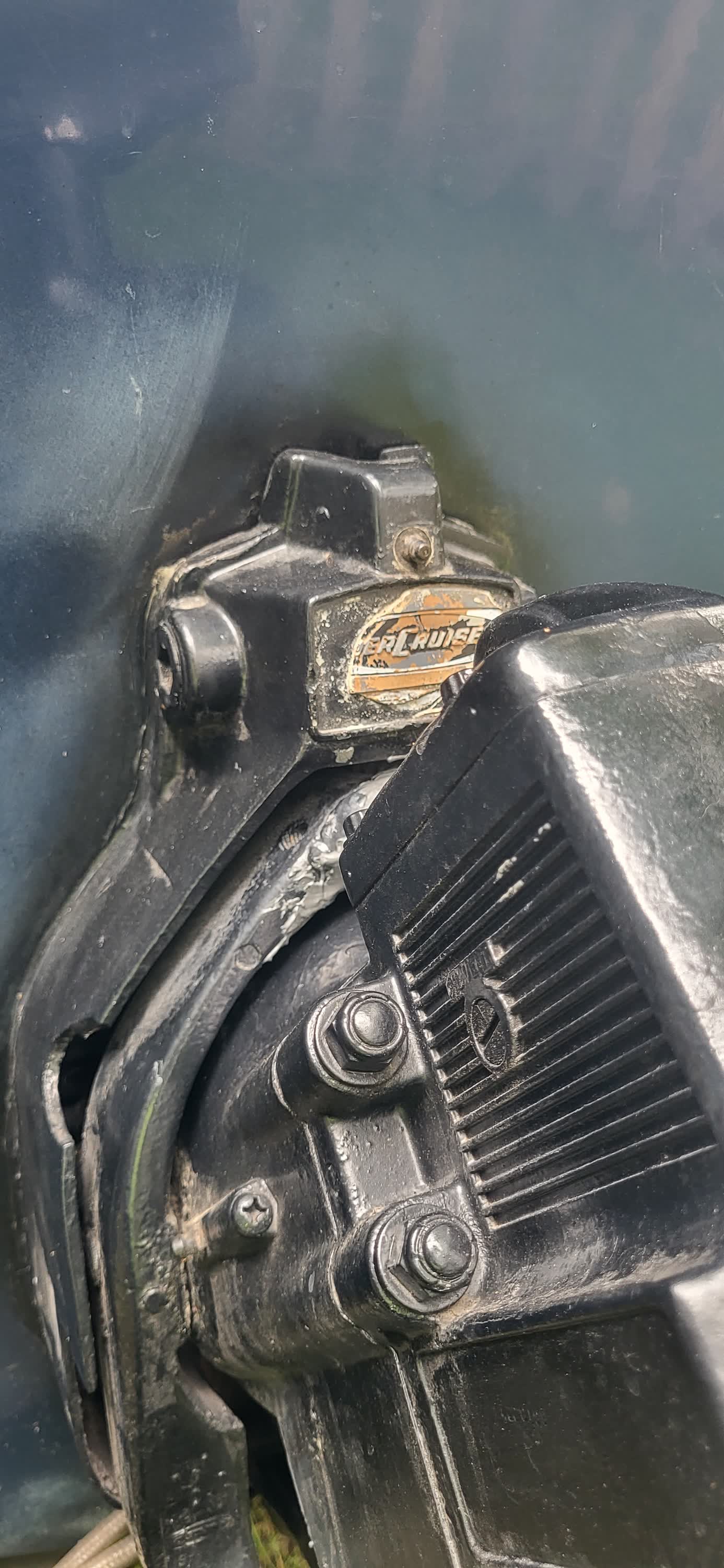

Here are some pics of what i have, the drive is missing its # i see a stamped one but dont know if thats just a casting#

Ok, so early nail type hinge pins.
No you CANNOT retro-fit an Alpha gimbal ring. You will need the earlier design, used from maybe '67 to about '74/early '75.

That 4228199 should be the serial number of the drive. It's located in the rectangular hollow (recessed area where Mercruiser decal was once located) just below the 2nd nut in the last picture?

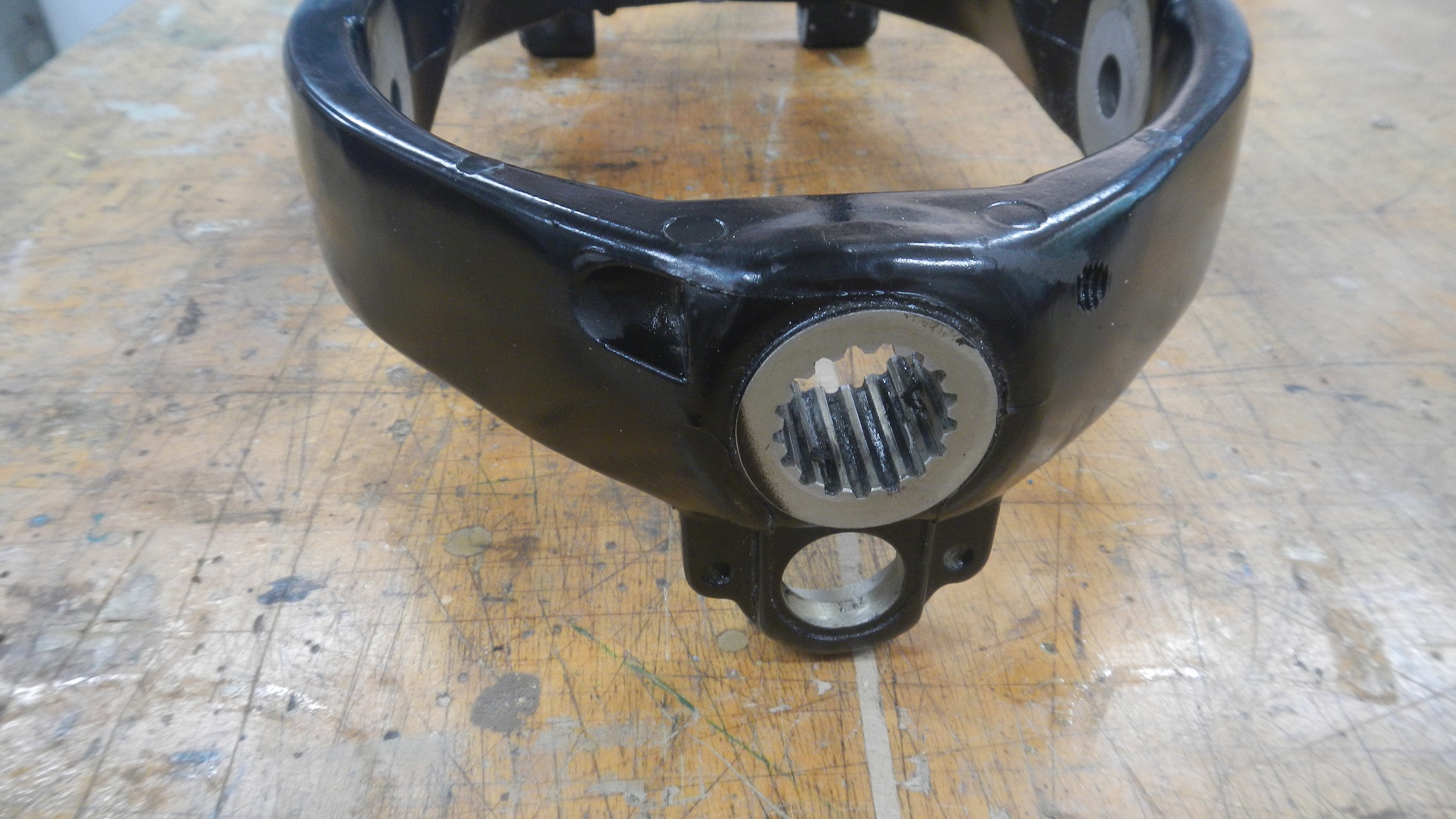

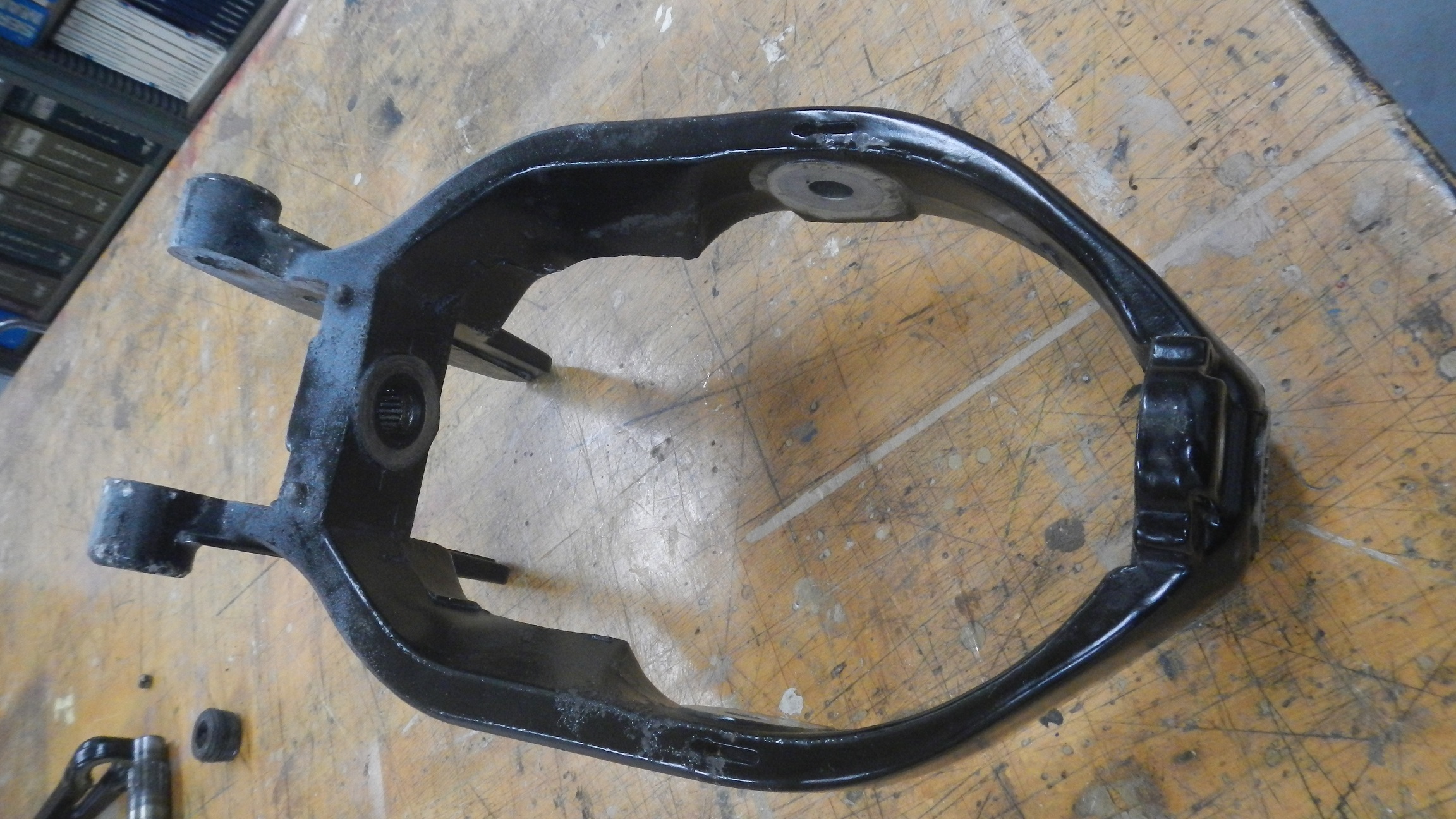

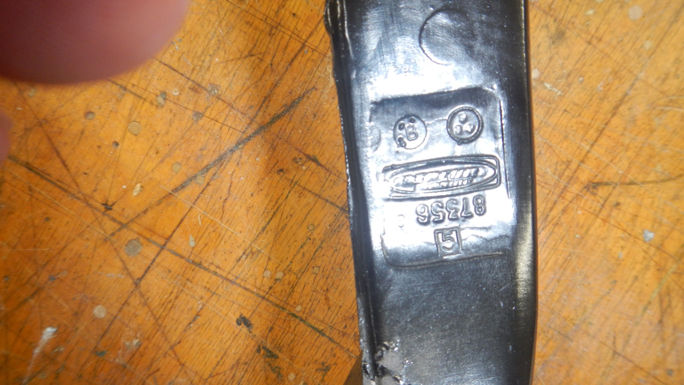

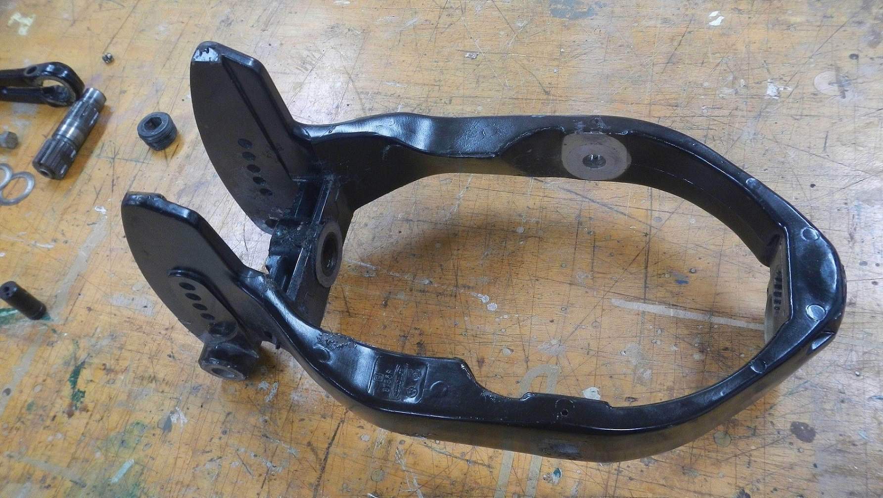

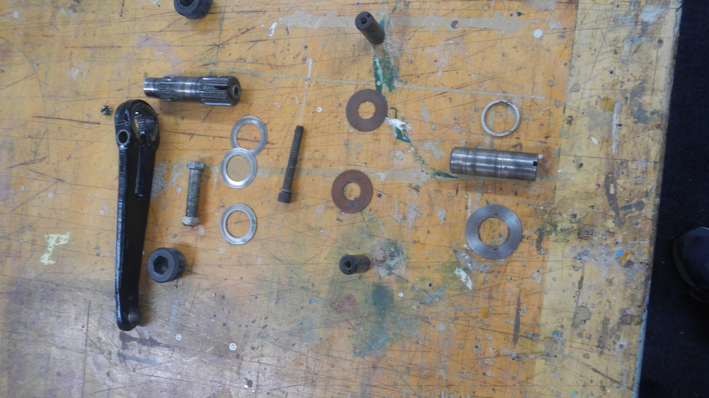

Here you go, from an early 1970 model. Notice the 5 trim pin holes drilled in the thrust support flanges. Later production ones were not drilled. Original part number 45515A2 supersedes to 87356A1, so I guess it is newer than the boat it came off of.

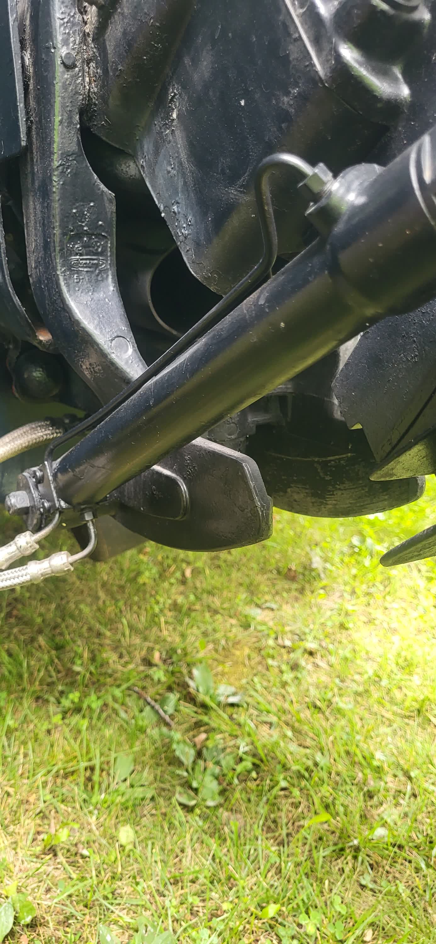

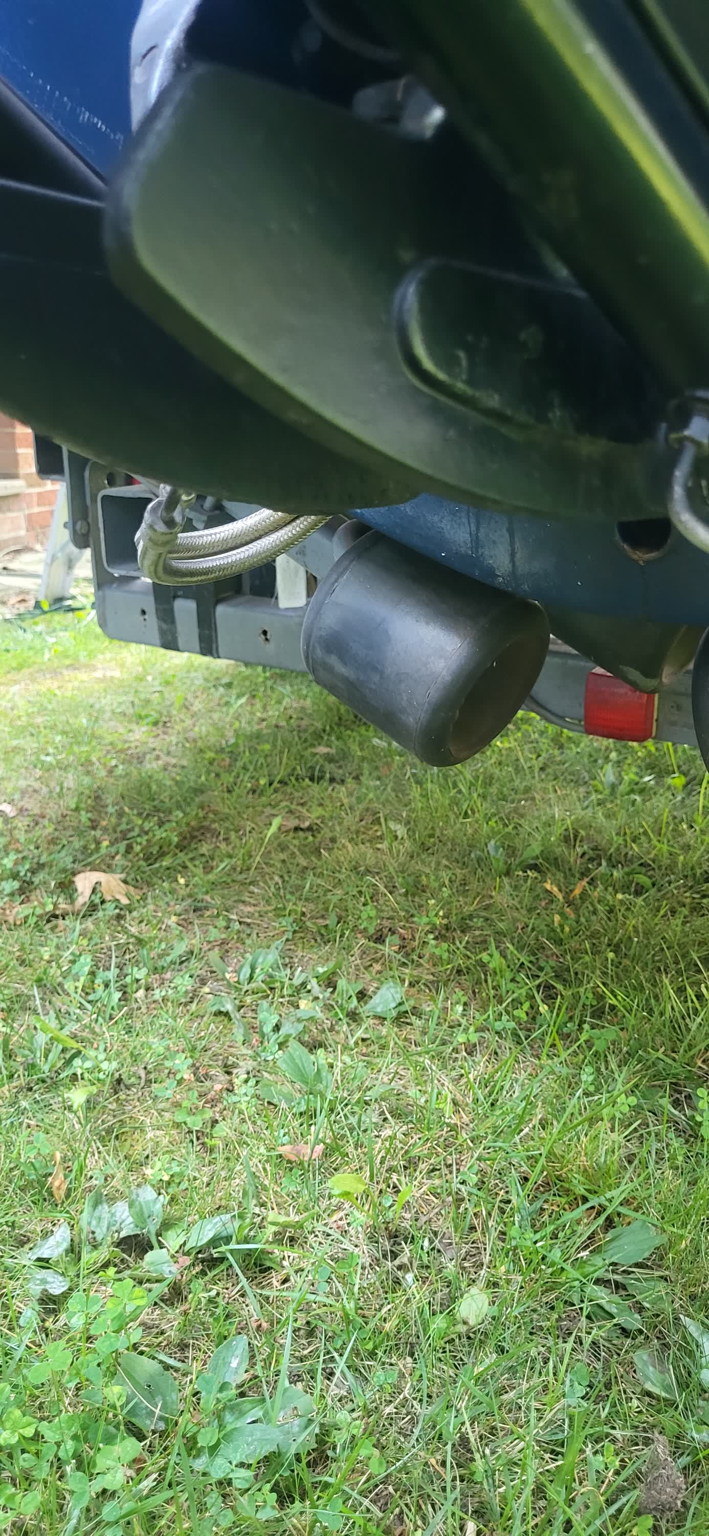

My gimbal doesn't have all the pin holes on the bottom shoe?

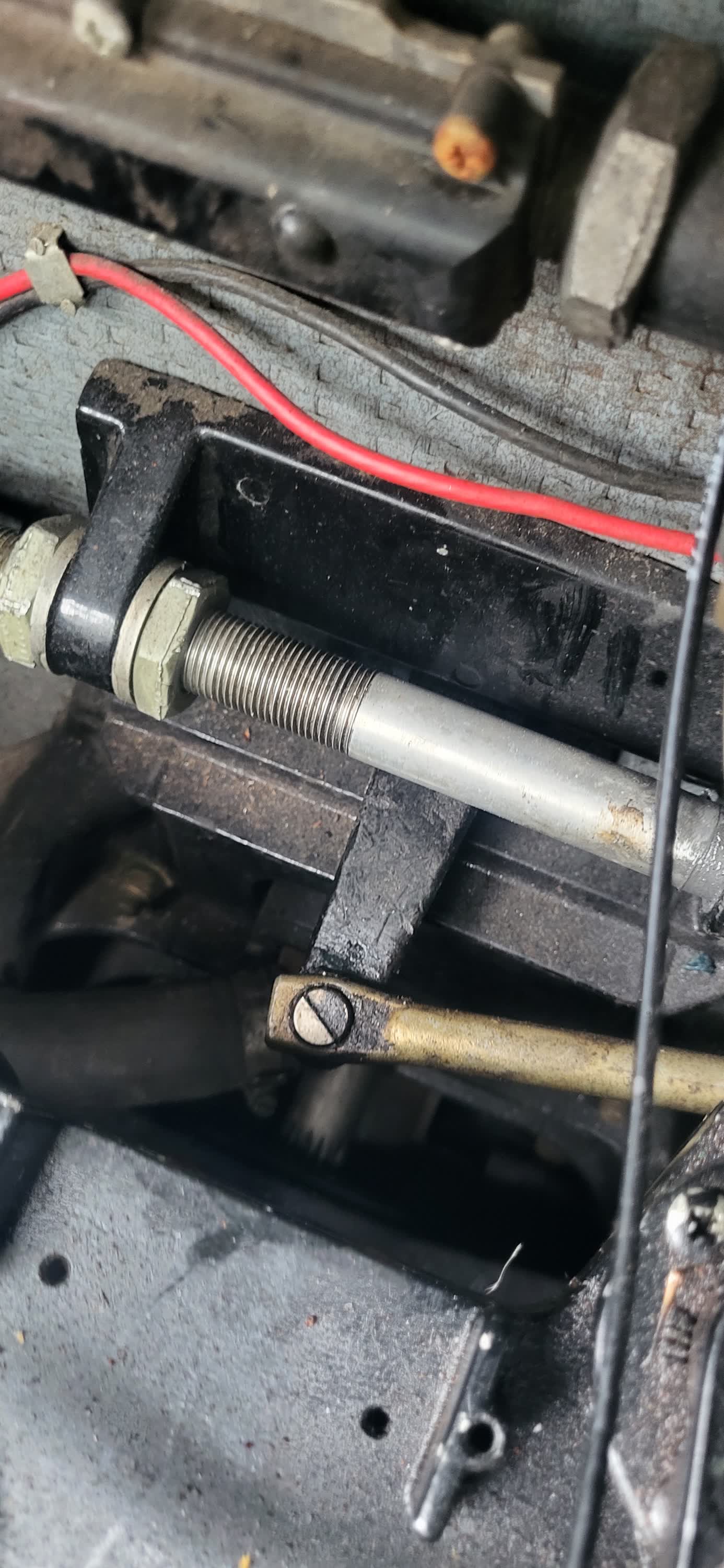

I'm looking at your new pictures (shows right hand trim cylinder).
I see someone has retro-fitted a later cylinder on. It is installed upside down, hydraulic lines should not point down. Among the obvious that they are damn near below the bottom of the boat, how will they bleed properly with the fittings on the bottom?
Thanks for that info,i will flip them over
