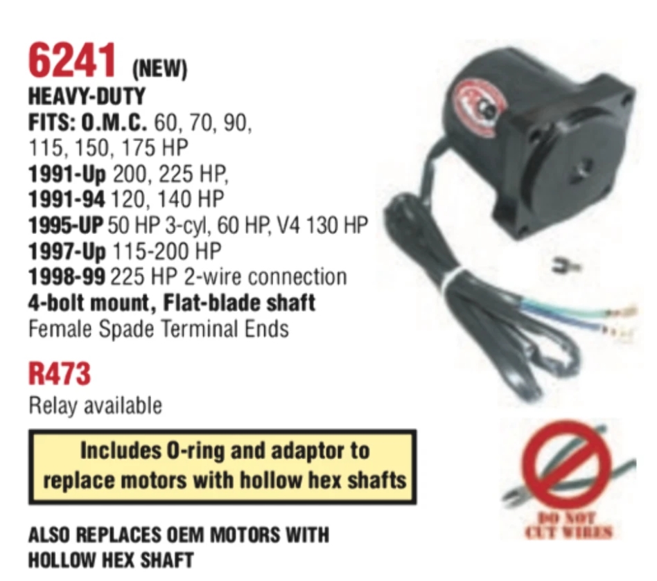

Get a new motor Arco or chinesium with new oring. Don't forget to top off fluid in pump housing when switching motors.

got the motor and still not working. What I did discover was that the blue and green wires coming from the PDP over to the plug in for the tt motor pig tail shows 11.75 volts on the blue and 12+ volts to the green wire, but when I plug in the tt wires to the connector and test voltage the green stays at 12+ volts but the red shows 0 volts, what would cause this? is there a trim actuator that could be causing this?
I meant blue wire shows 0 voltage when the tt pig tail wires are plugged in. Also I can connect direct 12v to the tt motor and it will run up and down like it should
