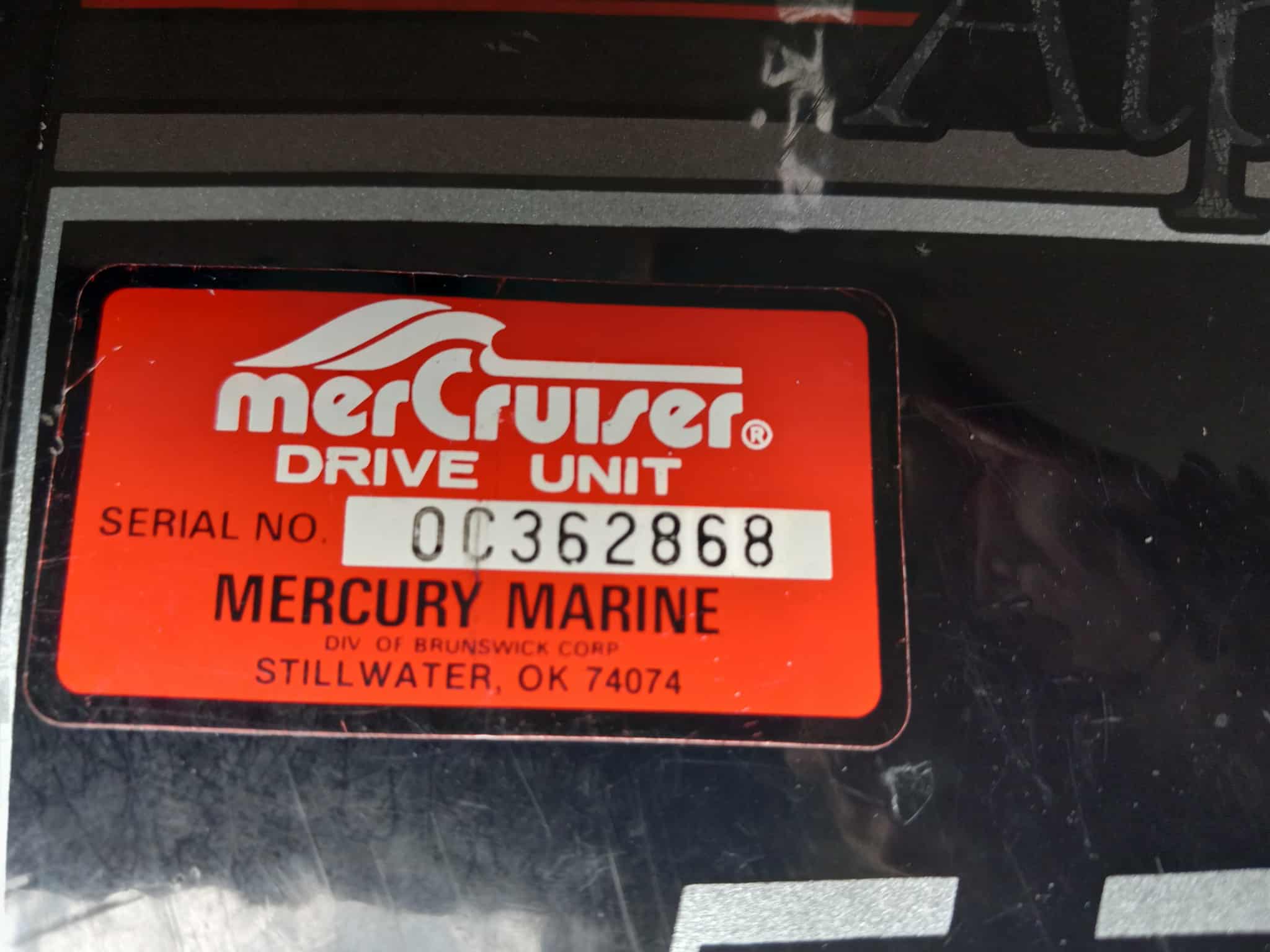

Hi. Can someone tell me if this is a Gen 1 or Gen 2 Alpha outdrive?

That is what the book says. There was a brief period of time where a "R" unit was built. It's guts were like that of the '82 & earlier but externally it looked like an "MR"/Alpha gen1.
What year is the boat?

It's an 88 Carlson Glastron CV 23, with a 5.7 carbed motor
1988- Alpha One Gen 1
OC prefix also fits.
MR (earlier) and Alpha are 100% identical with the exception of the lower unit vertical drive shaft. MR has an oring grove near splines at top.
R drive (prior to MR) had a few differences including the way the lower unit vertical drive shaft bearing was installed, the opposite of the MR and Alpha.

Mercruiser was so kind as to lump all 3 drives together. Need to see the top of the driveshaft to determine what is inside.

Based on the year of the boat 1988. It ia impossible the drive could be an R drive.
Unless someone installed an older drive on a newer boat

My research showed Serial number match boat year of 1988
ALPHA ONE GEN 1.
NOT MR and NOT R
I put the S/N in the search for parts catalog & that is what it showed.
Regardless, 88 boat is Alpha. He has the correct kit coming.
