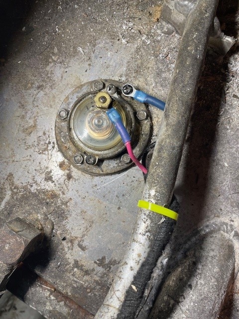

Got the buzzer in ! Still need to replace the switches. Then one more driveway run on the muffs and we will be cleared to the Lake!!
Okay typical brick wall again. Removed and installed the temp switch no problems, except I have to attach a spade connector. No worries there I have them.

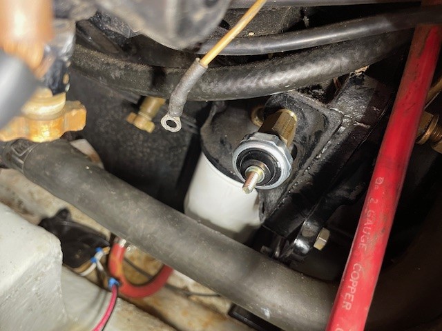

Moved on to the oil switch. It has a 3in. brass threaded adapter. Pipe threads to the block above the oil filter, female threads for the switch. I removed the adapter with oil switch attached, replaced the switch with new one. Went to screw the adapter assy into the block and NO GO!
Its not hard to reach fairly in the open but down on left side behind exhaust manifold. No matter how hard I tried making sure the angle was as straight as possible it would not start. So, okay jump back out of boat get my pipe thread tap and dies out. Run the die down onto the adapter threads frontwards then turned it backwards and it threaded on just fine. Maybe cleaned up starting threads a tiny bit. Tried again almost started all by hand. Go to put wrench on it and NO GO. Pops right off. So, attempted to try the Tap and Whoa will not fit like as if its slightly too big.
Did Mercruiser use metric threads on the blocks? I dug out a pitch gauge and 1.5 matches up with the adapter end threads perfectly.

That is how I usually think. The block hole is 1/2x13. I cleaned the hole up with a brass .50 Cal brush. Then ran a 1/2x13 tap all by hand and it went in very easily. Looking at the adapter that I removed, the threads on it are cut flat at the starting threads. Tells me someone forced it. I tried a pipe thread tap NPT 18 and it will not fit the hole but matches up with the old adpater threads.
Okay I think I figgerd it out. NPT 1/8-27 is real close to 1/2X13. I have a 3 piece NPT Tap & Die set but not the 1/8-27. So, as soon as I get one in the next day or two I will try that and see. One of those things us cursed mechanics buy, use 1 time and never again. Then years from now someone needs one and then you can't find it.
If you put a 1/2"-13 tap in the hole, no point in trying a 1/8" NPT tap...better off with a heili-coil ...
Well it did go in kinda way too easy. New tap will be here tonight. I will see if it will work. I dont think a heli coil will work and still be able to use NPT threaded adapter. If the hole had a bottom and not pass thru then maybe. There is a company that makes custom adapters McMaster-Carr.
Ever hear about them? Shows a list of threaded adapters with different threads on each end. Around $15. Might need to go that route.
Got the new NPT 1/8-27. Its the size of the switch threads. I'll add it to the set of 3 I had. More research needed. Not too familiar with NPT sizes. Have full sets of SAE and Metric. Don't usually have a call for NPT much.
Okay, Here is what I've found: 1/2-13 = .421, and 1/4-18 NPT = .421. That's why 1/2-13 went in so easy. Only a few threads. So I need a 1/4-18 Tap to try and clean up the starter threads. And a die to do the same to the adapter.
Hopefully I do not have to drill it up to the next size. .....what a PITA.
I have a bad feeling that someone forced the NPT adapter into the Chevy block that had regular SAE NC threads.

NPT is pipe thread. It's tapered and pipes are measured by inside diameter, not outside like a bolt. So 1/8 NPT is a tapered fine thread similar to 1/4-28 bolt at a glance.
1/4 NPT is tapered course thread, similar to a 1/2-13 bolt at a glance.
Your oil pressure is most likely 1/8 NPT and the temp most likely 1/4 NPT.

BTW, 1/2-13 bolt is 1/2" diameter. The .421 is the hole size drilled before the tap is used to cut the female threads, not what you measure the bolt shank as with a caliper or micrometer.

Sorry for the confusion; what I meant by starter threads are the first few threads of the hole.
The hole in the block above the oil filter is .421 <a bit bigger of course after it was tapped with threads from the manufacturer.>

I have ordered a NPT 1/4-18 Tap in hopes of repairing the original hole threads.(In the block).
The Oil switch (that detects 5psi and sends a ground to the warning circuit) , is attached to the adapter on one end (1/8 NPT female threads) and to the block on the other (1/4-18 NPT male threads). Which is where I'm having the problem. The adapter refuses to thread back into the hole in the block above the oil filter. It came out of there by all means it should just screw right back in!!!! I can reach it very easily no problems feeling it begin to screw into the threads. It just dont wanna. Part of me wants to break out a brass hammer and beat it as I turn it.
The Temperature switch (That detects over 200 Deg F, then sends a ground to the warning circuit) Is installed no problem.
