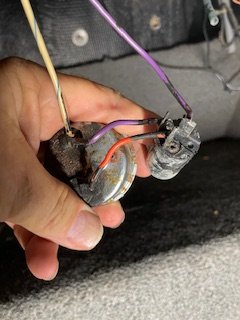

Jumpered 12v to buzzer and it works. Key ON, purple wire to relay getting power from ign switch. No joy. Slid relay out of holder and gently tapped and still no joy. It should beep after 7-12 second delay AFTER turning key off back to ON. Correct? For initial switch on test?
Looking at the kit they sell here. Comes with buzzer and new sensors. I will search down to see if I can find a replacement relay first. I think I can but it wont be a round one.
I removed the relay by using a soldering gun so the connections were good. I want to test it to make sure its bad before buying parts.
I've read where this relay has a 30 second delay. So with a ground to where the short purple wire was and 12v to where the other longer purple wire was connected to the ignition switch, 30 seconds later I should have 12v to where the red wire was attached.
Sound about right?
I would say YES, provided there is continuity between the TAN/BLUE and short PUR wires connected to the horn.
I'd also verify the horn works while it is isolated from the relay.

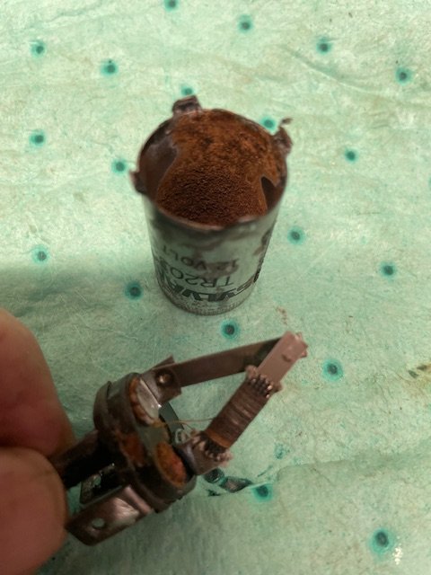

Has little strip bars on each arm that touch. Ironically those were not rusted. I wanted to try and clean where the wire touches the through rivet.
I bumped the tiny wire and it separated from the rivet. No saving this one. The heating coil looked burnt but it may have just been that way from operating. It was cool to see anyway. The top had black sealant like it was dipped to try and keep moisture out. Lasted long enough I reckon.
