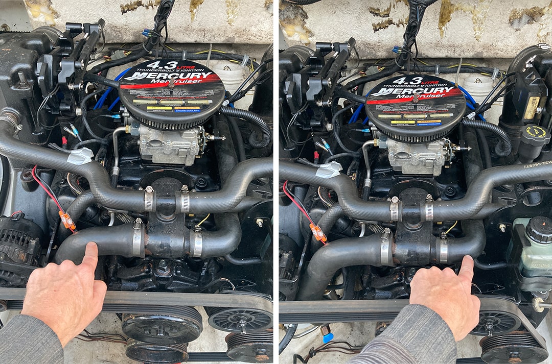

Hi,
Just a quick one I hope. I managed to get the engine running yesterday thanks to the help from this forum and wanted to double check the temperature of the water pipes (simply hot and cold) and if mine is normal.
The boat is new to me and i've not had an sterndrive before. After a few minutes on the water hookup the lower left pipe was quite hot, the lower right pipe was cool. The two above both felt warm and of even temperature. I presume the cold water is coming in on the right, runs around the engine and out out through the left and this is normal, but just encase, I wanted to double check before taking it for a full water test. Thanks
Ignore the wago blocks (temprorary repairs) and gaffa tape (used for mental note).

Water comes in from transom connection so that hose should always be cool/cold.
The cold water then goes thru the two top small hoses to keep elbows and exhaust cool so rubber boots dont melt and other things down stream. It also flows into large hose on left and gets circulated into engine. Most of the water going into engine stays in engine until thermostat opens. Once opened then engine temp water flows to bottom of exhaust manifolds and mixes with colder water at elbows and out down tubes.

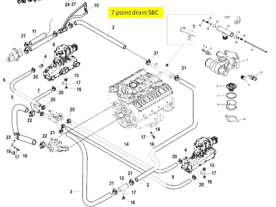

The pic below is for a SBC but is same for yours, except this shows the Bravo belt driven water pump
As kghost mentioned, lower right comes from drive
Lower left is the recirculating hose which keeps water going in and out thru the block. It's normal for the recirculating hose to always be hot because only when the thermostat opens does any cool water inter the block thru water pump on front of motor
The 2 smaller ports below the ones in the Tee fitting sends raw water to the bottom of each manifold
The 2 top ports have check balls in them and they go to elbows. Only when there is to much water does the water pass thru the check ball ports
What year is that diagram for?

I realize you are refering to the photos you have posted regarding left & right hoses.
Just a reminder to all.....
If buying parts or talking to a mechanic, true left and right is as if looking forward.
So in the left hand picture he is pointing to the right hand hose and visa versa.
Not able to find it right now, it's not in any of my manuals, I found it looking most likely at Mercruiserparts trying to find other info and I saved it. It always helps trying to find parts if the OP list the serial number

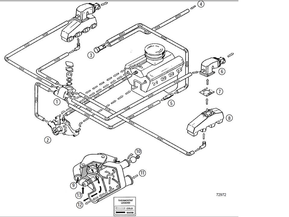

yes what you outline is all normal. the cold hose you point to is the water in hose bring water up from outdrive and transom - will always be the cold. the one on the left that is hot is the recirculation hose for the block - it willbe cold on inital start and once engine gets hot it will be warm.
the two small hoses on top of your thermostat feed cold water to the exhaust elbows before the thermostat opens -they will be relatively cool. when the thermostat opens warm water is let out of the block and feeds the hoses going to bottom of the exhaust manifolds those will be hot.
your engine should have a 160F thermostat, should show about 17--175 on the temp gauge, cooler in the spring and fall when water temps are colder
there is an over temp alarm , which is the same annoying buzzer that goes off briefly at start up. Over temp, low oil pressure, and low drive lube will trigger this. If that goes off while unbder way shut engine off immediately and figure out what's going on
Thanks @AllDodge for the additional diagram and @Dieter for the written explanation, that doubly put's my mind at ease. I'm hoping to water test the boat this week and will keep a close eye on the gauges. I recently found the alarm buzzer under the dash had been disconnected by one of the previous owners, but I have reconnected it now.
